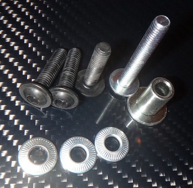

today, got a large parcel with goodies from my favourite shop PI in Glendale, see pics ~ hope this helps....
