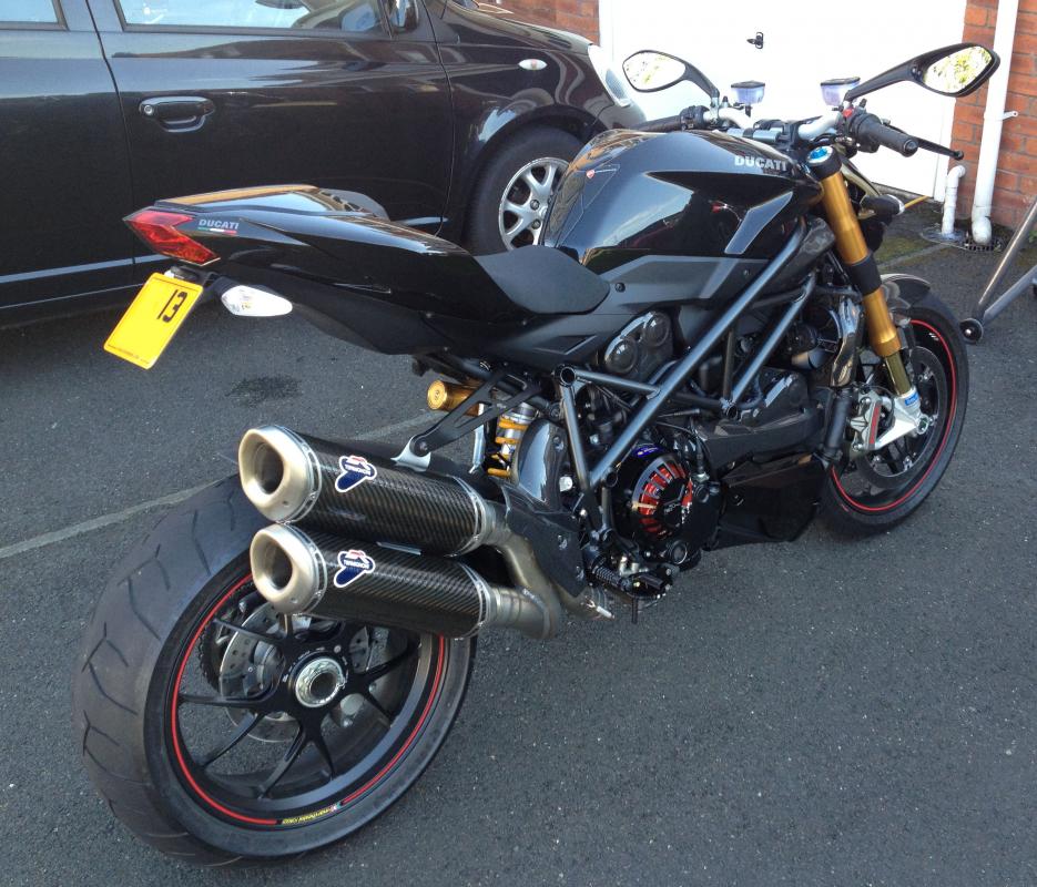

  2. I've fitted the DP tail tidy and an Evotech exhaust hangar.
    Both of them were fiddly in the extreme.
    The tail tidy requires you to fit all of the numberplate and indicator wiring into a very small space along with some spacers that come with the kit. It took me a few hours to get everything in there.
    The exhaust hangars are held on with 3 allen bolts, some of which you can only get about 1/16 of a turn on at a time. I got the impression that the original rear foot rests were the 1st thing fitted to the bike in the factory and everything else was fitted afterwards. :tongue:
    Tho only advice I could give really is to be patient and put a couple of hours aside for each of these jobs. You'll be fine without a manual.
  3. Cheers for that mate. That is one nice looking bike you have there! :smile:
  4. Cheers Dave :upyeah:
