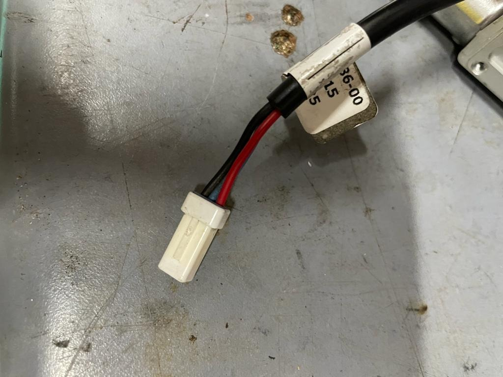

Measured resistance. Its 2k or more accurately 1.998k. Can anyone tell me where to find those 3 pin white plastic male connectors? What they called? Ta.
Not sure what connector you’re after……but I’ve used this place loads in the past and have never failed to find what I wanted (yes the name sounds proper dodgey but it’s legit): https://www.easternbeaver.com/Main/Elec__Products/Connectors/connectors.html Not super cheap obviously, but if you can’t find it elsewhere it’s a reliable option
Are these the jobbies? https://www.ebay.co.uk/itm/17577046...ehQoKf3bkroxuyqN5utDXmDVxAFdcpdsaAvKxEALw_wcB

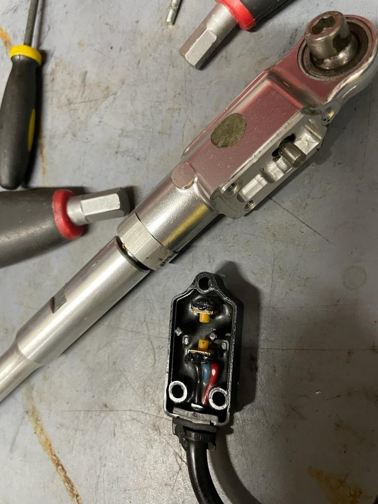

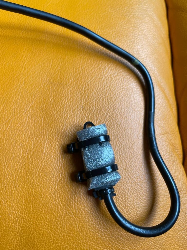

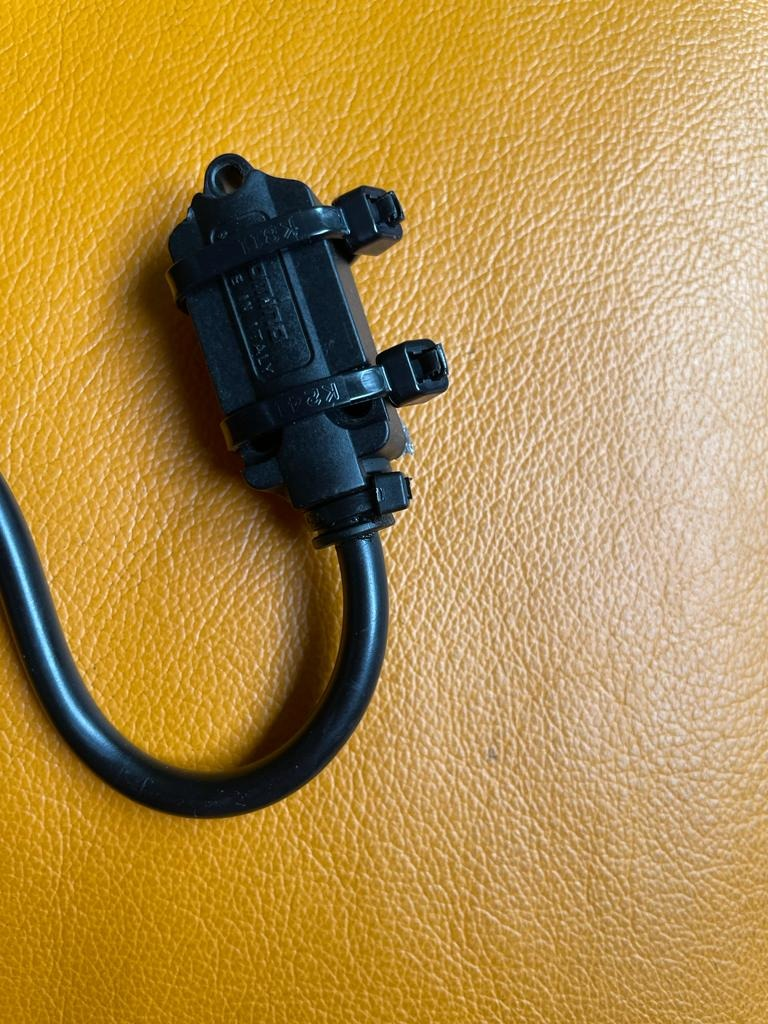

I agree Andy. There should be something provided. Ive ordered the parts and will make my own. I am also telling them what I did and will say they should provide. In the meantime I will leave switch on the bike. See my heath robinson...
