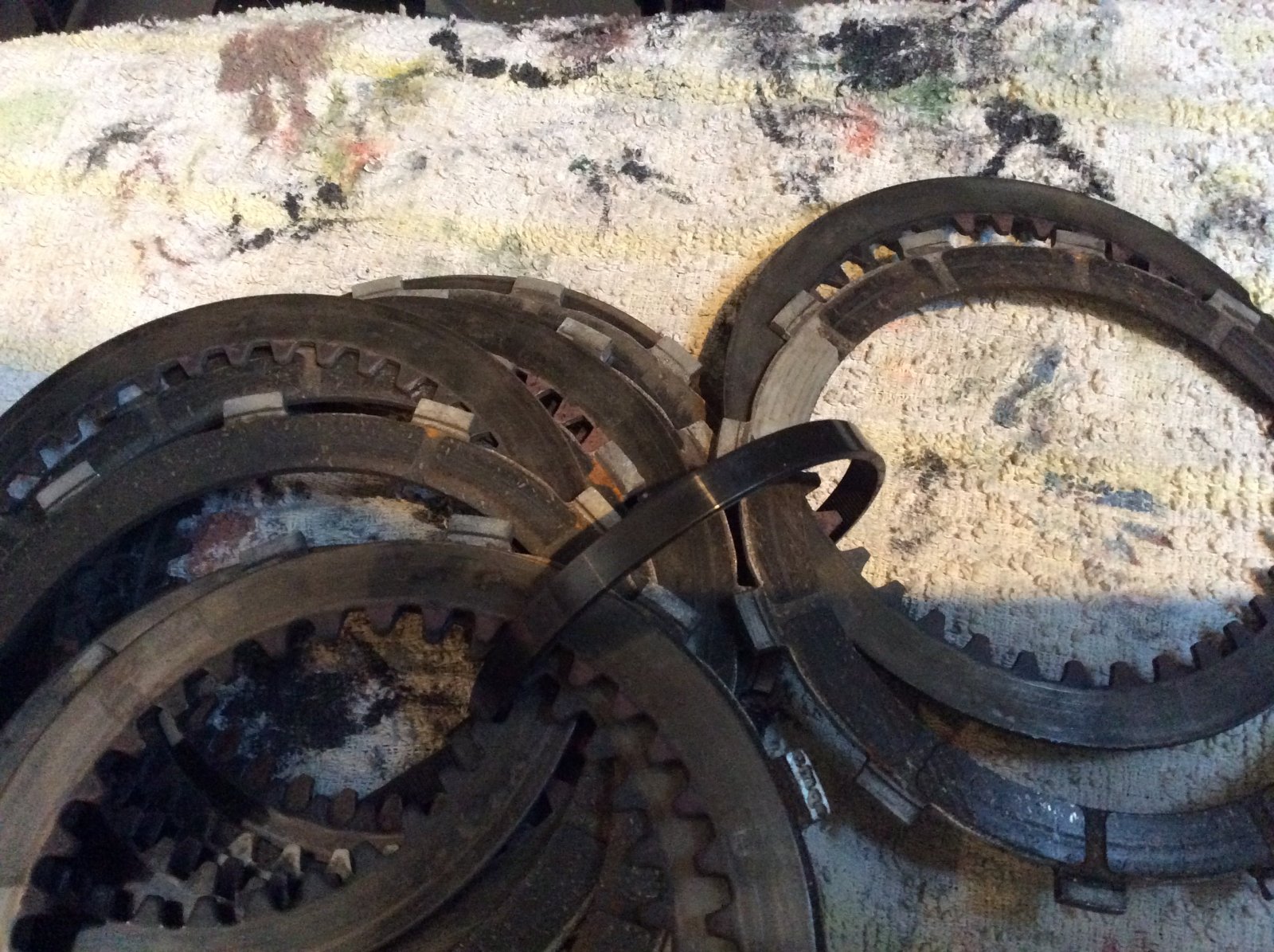

  3. Great I'll pull the plates out tonight to see what sort of coverage I have what thickness should I be looking at an the plates and what are a good plate to fit

  5. No need the plates are pooped
  7. If you are using the standard Clutch master cylinder then I always bleed the master cylinder if I have clutch drag or disengagement issues, as this is bit of a weak point on the bikes. but on the positive side, all you need is a 6mm spanner and a Philips screwdriver and it takes 2 mins.
    but those plates don't look the best..
