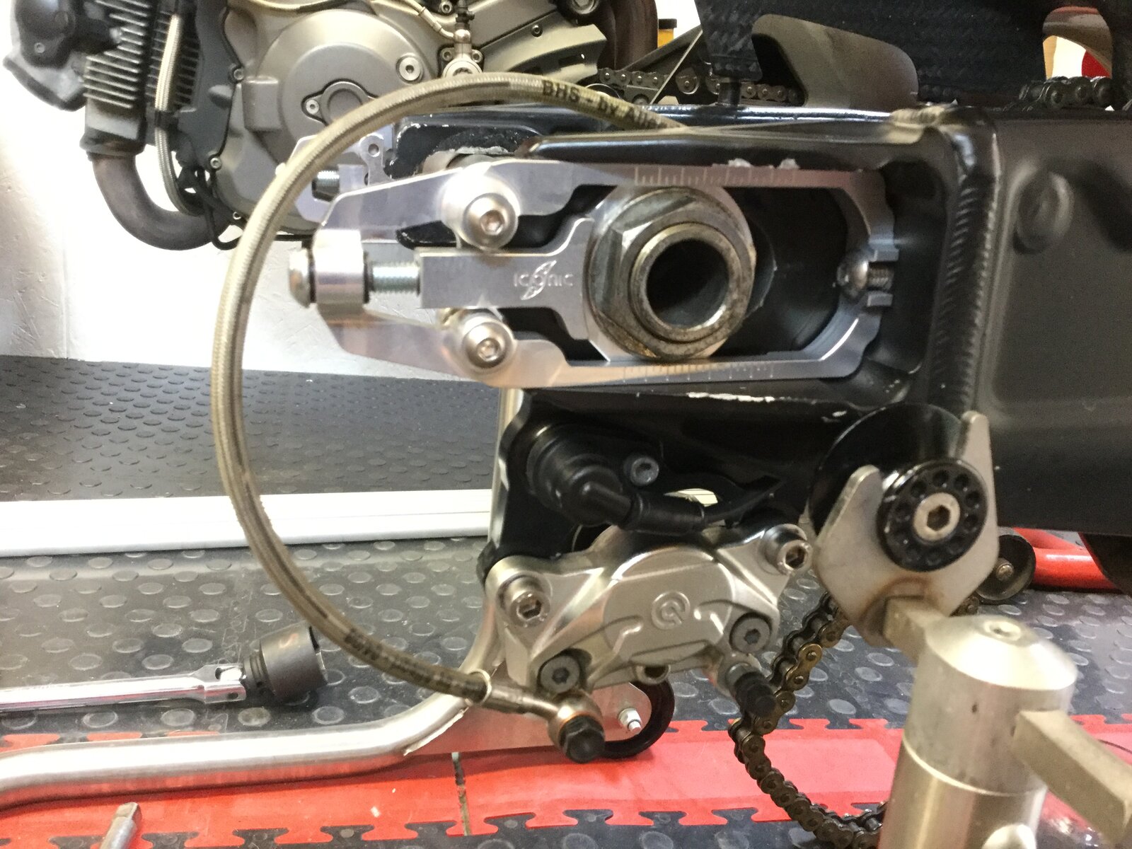

Here’s mine. I happened to find a bit of brake hose lying around so just chucked that on for the moment.
I bought it cheap on eBay many years ago - it is a Riders Bridgewater part. It had knackered threads on it so I repaired them with a helicoil kit. Does the job nicely.
I would just sent Dragos a short message via Facebook and just ask him about the correct length of the brake hose. He is a very nice guy and very responsive and he also offers a complete kit now: the hanger plus the brake hose. I am sure he can tell you about the length and the fittings that work best: https://www.facebook.com/panaitiu Andreas
