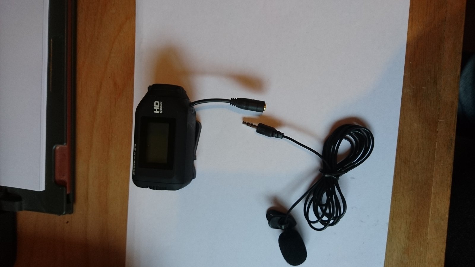

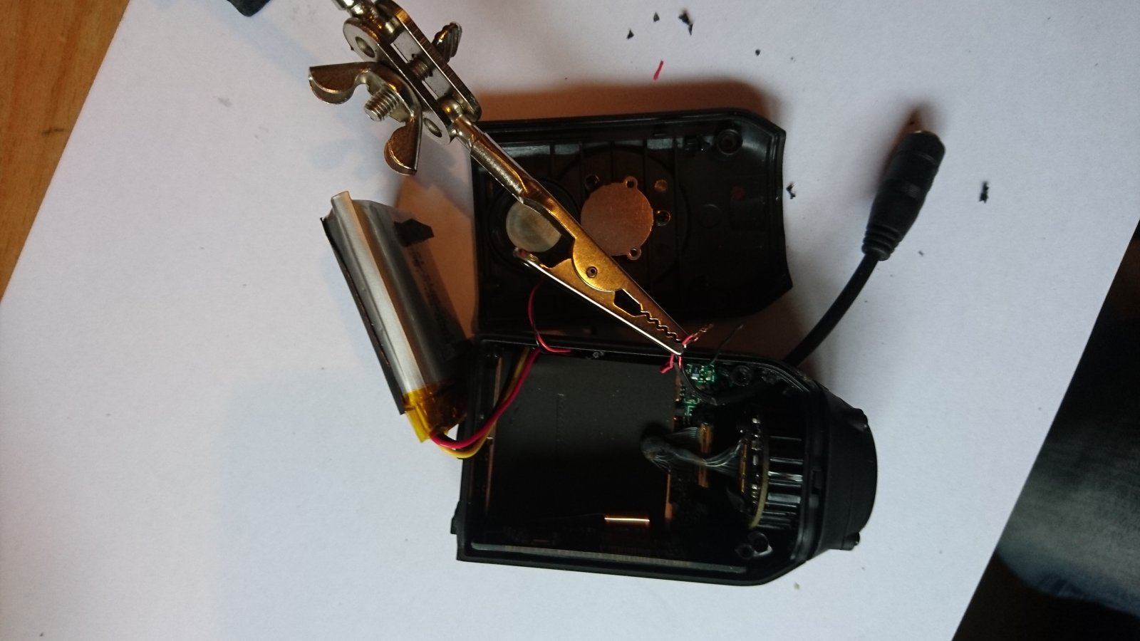

  1. Having recently purchased a Stealth 2 action camera for the bike, I was very impressed with the video footage but shocked at the poor sound (wind noise) it was terrible, as this model only has an internal microphone I tried a piece of sellotape over the mic to try and help but that only muffled the noise, so after a Google search I found a vid of a bloke fitting a pigtail so an external mic could be fitted, any tampering obviously voids the warranty but as mine was a second hand Stealth I thought what the hell, after getting the bits needed to do this conversion it took about half an hour to do and the results are amassing, total cost £2-50 including the external mic and lead.
    Steve

  4. Ive got one, This is spot on info, Think I will give it a go, Don't suppose you have a link for that exact mic and pig tail?? Cheers
  5. http://www.ebay.co.uk/itm/UK-3-5mm-Female-Socket-to-2-5mm-Mini-Jack-Headphone-Earphone-Converter-Adaptor/131141740886?ssPageName=STRK:MEBIDX:IT&_trksid=p2057872.m2749.l2649 This is the pigtail I used, just cut the 2.5mm end off.
    And this http://www.ebay.co.uk/itm/3-5mm-Stereo-Active-Cam-Tie-Clip-On-External-Mic-Microphone-for-GoPro-3-4-Sj4000/311572799706?ssPageName=STRK:MEBIDX:IT&_trksid=p2057872.m2749.l2649 is the mic I purchased from China, i,m shure thare are others though.
    A link to the video on you tube.
    I used a small piece of heat shrink to insulate the soldered wires inside the camera.
    And don't use an electric drill, just a drill bit and twist with your fingers.
    Steve
