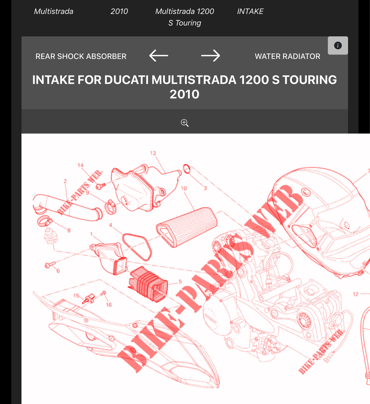

  13. I’m not sure but it may be the Air Temp Sensor(may already have been mentioned, MAF sensor?) but as I recall on my 2011 model, this is the sensor, which controls the motor fuel on start up. Effectively, an auto choke, running the engine quite rich.
    If this is faulty it will run the engine rich constantly.
    Additionally, make sure it hasn’t got disconnected nor the tube connected hasn’t been crushed, blocked etc.
    Is your exhaust tip quite sooty?
    If so, this could be your issue.
    As I recall it’s situated inside the nose of the bike.

  14. D50E5631-C9DA-4D89-A718-29D9FEBDCB50.jpeg BE8686B2-8A65-4488-8D0C-564B3488EE85.jpeg
    Item 15 is the Air Temp Sensor. The sensor I’m talking about.
