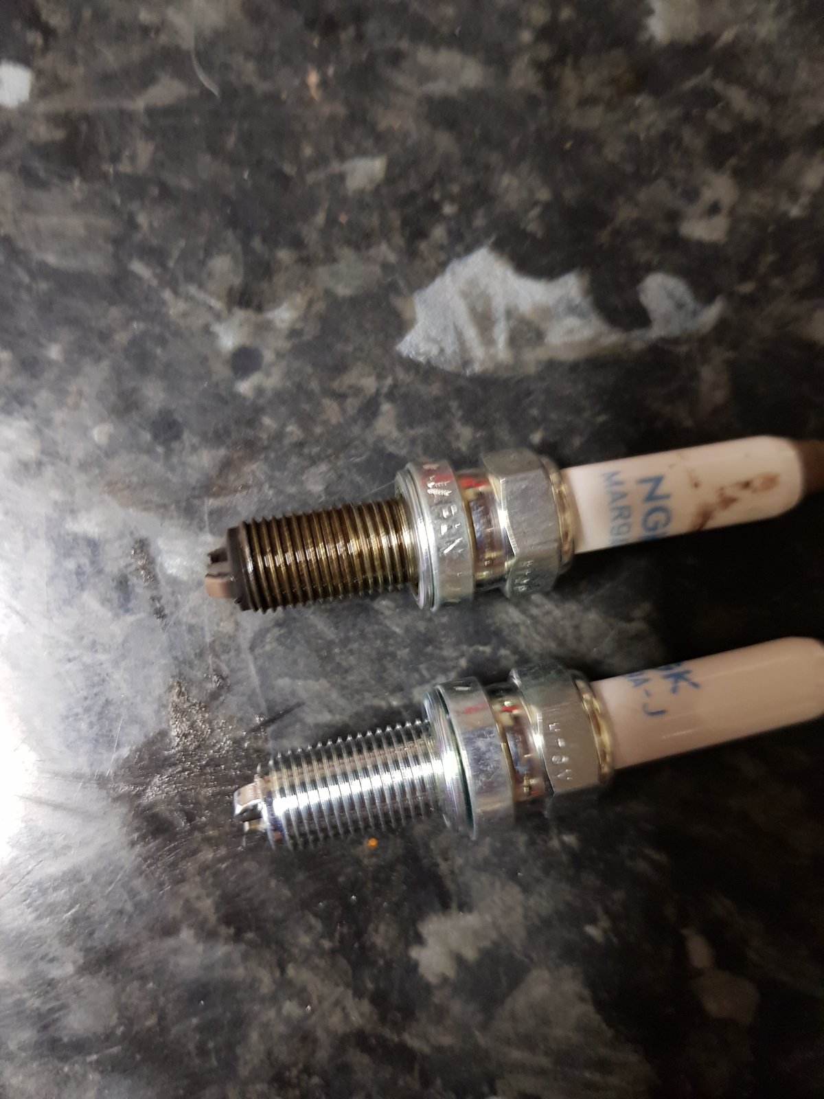

  1. Anyone had any experience of the 899 dropping to 1 cylinder at idle? my bike is a 2014 899 with 4.5k kiles on the clock.
    So she starts normally and allows me to ride away from home. Then when she warms up she really struggles to idle if I stop at a set of traffic lights. Drops to 1 cylinder but doesnt stall, lights green and i set off on 1 cylinder, really bogs down and then at about 3-4krpm the other cylinder kicks back in and runs normally.
    Gonna have a look at her this weekend just wondered if anyone had any similar experience.
    Cheers.
  2. plug or coil stick isolate and find which one
  3. Plug would be my guess/starting point.
    Pani uses separate coils, not sticks...:upyeah:
  4. Was shot plugs on my bike, changed them and the problem was solved.
  5. Go iridium??
  6. I couldn’t find any... I even posted asking about it here and on reddit, but got no meaningful info.
  7. Thanks for all the replies. I'll start with the plugs and report back
  8. Did you try the NGK website??
  9. Well not the easiest pair of plugs to change but changed them non the less and she is running perfectly now. Thanks to everyone who commented.
