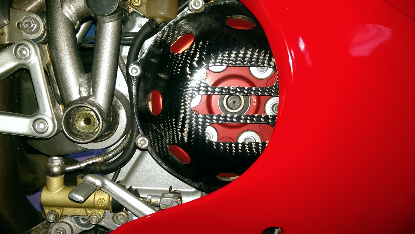

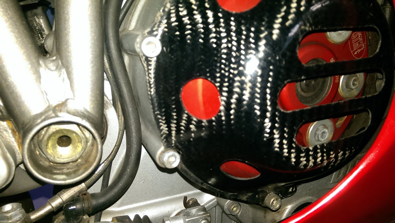

  10. First of all you need to know what it is you have as there are several different items. Do a piccie. If you still have the original silver clutch cover then you can take this off to reveal most of it. Be aware you dont need to take out what appear to be all the screws holding this on only certain ones that go back in the same place as they are different lengths.

  11. Here you go. I know it's not OEM, not had a chance to get in there yet.
  12. Take the pressure plate off. If it has teeth on the back of it, it is a standard clutch. No teeth means its a slipper.

  15. This might help you
  16. First impressions looking at them pictures I would say it's an STM slipper. The springs stand out much further on the standard preasure plate.
