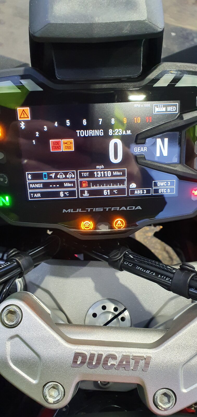

  1. On my ride to work yesterday, my bike's dashboard suddenly lit up like a Christmas tree and I got a DSS warning light, check engine light, empty gas tank light (even though she was full) and general warning light going on. Went to my dealer today and after a thorough check they told me that a motor in the rear suspension broke which caused all kinds of other errors going off. Unfortunately they also said I can't replace the individual motor but the way it's put together I need to replace the ENTIRE REAR SUSPENSION at GBP 2,000 plus labour :sob:
    Anybody ever had a similar issue / any recommendations?

  6. When my 2010 des lit up and I had some warning lights I purchased the ohlins mechatronic electronic suspension unit which cured the des light and faults it cost around £250 from Italy and I did not need the suspension unit or motor replacing as was first thought. I gambled and took the chance as I thought it was worth it for £250 pounds and it gave it the option of semi active suspension. Good luck

  14. Check the wiring to the rear shock, I seem to remember a friend on here having similar issues as you and the dealer found the wiring damaged.
    I believe the rear shock is on the can-bus circuit which could explain the multiple errors at the same time.

    Secondly I've got great news - my dealer made a goodwill claim with Ducati as the bike is in fantastic condition with relatively low mileage and (crucially) I was able to demonstrate it had always been serviced by official Ducati dealers. Got the call earlier that Ducati accepted and will send me the part for free :-D
    Still have to pay labour to replace it but genuinely very happy with the outcome / my dealer.
    Thanks again!
