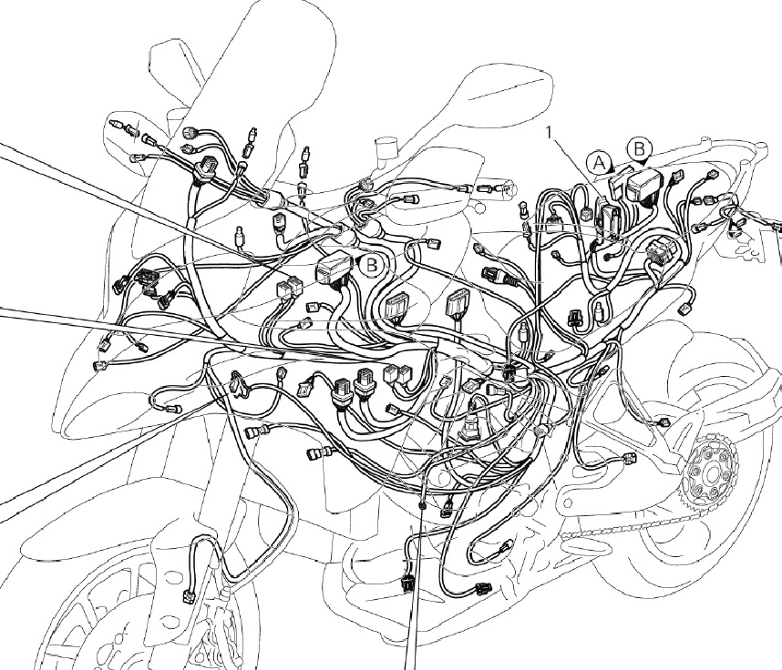

If someone could post a photo showing the whereabouts of the connector for the sensor cable that would be useful ;-)

Doubt you will see it buddy, mine went a few weeks ago on my 2013 GT and was replaced FOC by my dealer ....I knew where to look and there was no breaking I could see in the wires. the sensor is located in the housing on the top of the swing arm just above where the 2 bolts to remove the crud catcher are. The wire then feeds along the swingarm in a group of cables that run behind the rear brake cylinder reservoir then vanish behind the bodywork to the ECU. The replacement wire is slightly longer than the original and remedies the issue Bit late tonight but I will take a couple of pics tomorrow
