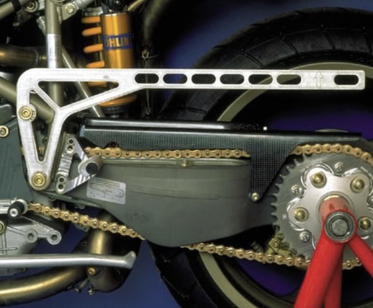

    If you own a Ducati (or any other brand/copy) 848/1098/1198 Ride Height Tool could you send me a dimensioned sketch of it please ?

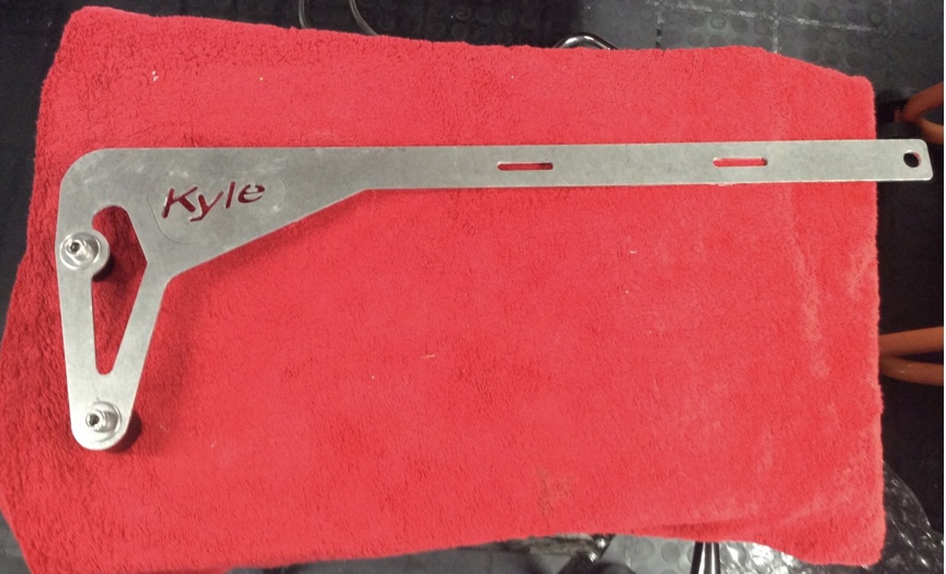

    Supplier in US is selling them for $150 but wants $80 delivery. It's a piece of laser/water cut 4mm steel - can't be that difficult to have a go at making one.
    It looks like the one in the pics.

  9. Bingo !! Any chance of the dimensions please Andyb? That means my pal will have 3 options; make, buy new from SES and acquire a used one from Chris. Many thx.

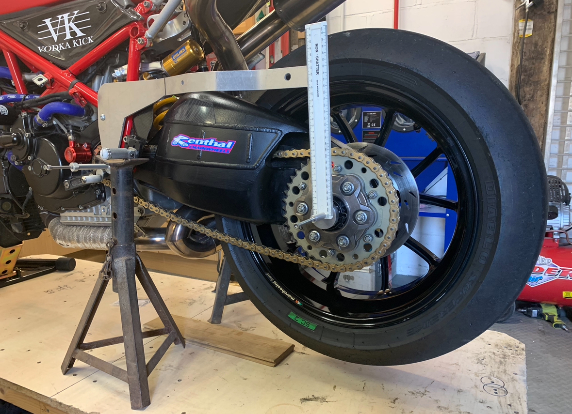

  10. The link to the 748 one will be the same measurements although I would make it longer as the1198 wheelbase is longer.
    you also need to turn the two pilot bungs for mounting the gauge and a mounting for the centre of the rear axle you can then add a metal ruler to it to be accurate
