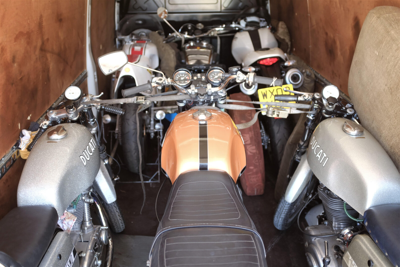

  13. Got 2x 350 desmo's and a 1 owner 750 GT coming tomorrow if it's of interest .
