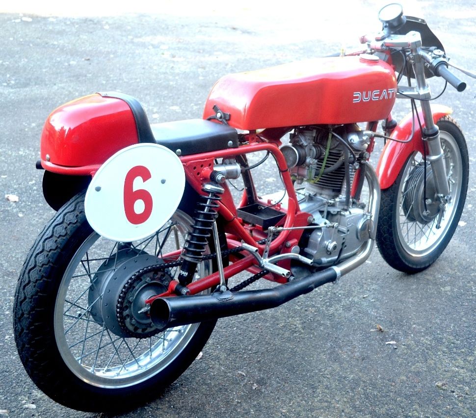

  1. I've been after a bevel Duc for eons, and while I desirously crave the twins they're expensive and cumbersome for what I want, which is a little town and country blatter that keeps me out of trouble. After all, I have a pani for serious stuff
    After stalking the usual sites I've picked up this little Ducati 350 Bevel from an eBay auction (oh god). She's originally from the US of A, part of a collection sold off after the owner passed on.
    It's been pulled around and needs love plus a fresh start. I'm planning fixing just the must do's and cosmetic spruce up for summer (here's hoping) then something more serious over winter (12v conversation, leccy ignition, full lights, stoving the frame, vapour cleaning the engine etc).
    There's a few nice period bits on her, Ceriani GP forks, Marzocchi shocks and yokes, Borrani rims, GT 750 front double twin shoe drum, stainless spokes, 32mm Delorto. The fuel tank needs replacing, brakes, lights and instruments also need installing or setting up.
    It's a bit of a change to my Pani.

  2. yip deffo a change to the panni. nice one :upyeah:
  3. That is lovely, good luck with the restore :upyeah:
  4. The engine alone is probably worth what it went for. I had a watch on that myself but wasn't brave enough.
    Good luck, cant wait to see and hear this.
  5. good basis for a cafe racer mate the cerianis do it for me,have a look on disco volante web site there is some nice parts on there.
  6. Looking forward to this, I also had an eye on it but too many toys in the garage at the moment. Some nice parts there already, I am especially liking the front drum :upyeah:
