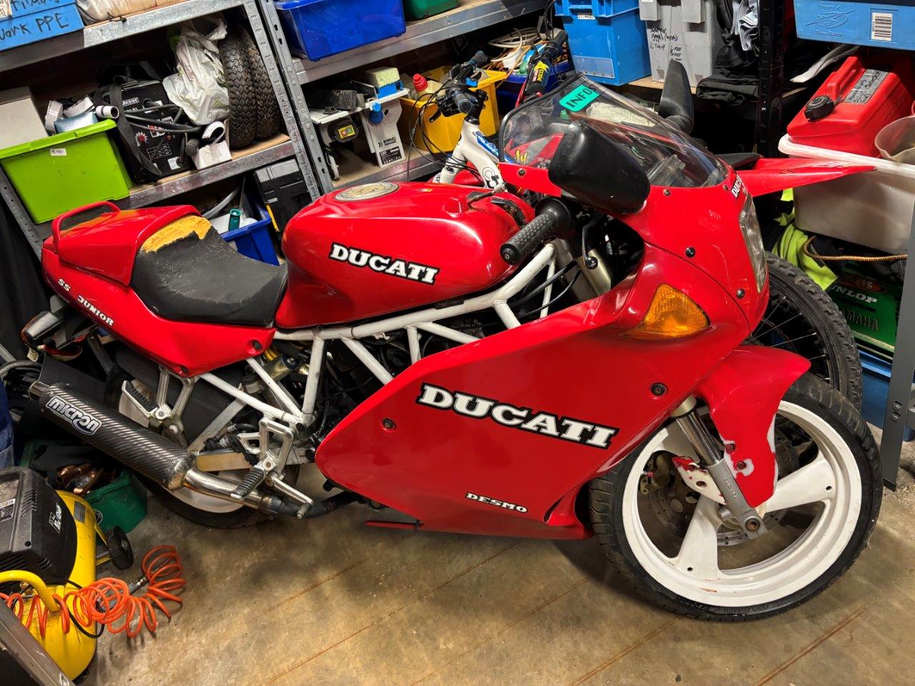

    I purchased a 400ss project recently...
    Currently im working through the (growing) list of jobs, but i cant wait to get it finished and ride it in spring!
    Will no doubt be posting to ask for help, advice, and maybe parts if needed.
    The biggest issue so-far is the tank, which is super-rusty inside. but im treating it with every chemical known to man, and its slowly working... patio cleaner was particularly good - but vinegar and bicarbonate of soda works slowly...
    Looks like all airbox and fuel hoses have perished... so im on the look-out for them...
    Seat is being recovered currently...
    Next bigger jobs are the belts and carb-clean...
    May need new exhausts, as the carbon has split on one... :-( Duc LR.jpg
    Excuse the state of the garage, i was in the middle of tidying when i bought the 400SS!

  6. Not yet... will start a project thread and add photos :)
