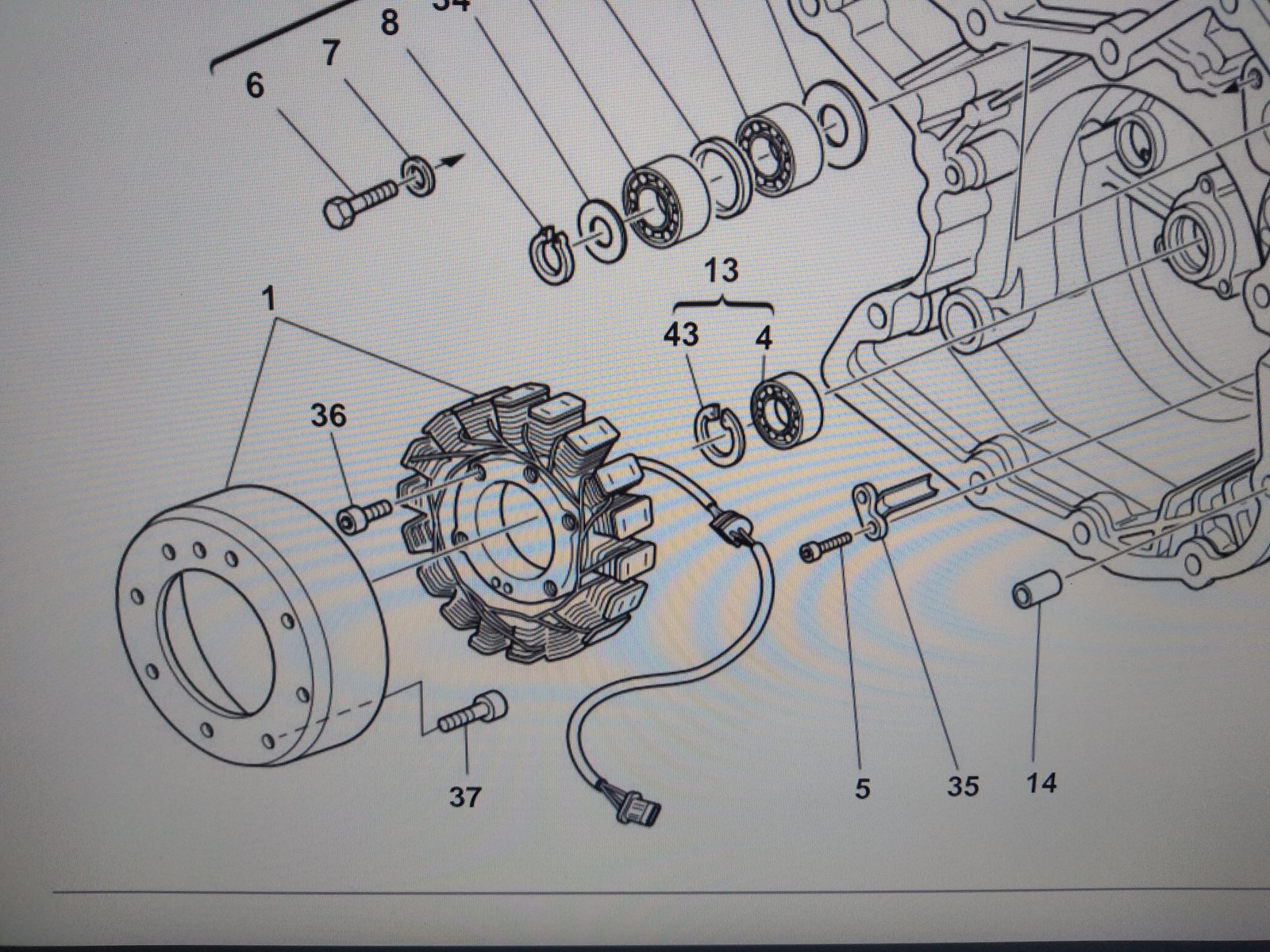

hi Per748 sent you a pm the key fits inside the 14 spoke magnetic stator r92 r93 type so that it has a drive and not held by the the crank shaft nut setting here is a r93 14 spoke type r92 is same but for the depth of the item some call them g92 g93 i think ducati call them Rs mike

By the way. The bike is a MY99 748 SPS. According to the Haynes manual it should have the 3 phase generator, but this is not the case. It has the single phase generator (2 yellow wires). I mentioned this for the Ducati dealer I have used for servicing, and he confirmed that the SPS's have the single phase generator. The rotor shown in the pics above seems to be the same as in the Haynes manual. I assume the rotor is the same for all 748/916 series of bikes With the single phase generator, or am I wrong ? What about the way Kaemna deal With the "lose alternator nut" problem ?
hello per748 yes 2 yellow wires 1 phase the 14 spoke wheel type magnetic rotor fitted then after 1999 ducati changed to high out put 3 phase some lads change to the two thin nuts, i buy a new nut and set to spec plus some thread lock and check every service on my st2 r92 r93 used across the ducati range inc many other makes used them as to how your ducati dealer service thats up to him the 14 spoke magnetic stator r93 narrow type r92 deep type i think i sent one to you via pm not to worry here it is mike
