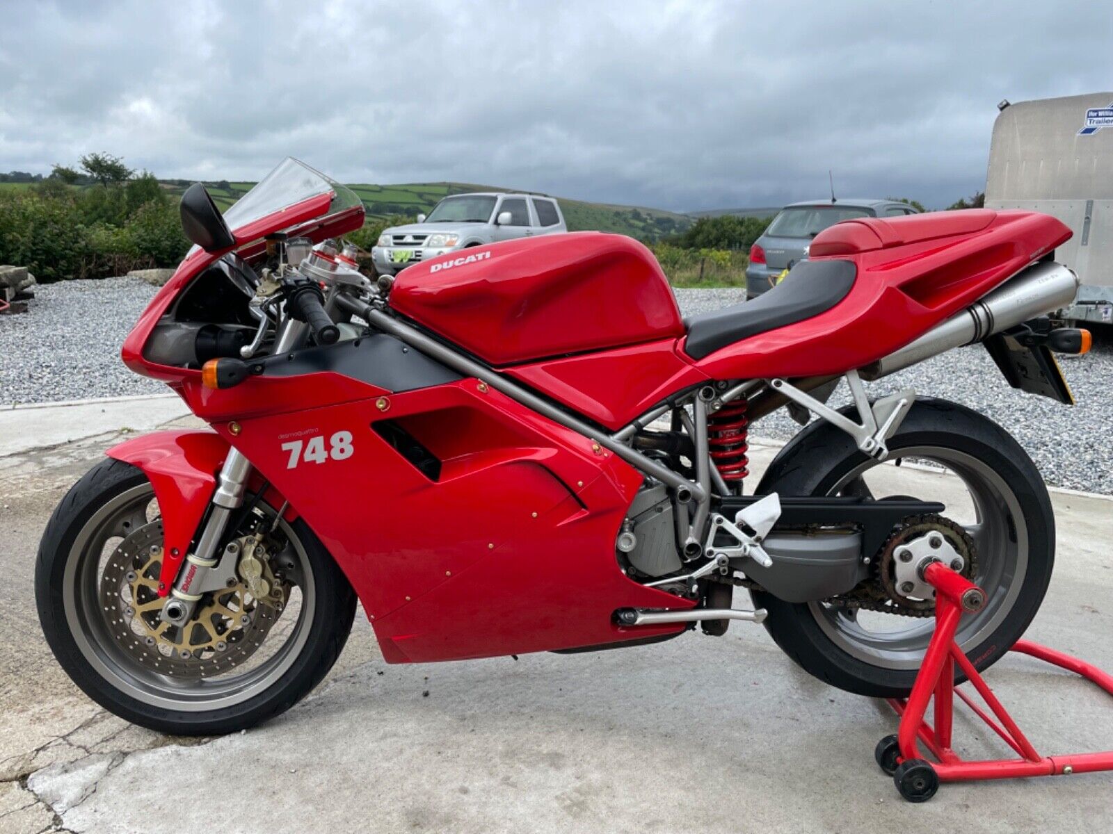

  1. Hello there British brothers long time no see i'm from italy 59 y.o. at last i bought back a ducati 748 in Britain that would mean that i will go to devon to pick up the bike and get back to Milan on her , actually i m here to asking you vaulable tips to face the trip without problems , the bike is in a good state of repair just moted without advisories but the journey is long enough for her , so my idea would be doing the DEVON -CALAIS in one shot than taking the ferry and pass the night at CALAIS , getting up early in the morning and face the long journey through France , switzerland and Italy , do you think the bike will endure such a trip ? what are your tips for me to have a secure and safely trip ?
    thanks to all

  2. Hi there Markie!
    #1 tip: make sure you have a good road assistance contract that will work internationally, and take care of you and the bike 24/7 should you get stranded somewhere along the road. The kind that will see you all the way back home WITH your recently acquired bike, and not dump it in a random unknown garage half way…
    As far as mechanics go, as the bike is new to you, you are going to find out if you are lucky or not. :thinkingface:
    Before any long road-trip, I would check:
    - Decent tires (age, shape, pressure)
    - Break pads, front and back
    - Chain, correctly adjusted, cleaned and lubed
    - No leaks on forks (these can be easily wiped clean at the time of the sale, so a quick 5’ road test around the block with a couple good front braking use should let you know)
    - Battery fully charged AND charging (watch out for any electrical discrepancies, inc. melted connector between rec/reg and alternator
    - Fresh oil
    - Good (recent) spark plugs
    - Good (recent) belts
    - Fuel hoses in the tank in good shape
    - Tool kit and spares under the saddle (new plugs, zip ties, spare relay, 100ml chain lube, chain tensioning tool, etc.)
    Any of these unsatisfactory and I would delay departure to sort it (possibly with the seller, depending on what you agreed on, price, etc.). 748s have the reputation to be the most demanding of the Tamburini SBK family, maintenance wise…
    Last but not least: check pilot muscles and joints are ready for sustained periods of aching misery (wrists, neck, back and knees..) :D
    Let us know about the route you choose. There are beautiful areas in France between Calais and Switzerland. Check for Le Col de La Faucille, just before Geneva, coming down from Les Rousse in Jura on N5. And if you choose to ride across Switzerland, make sure the bike has OEM exhaust…

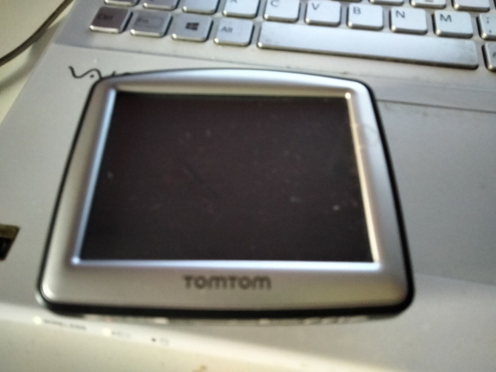

  17. thanks to all folks , also i have got an old tom tom which i would like to use during the trip but the inernal battery is totally flat which would mean that i should keep plug into the lighter inside my car , as the 748 hasn't got that and i have to face hours of trip i need to let it on with a bankpower do you think that this product can do the job well ?
    thanks British brothers

  18. No phone and Quadlock?
  19. i will try WAZE with the mobile , but i don't know how to lock the mobile on the handlebar
