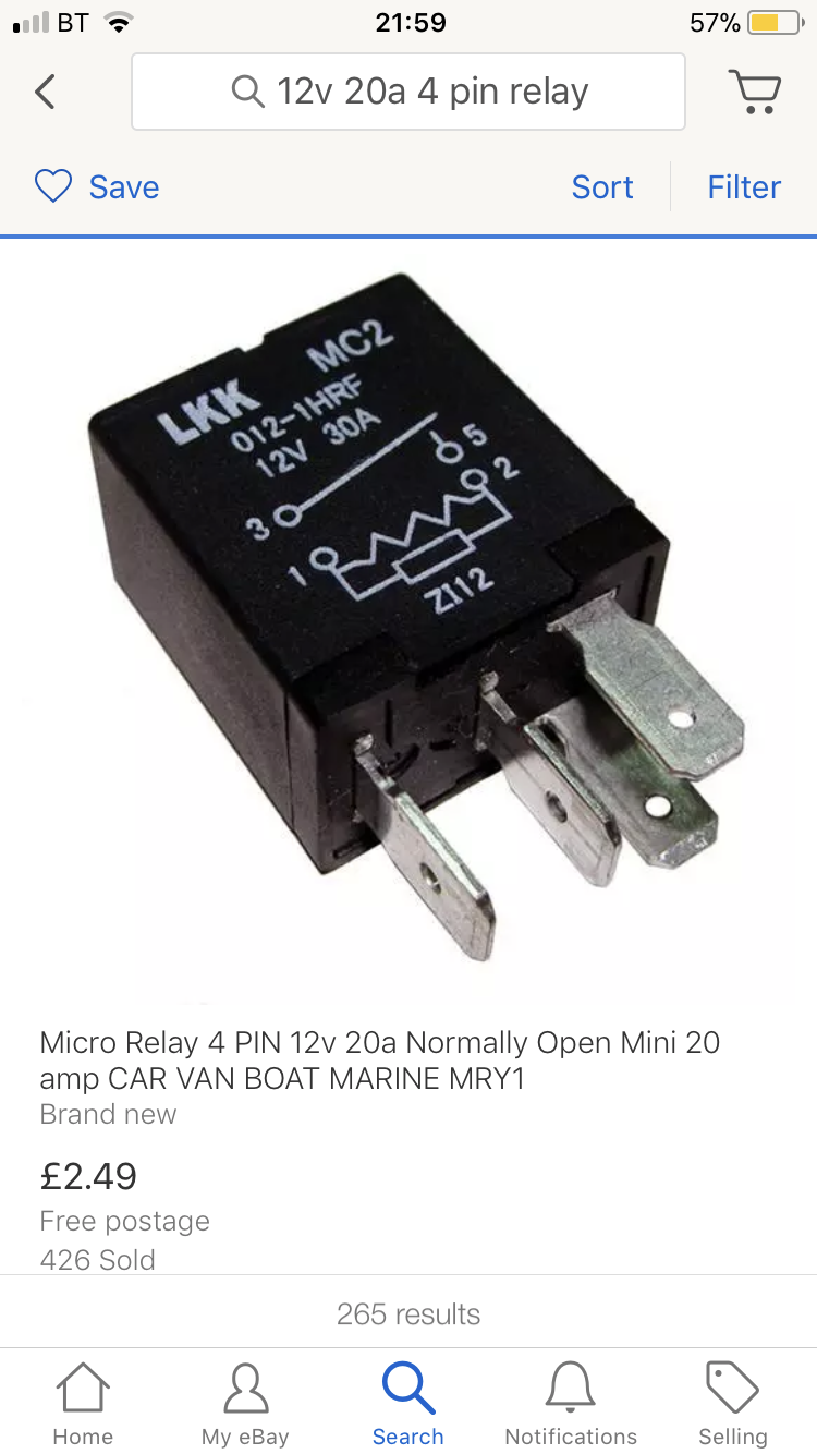

  1. Having problems starting my 749 turns over but won't start. It's been well covered in this Forum I.e. possible relay problems. Located the fuel one , going to check it by swapping it with the lights relay ,which I was told was the same. Could someone advise me on the location of the relay , before i start
    moving wiring looms etc lol.

  3. C3C90BAF-1EA5-4B83-8FB9-A59F1002870D.png Buy a new one.
  4. Jackdaw, the headlight relay is in the headlight assembly and is a bit of an effort to get to, easier to get a spare.

  6. Thanks 900streetfighter for the info , ordered and another problem solved with the help of you guys. Thanks again.

  10. If the relay you got looks exactly like the one in the picture above, you'll have the same problem, eventually. There's a newer version available which is sealed against water ingress.
  11. Thanks for the information I will look into it .
