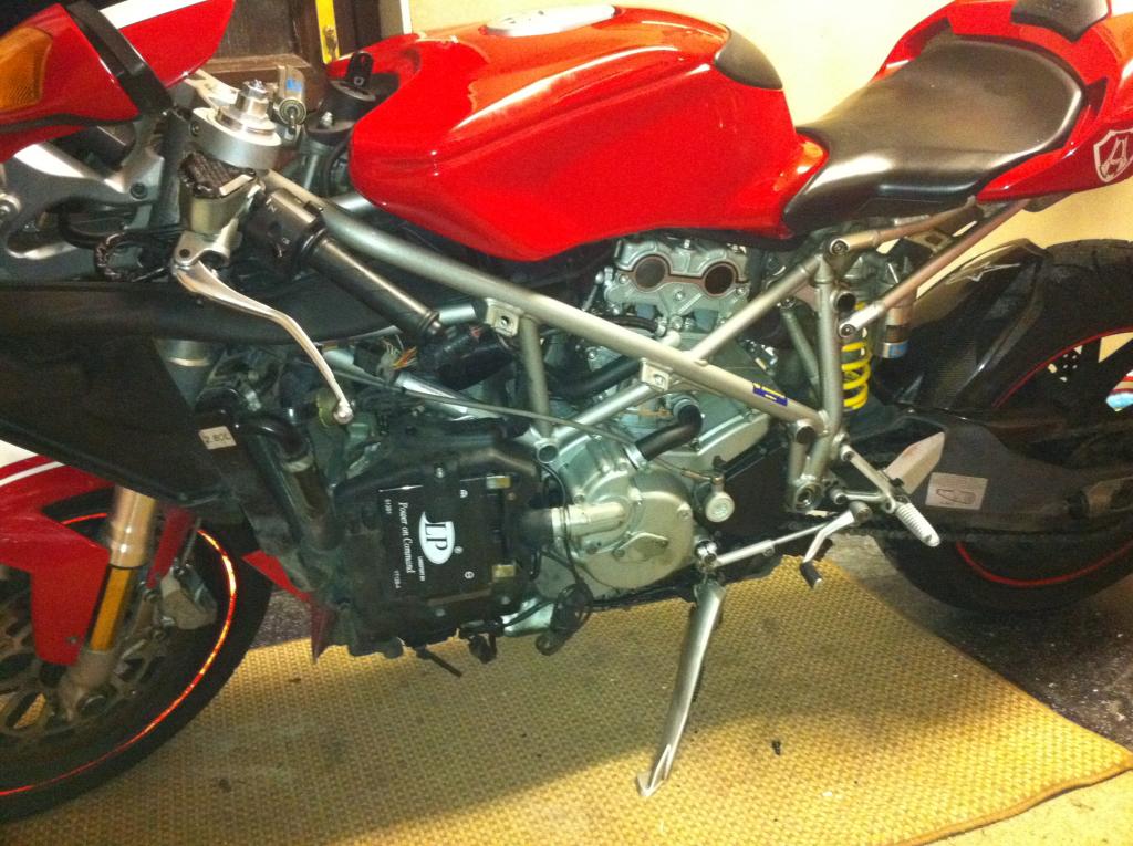

  15. IMG_2906.jpg Hi guys.. I had read a lot of posts on different forums telling the user to "yank" it near the nose cone..
    I was doing so and it wasnt coming.
    I DID get it off!
    Perhaps mine has been "altered" by previous owners but I had to reach in under light and physically unscrew the allen screw connecting the fairing to the light area by hand. no amount of pulling would have made it come.
    so.. unscrewed it and i was easily able to remove the left fairing..
    had to sit on bike.. put stand up.. remove from stand area... put stand down again but was no bother.
    Now I know the secret of my bike fairing removal ill have no issue doing it again..
    So, fairing is off my bike (finally)
    Now I can start looking for possible corrosion around this crank shaft sensor or any other wiring as you have previously suggested?
    Just checking to see where Im supposed to be looking now..

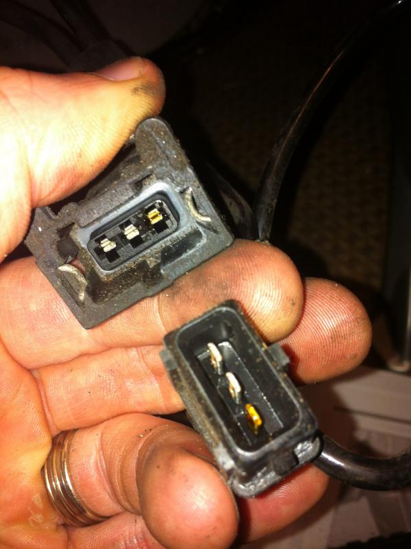

  16. Checking the connectors guys and look.
    Where this sensor joins onto a connector.. there is visible water in one side and the other has rust/corrosion.
    what sensor is this?
    its just to the right of the battery, massive long tail on the connector, all coiled up and elastic thing around it to tidy it up.
  17. That's your crank sensor mate. Use contact cleaner or brake cleaner in there. If youve got an old toothbrush that'll help. He that sorts the problem:upyeah:

    Plan to get some contact cleaner tomorrow and mini file to clean the spades/female side... scrape all that corrosion away.
    ive got some compressed air too so ill be sure to blast away any water in there first.
