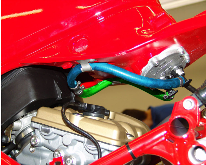

    The ONLY thing i did notice is in the workshop manual it shows the two fuel lines under the tank shoud be in a spesific order. The left line should be in the rear connector and the right line should be in the connector in front. This was mounted wrong when i took the tank of. I heav heard it dosent matter where they are plugged in, but in the manual they have market a specific palcement for them.
    If anyone have any inputs i would love to hear from you <3

  3. Fuel lines don’t matter which way around they’re fitted. Not to fuel supply anyhow.
    Only way you’ll know about the power is to get it dyno’d. While the evo made a few more hp, they’re all at the top end. It was a cam timing change. A stock 848 probably makes more mid range torque. Might even be a bit more everywhere, I can’t remember. I’ve ridden both and prefer the earlier bike’s characteristics.
    Torque is the key player, not hp, in roll ons.
  4. Thanks alot for a great awnser.. i will get it dynotested and take it from there :) Thank you again
