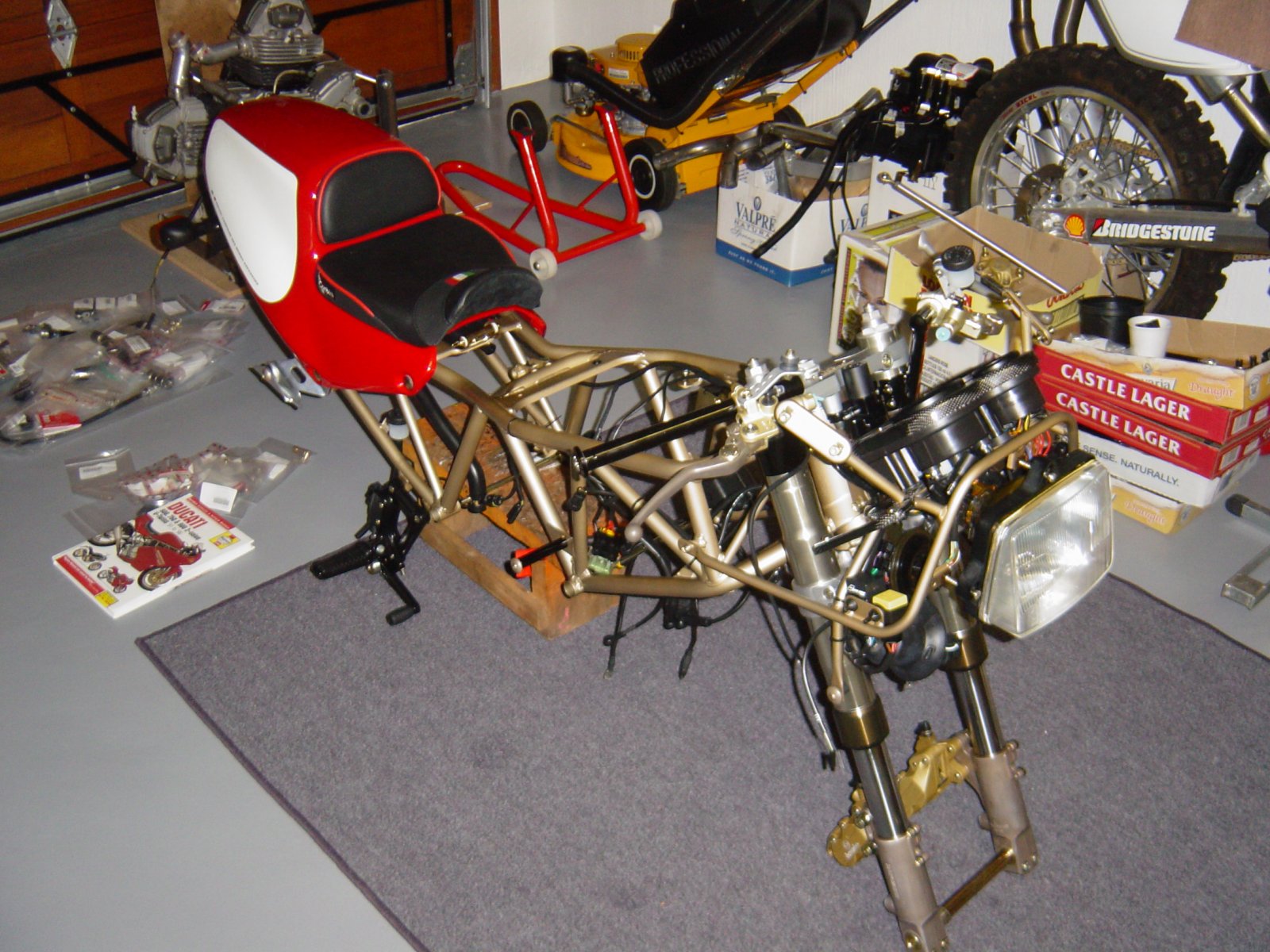

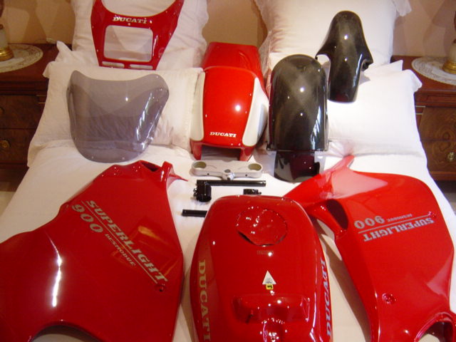

  1. Hi Gents,
    Am considering the Keihin 41 FCR/ Exactfit Ignition coil upgrade fro CA CYCLEWORKS.
    Has anybody recently done this or a similar upgrade that can share some valuable info, re PROS VS CONS
    Is the install easily enough accomplished without major jetting and dyno tuning?
    Motor is standard, heads serviced by Ducati agent, have the SILMOTOR carbon slipons.
    Are there better options available, ie FASTBIKEGEARS Ignitech Nology coils for use with the Ignitech TCIP4 system???
    As always, thanks for the valuable insight

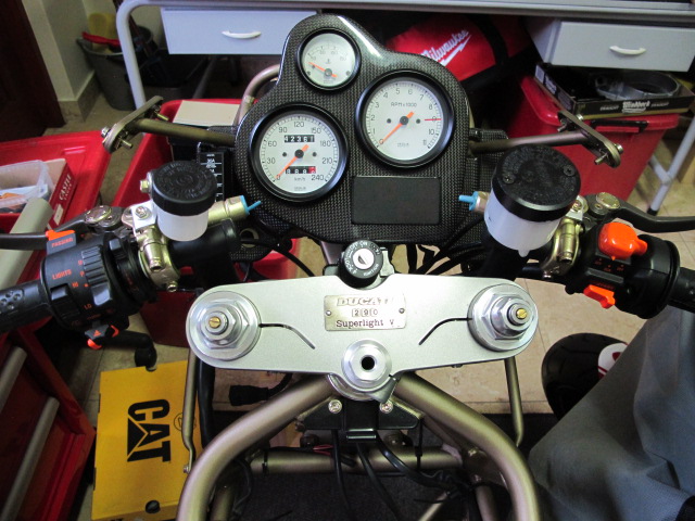

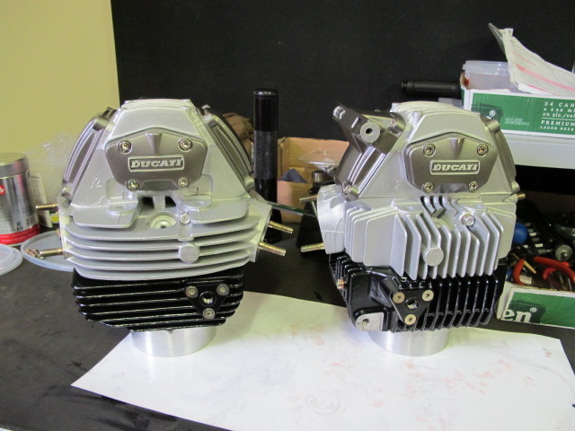

  8. Many thanks for the input offered so far!
    DUCATI KAMNA Germany offer a slightly more comprehensive kit, that offers a selection of jets and what appears to be an open airbox lid, with a bigger price tag.
    2 Options in the USA, CA CYcleworks, and Powerbarn offer pretty much the same option. Similar pricing.
    Still need to figure out what the better option will be wrt the Kokusan coil replacement as they appear to be substandard?
    I also like the idea of the electric fuel shutoff valve wired to the fuel pump relay!
