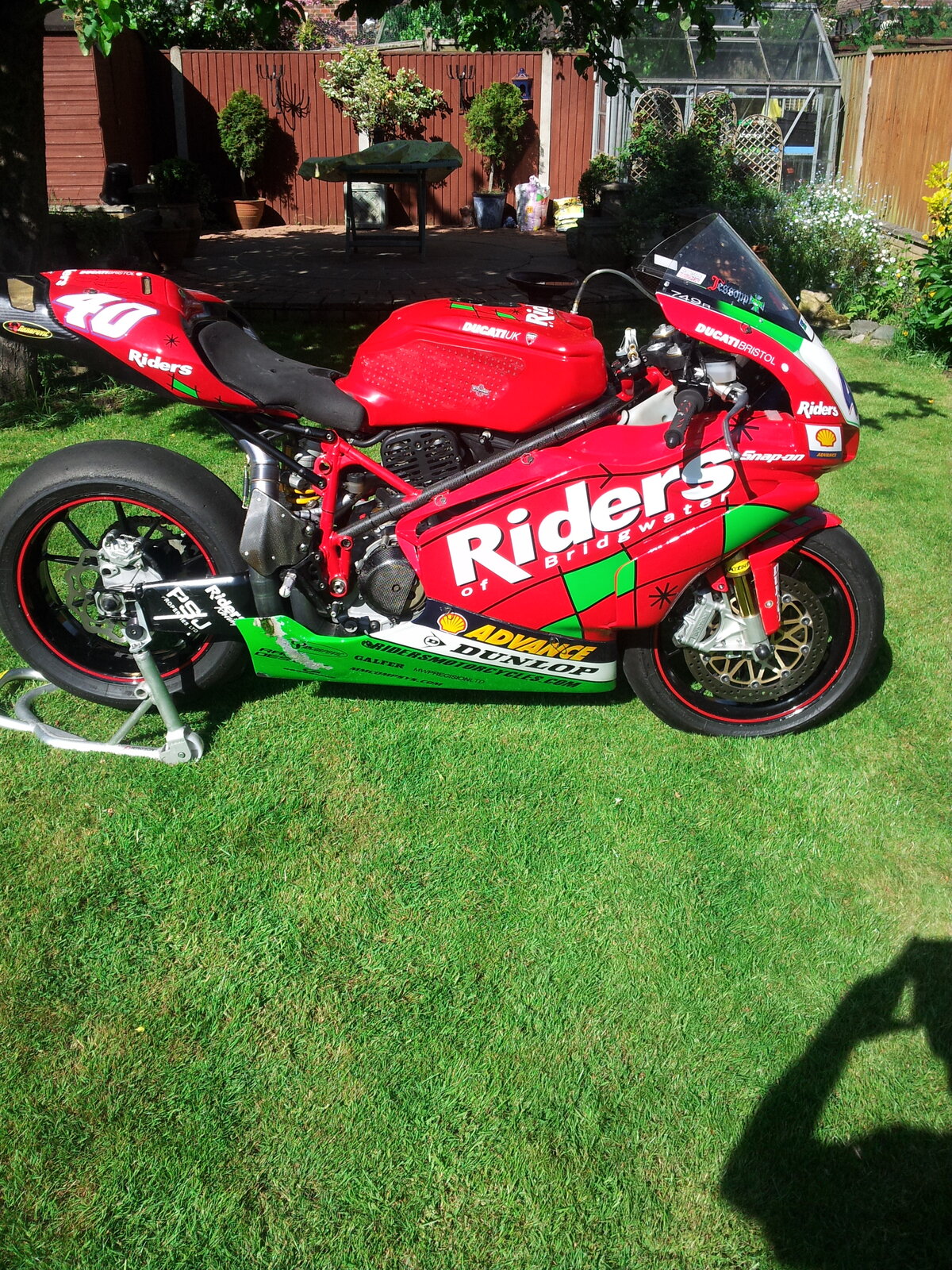

  9. In what way are 749RS throttle bodies different to std ones?
  10. RS has larger bore, and the injector holders are part of an aluminium trumpet which then bolts to the throttle body.
    Google Ducati 749RS injectors-images
    The road version, smaller bore and plastic trumpets with the injectors mounted in the air box lid.
  11. The throttle bodies are the same size. The kit trumpets are aluminium but are shorter then std 749/999 plastic items. Both hold the injectors in the trumpets, not the lid.
