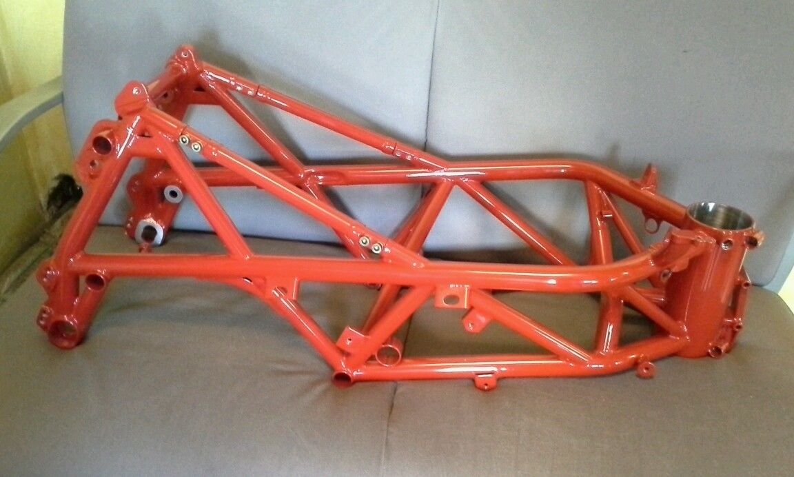

  12. Here you can see the difference:
    999RS has different tank mounting brackets. extra frame tubes and other steering damper mounting.
    And an cross bar section were you can only mount an RS airbox.
  13. Thanks for showing that mrfurry. I've not actually seen one bare like that before.
