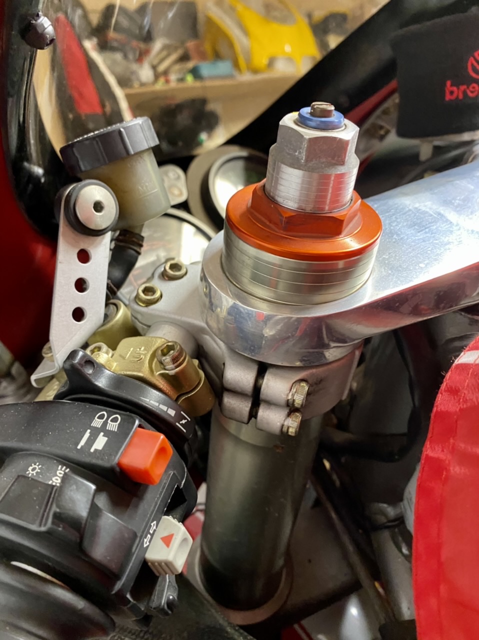

    ST2/4S/748/998 all 71.5cm top to bottom. The difference between the ST & 748 etc is where the top yoke sits on the fork obviously. On the ST it’s right at the top, 748 etc fork protudes through top yoke.

    C899A458-7643-4EC7-9C0C-A34742FAC564.jpeg CF54CE19-46B4-482F-8025-BAB11CE8176D.jpeg

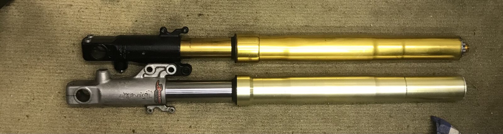

  12. This is the difference.
    Richard

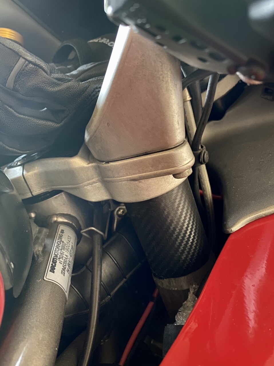

  13. The one I saw a pic of had the protruding preload and recount screw is at the top, not flat capped, and I wasn’t sure if adjustable monster forks were like that.
  14. The lower fork leg in the above picture looks exactly the same as my '94 750SS legs. The 900SS from the same era was the same, but with the pre-load adjusters on the top & an adjuster screw in the bottom, on the protrusion just below the caliper mounts.
  15. The lower leg is a '93 750ss but is the same length as a 93' 900ss leg. I think the upper leg may be an earlier 900ss leg (not sure what year)
