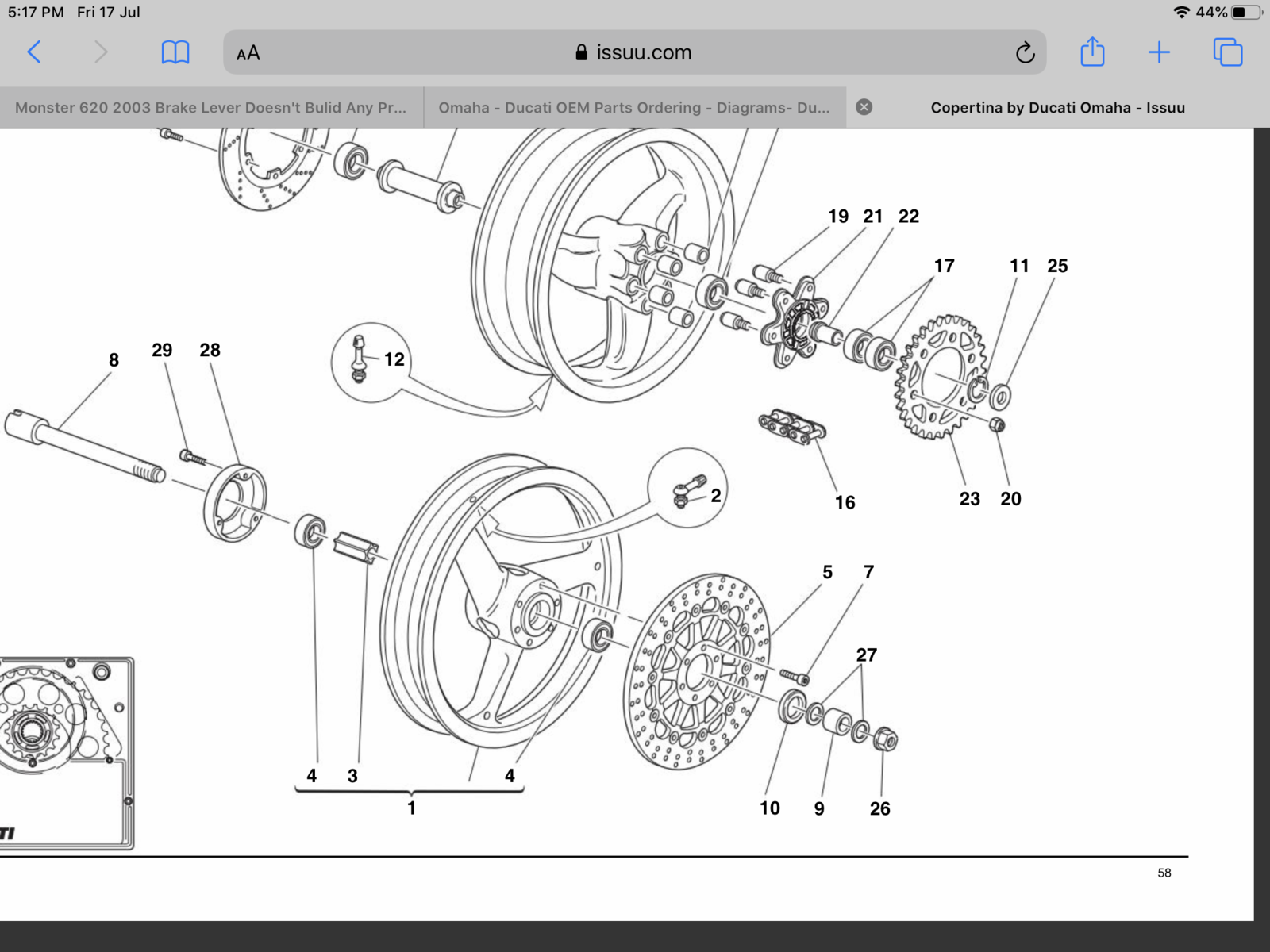

  6. https://imgur.com/a/9lTi3aG
    i think i might've found the issue with my brakes, that's the part number 2? can someone send me a picture? i think it's missing thus i'm having issues with my brakes

  9. Dude, you are quoting exactly the same problems as a previous member had - one who has now deregistered. You are quoting you have done exactly the same things as the previous member had done to rectify his problem.
    The problem for the previous member all started because he fitted an aftermarket 'part number 2' in your post above, forgive me if I'm mistaken in thinking you might be he.
    Regardless of who I think you are, are you now saying you are missing the brake lever and its pivot pin?

  14. I mean you have rebuilt your brake system, changed the fluid, have no brake pressure and now suspect that you might be missing the brake lever? Are you Tim Tim?
  15. Have you checked to make sure that part no 1 is not missing?

  18. @cremone98 we want to help but really, are you missing the brake lever?
    You said, in your previous los guise you put aftermarket levers on. Someone suggested they weren’t appropriate. Could be right. Perhaps the rod which compresses the piston on the master cylinder is shorter on the aftermarket lever than the original lever. Have you got hold of an original lever and tried that?
