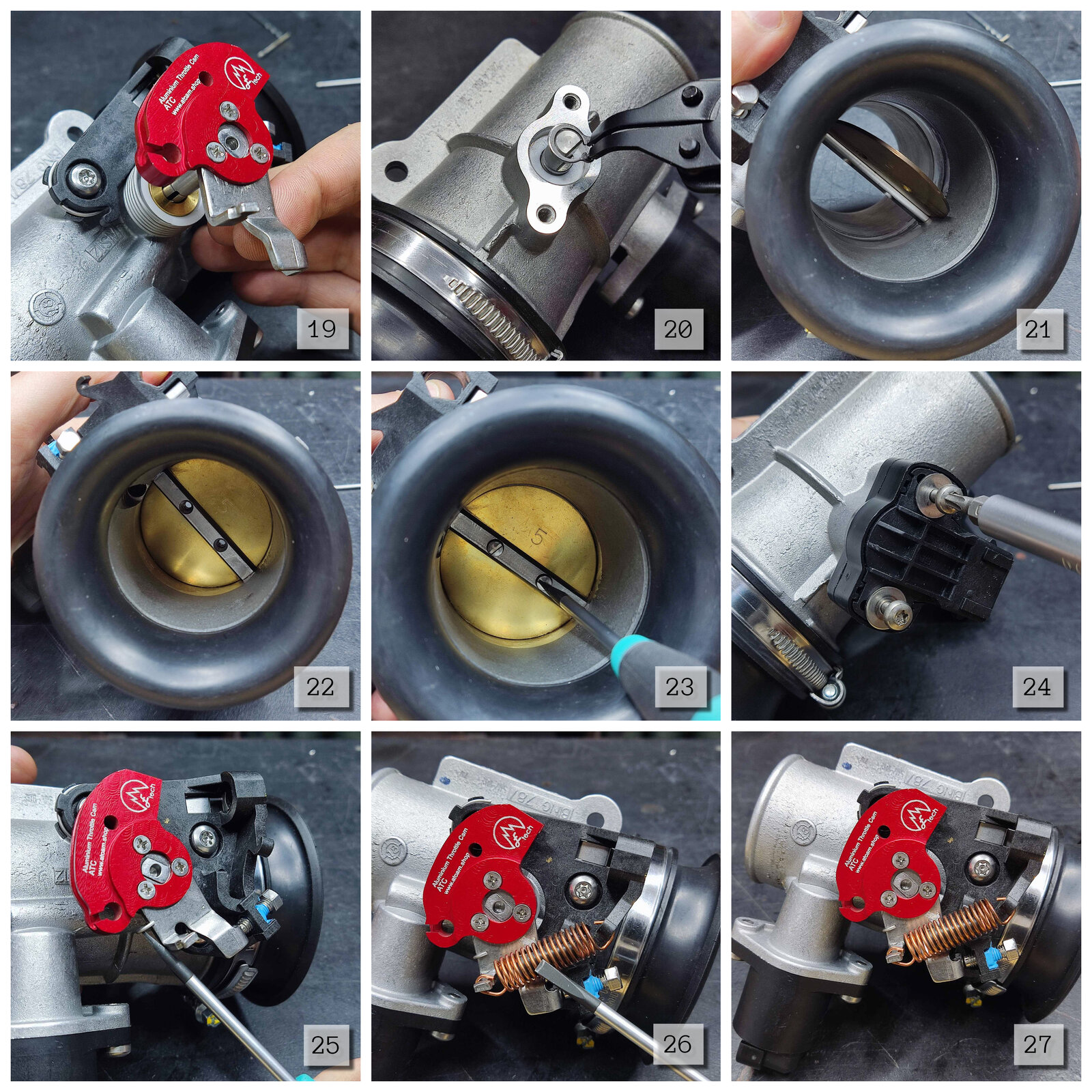

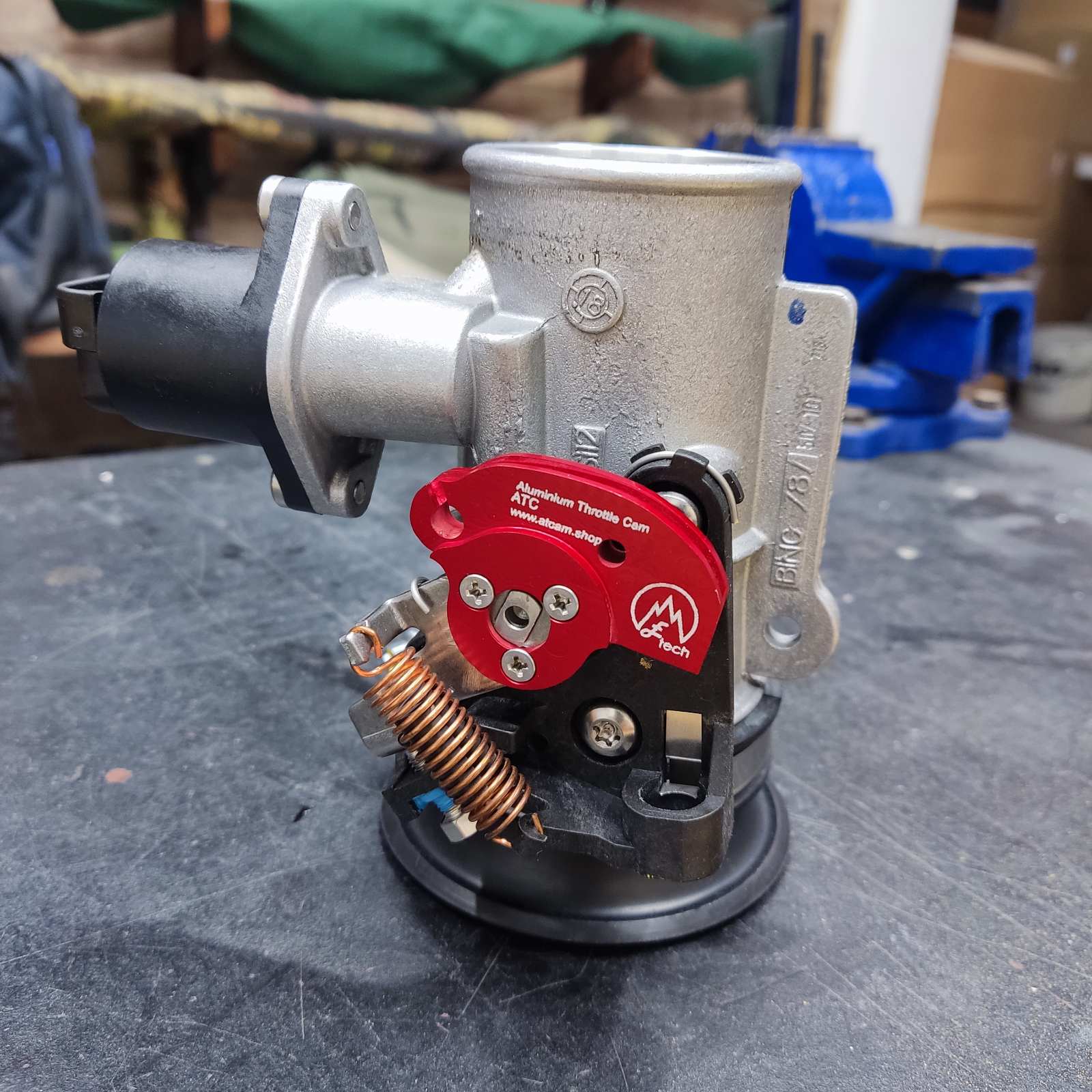

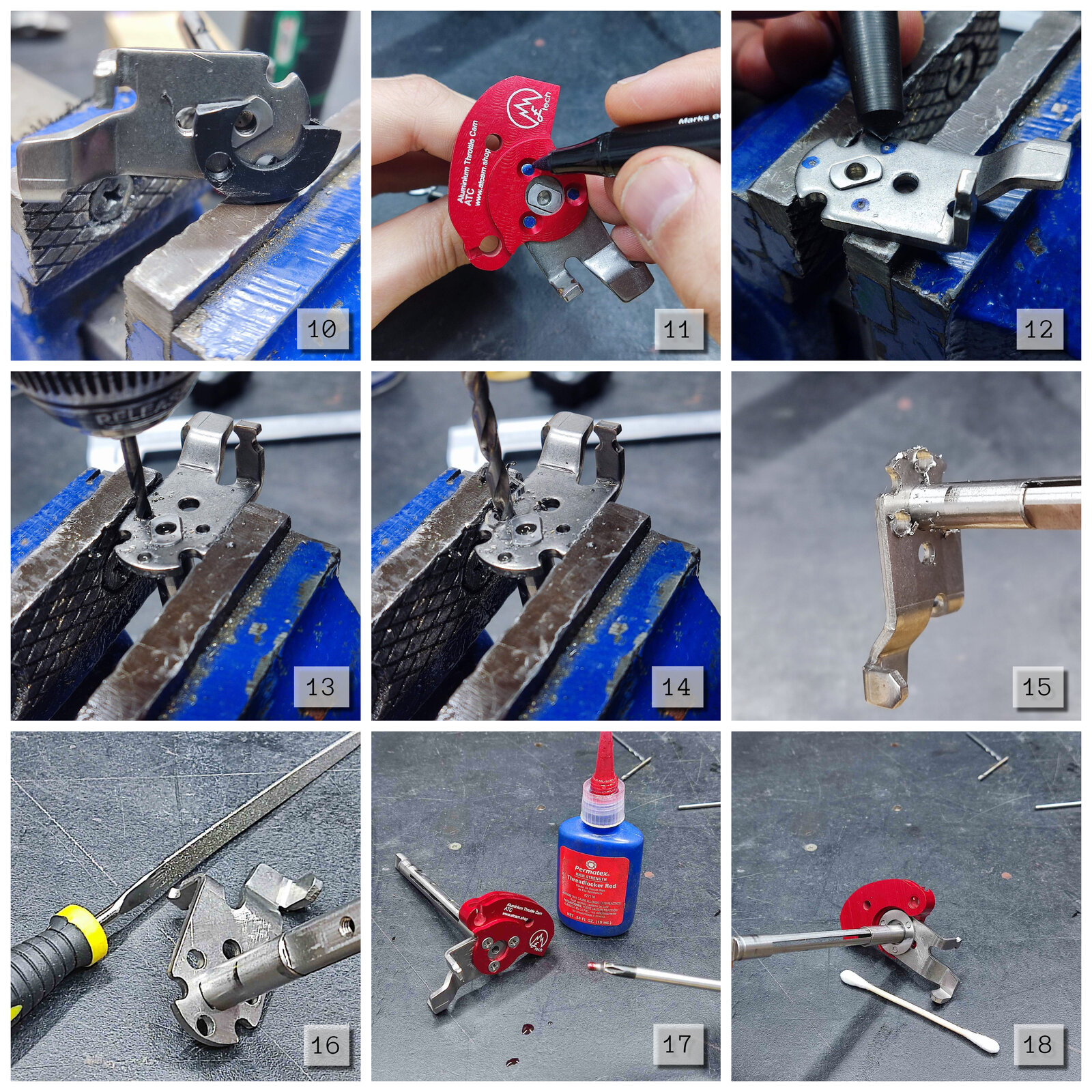

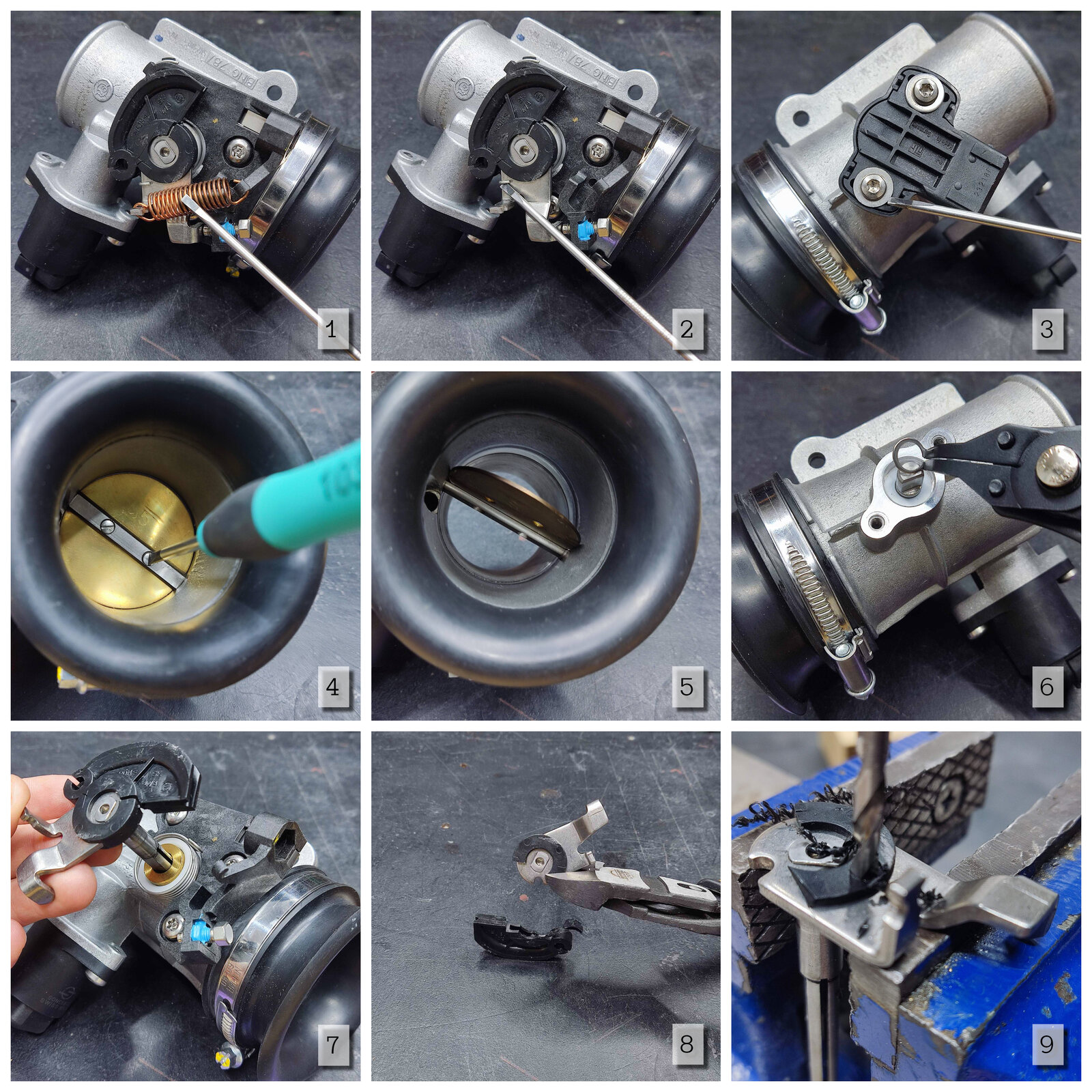

    As I said, I'm trying to fix things or upgrade them and I will show you a fix.

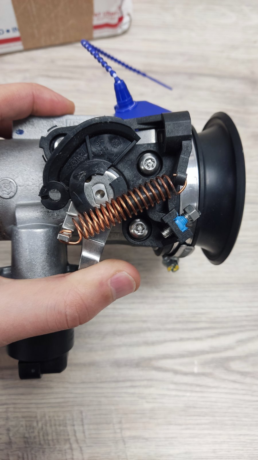

    So I bought a throttle body to show you what I want to explain and also to warn you that this is kind of dangerous things to happen while riding.
    Also I will include the steps shown on pictures just to see briefly how it's made and a youtube video you can watch it by clicking here that shows the whole process.
    My opinion on this failure is: Plastic pulley, actually isn't a failure. I'm sure that the engeneer decision to be plastic instead of metal, is well calculated to break at some point.
    The throttle body I purchased is from Ducati Scrambler 800 Cafe Racer 2019. The part is made from aluminium alloy and them it's anodised as you see the aluminium is colored just for aestetic point if view.
