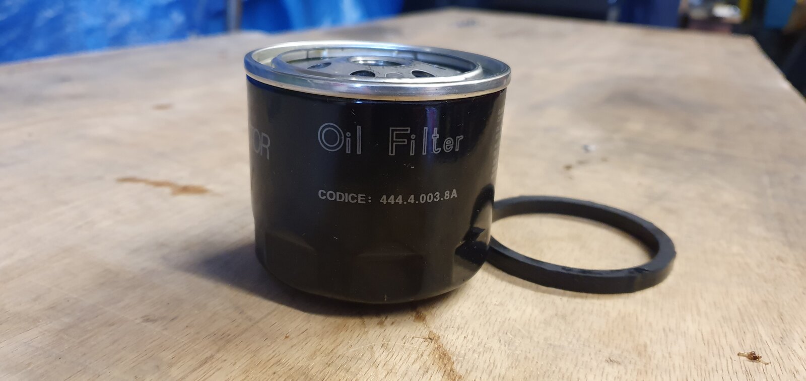

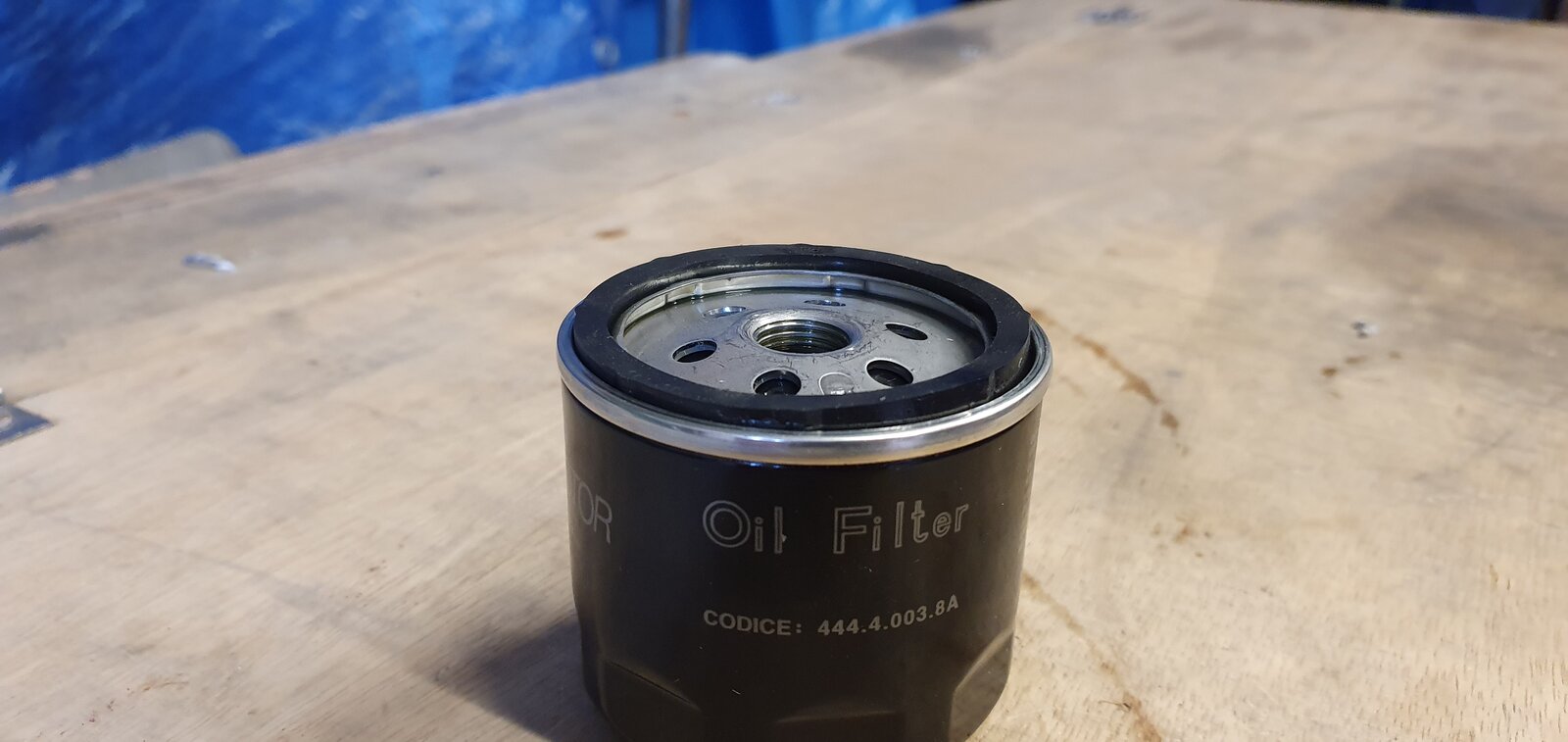

  1. Hi,
    Is this the correct oil filter for an S4?, reason I'm asking is it was fitted to my bike during a service and noticed a drip coming from it today.
    The seal is separate from the filter and doesn't sit very well in the groove. Changed it today for a Hiflo filter just to be safe.
    Cheers, Brendan.

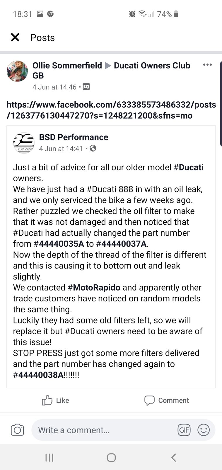

  3. Think there has been an issue with Ducati oil filters recently, done a wee bit of searching and came up with this.
    Might help anyone else out there who has recently changed filters etc.

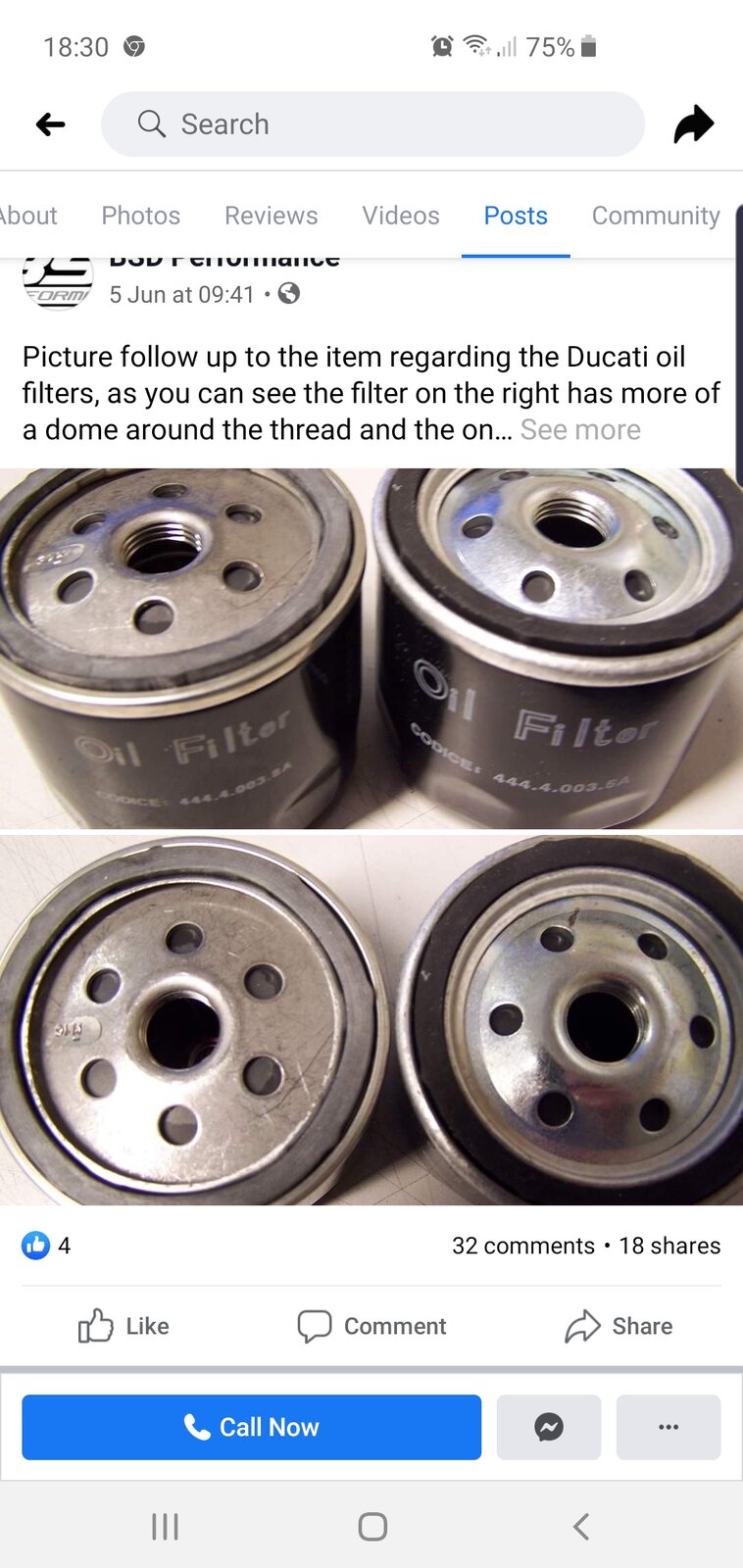

  5. Think that was the issue, the new filters are slightly different from the old ones. The domed area that screws in is slightly higher causing the issue of leaking oil.
