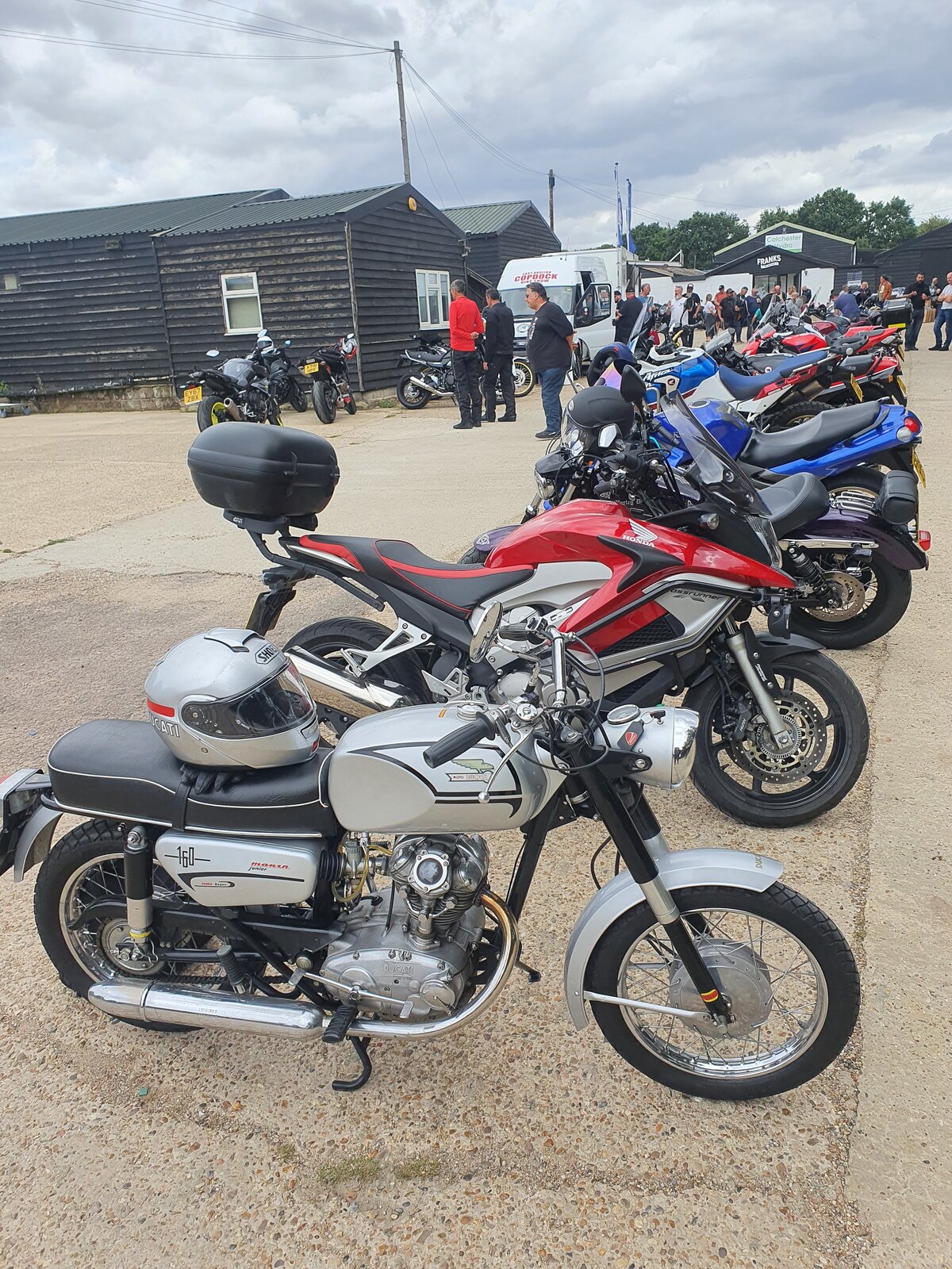

  1. Hi there does anyone know the rear chain size for a monza junior
  3. Believe it is 428 by 116 link chain
  4. The 160 used a 420 chain, it's the same pitch as the 428 but narrower. IIRC from my project the 420 sprockets are harder to find. The splines on the countershaft are the same as the larger bikes though, so you can use the 428 chain and sprockets from a 250 if you'd like.

  6. Many thanks, that is very helpful. Got a new chain, 428 and fitted it, looks like a previous owner had changed the sprockets to suit. Old chain totally worn out.
