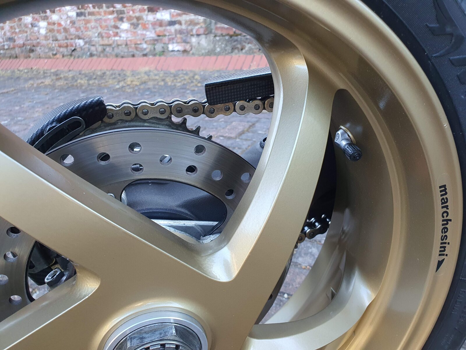

    The main part of the refurb/look of the bike is the painting of the motor with something that lasts, also this has new colour for the wheels that brightens the whole look. Other touches I’ve done are carbon clutch cover, carbon hugger, carbon exhaust shield and some carbon look wrapped items. Many stainless steel fasteners round the motor and the frame.

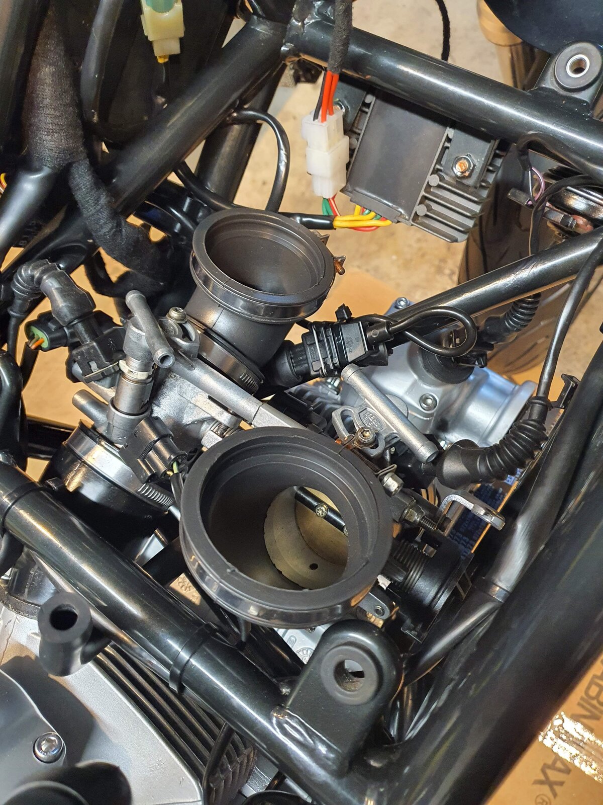

    Includes new exhaust valve guides, seats recut, all the valves lapped in and new stem seals. New Dayco timing belts, valve clearances set (a printout inc) and cams dialed-in to spec. The starter motor has been stripped and cleaned with new bright mounting bolts (earth points). Throttle bodies cleaned with injectors tested/as a matched pair.[​IMG]
