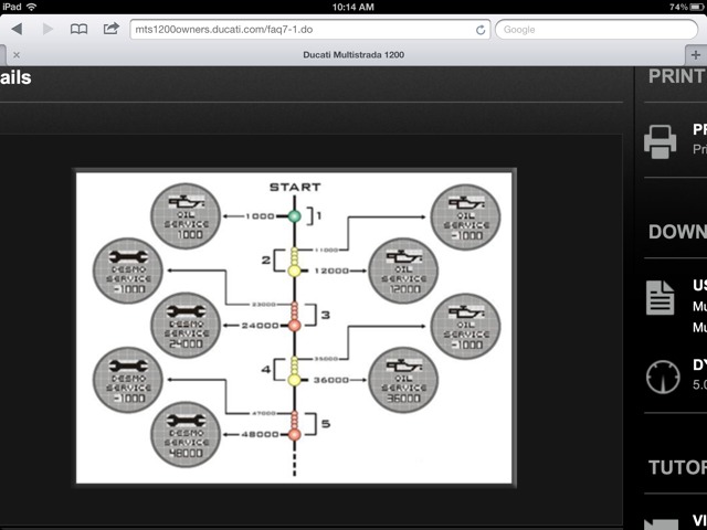

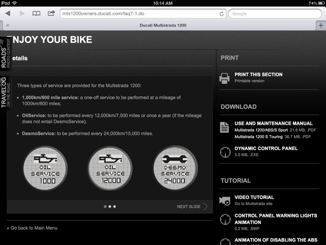

My mts1200 belts are every 4 years or 15,000 miles I've all ways checked before buying, service every year or at 7500 miles whichever comes first that's as good as it comes on a ducati
MTS and Diavel are 5 years on the belts Stu, or the 15k, whichever comes up first. The new schedules have caused some confusion but that should be sorted now. They started back in 2007 with the M695....... Rule of thumb is that the bike is serviced annually. Mileage is then considered as to whether or not it needs one of the "Desmo" services. "Simples..........":wink:

Do we know why best are that long on the mts & diavel but not the other bikes nelly? Are they made of different rubber or something?
Aren't the longer service intervals just a result of a chnage in the valve collets, after an aftermarket design concept, that means that the valve clearances remain more stable for longer? There has been no major changes to the design of the belts or pulleys and so, the valves notwithstanding, any Ducati running kevlar betls will happily do 15k miles on a set. Certainly from what I've read, that was my understanding of it. A
