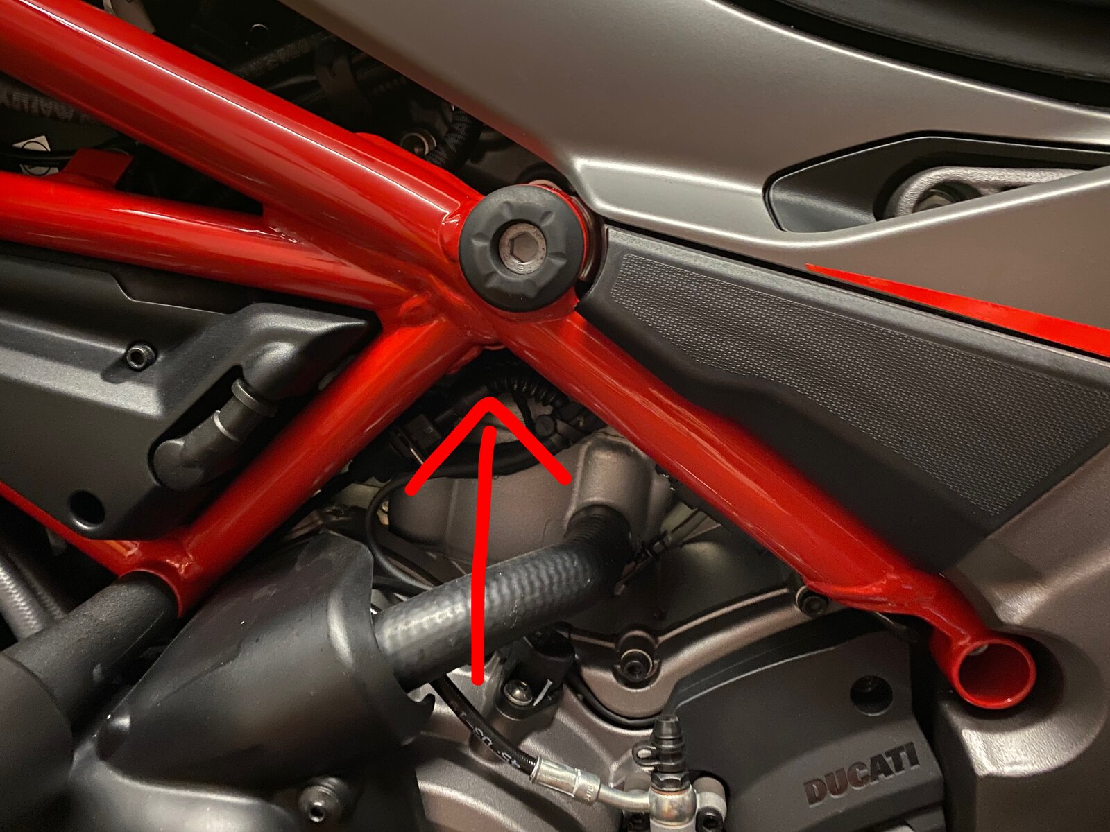

  2. I cut and shut mine with a length of cable from another adapter cable, I soldered and shrink wrapped the joints.
    Connector now comes out the left side of the bike just above the clutch slave cylinder.

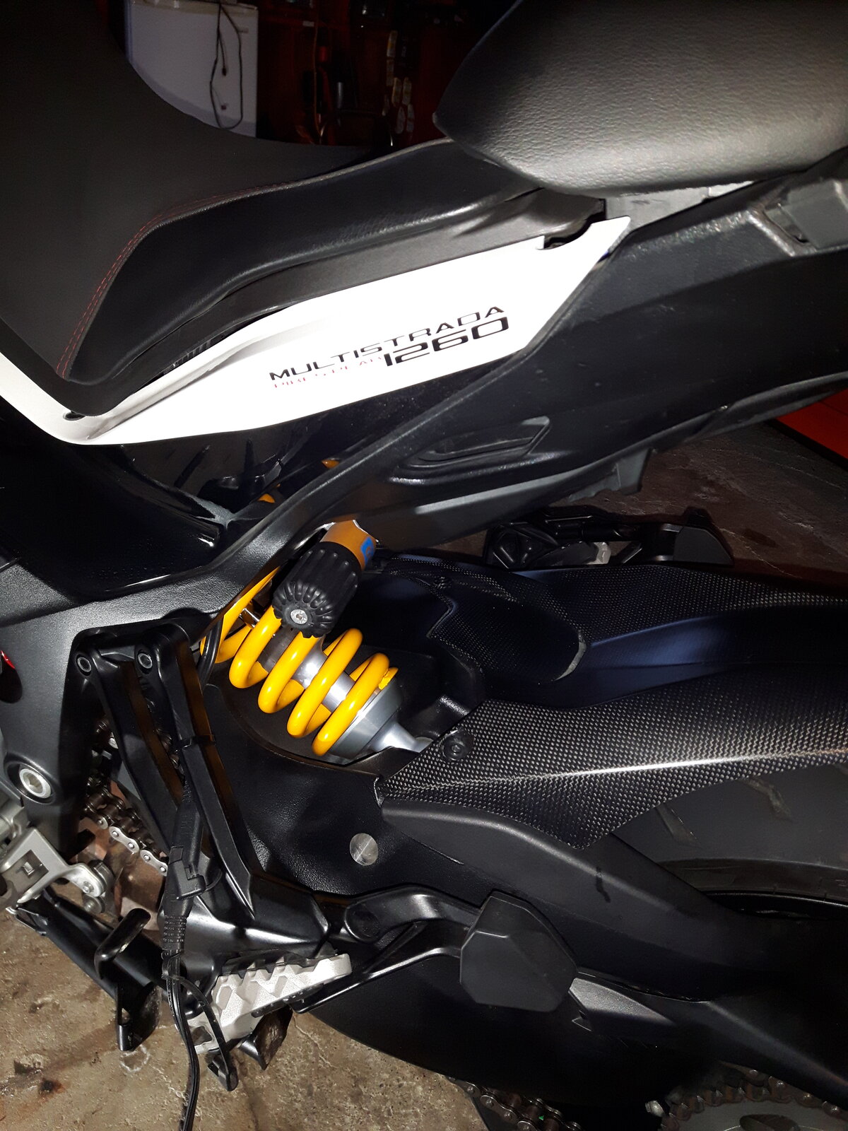

  13. For now, I’ve got it here:
    But with the extension, or longer cable, I’ll stick it here:
  14. That will work.
    You can get longer a pig-tail SAE. They’re available everywhere.
    Just make sure it's fused to handle the higher amperage of any heated gear you may want to use.

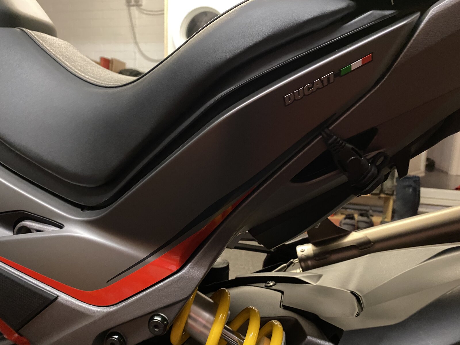

  15. That’s where mine is located now I have made the cable longer.
  16. It’ll be nice to have it tucked away somewhere discreet.
