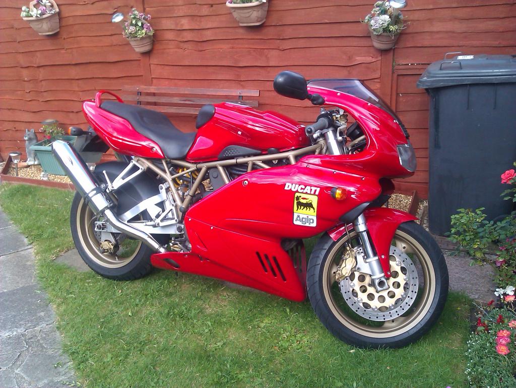

  5. my SS lived outdoors on the west Scottish highland coast (Oban) for three years in the previous owners hands. Then engine finish suffered a litle, as did a few ad hoc nuts and bolts, but it took very little work to return it to very respectable condition. Its kept warm and safe living a very pampered life in my garage now, but to be honest I think they are more robust than people give them credit for.
    It cost about £50 in stainless fasteners, polish and elbow grease to get it looking like this.

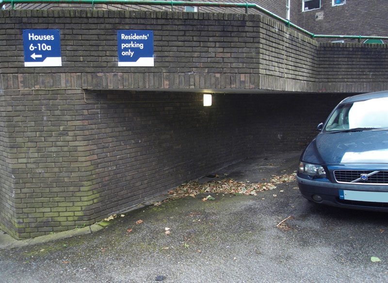

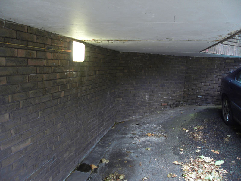

  7. These are some shots of my parking place.
    I Don't know if it will be possible to fit a solar panel for the optimizer but I could give it a try. I think it will be ok, I got a better look at the place now and I dont think rain will get to the bike even with cross winds. I should cover the bike with a waterproof cover and i think it will be enough to protect it against humidity and water. Hope so..
