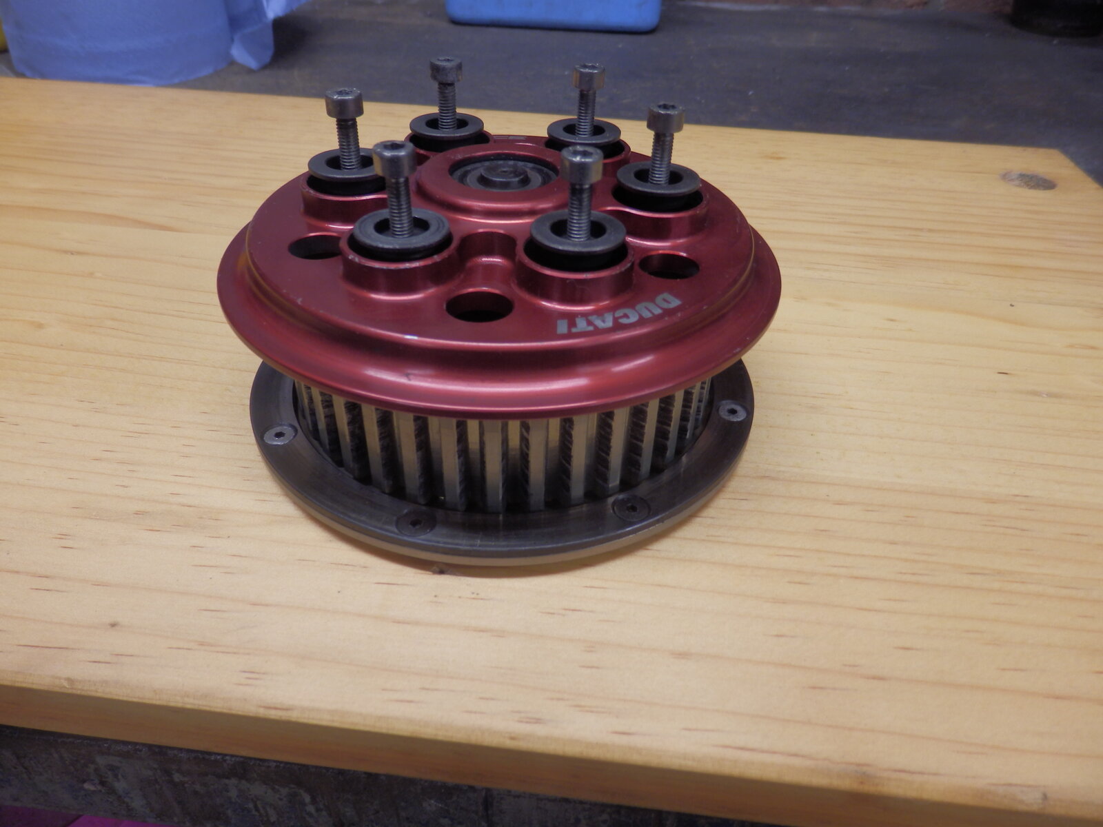

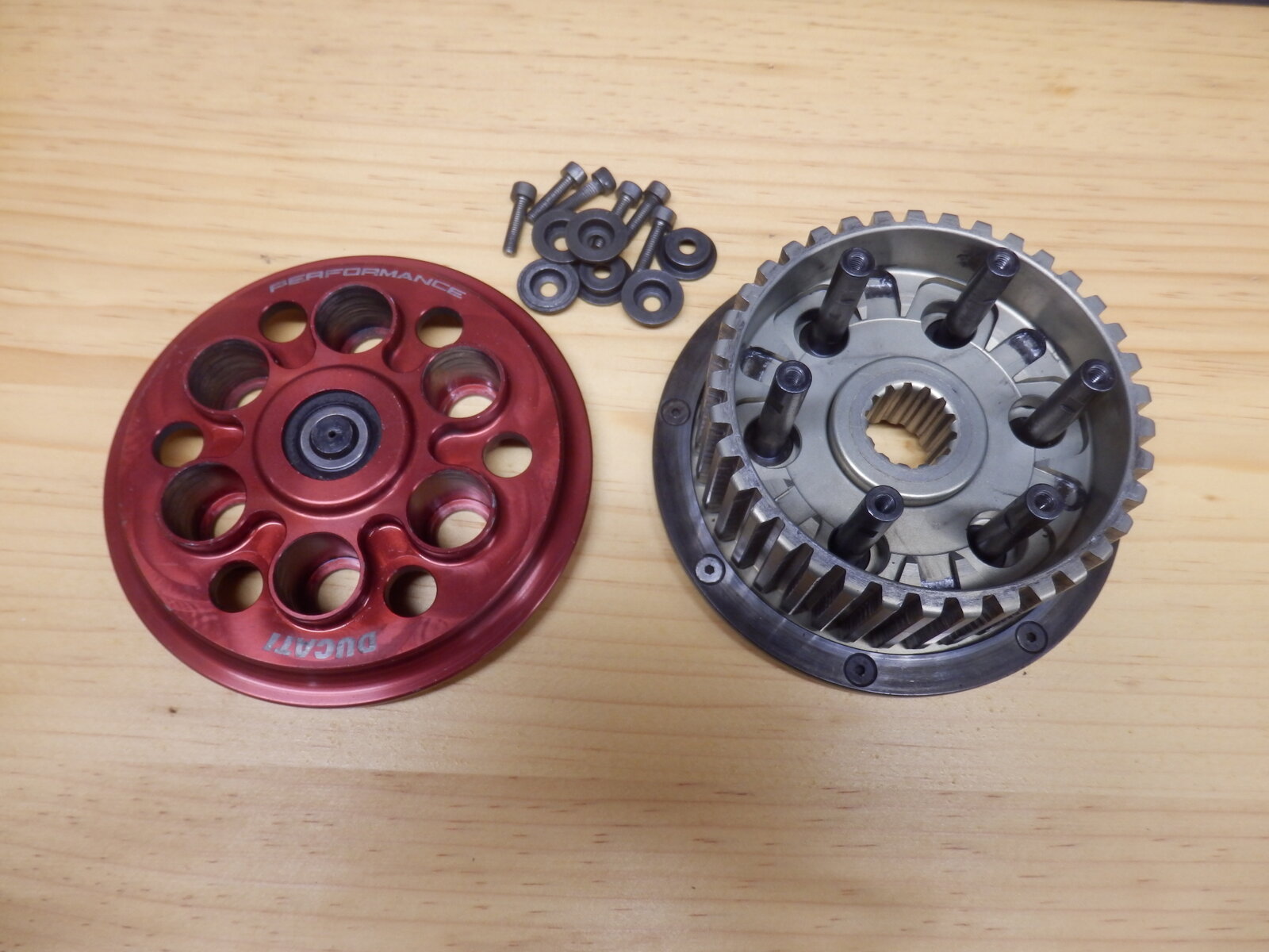

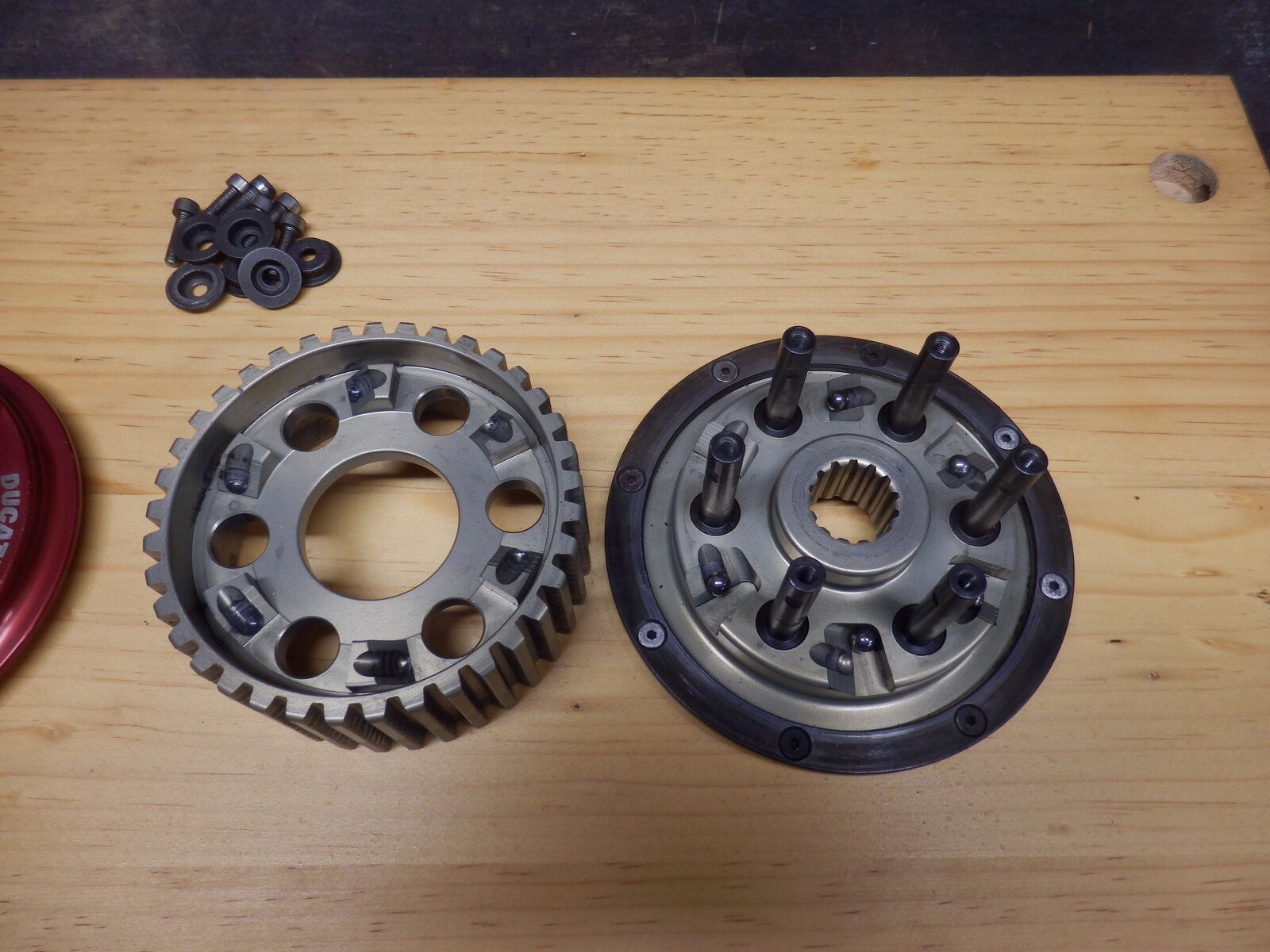

Do I need a Slipper Clutch for the use I put my bikes to? – No. Have I ever ridden a Slipper Clutch equipped bike? – No. Will I get anywhere any quicker or more efficiently with a Slipper Clutch fitted? – No. Can I justify the cost of a Slipper clutch? – No. Would I know which of my 3 bikes would benefit most from one? – No. Am I intrigued by them and want to fiddle with one? – Absolutely. Do I want to understand them and spend some time learning how to get the best from them? – Yes. Am I likely to enter the world of Slipper Clutch ownership the easy way by buying a complete new one? – No, of course not! Have I brought a knackered incomplete one cheap to play with? – Yes. Have I spent too much time already inspecting it, measuring it, and researching it on the net? – Yes. In the image above the drum looks completely knackered, but actually it’s not that bad and is recoverable. It’s obviously missing some hardware but the basics are there. I’ve had a lot of ‘fun’ fiddling with and understanding what works with normal dry clutches over the years with regard to mods, stack height and plate order etc, so want to push myself on a bit with this. I believe it’s the STM 6 ball type, Ducati Performance Branded, and of the type that would have originally been fitted to the 748R etc as standard. I can use it with standard plates, Basket, and springs, which I have all of, but am going to need some parts. I do have a couple of Brand new Spider Springs, which came in a job lot of parts I brought, and until now didn’t really know what they were for. It looks like there are two versions of securing the drum, spring etc to the shaft. The early version with conventional nut, washer and spacer: And the later version with a special nut: I’m going to go for the later version as I’m ½ convinced the early version has the possibility of clamping the Spider spring so it can’t rotate and contributes to the reports of broken Springs. Oh, and of course I’m aware of the requirement for regular maintenance and lubrication. So the reality is I need 3 parts. The replacement sleeve – part 23 on the second Diagram (71310952A or 71310952A) The Belleville washer – Part 28 on the Diagram (79910512A) The Special nut – Part 6 above. (75010501A or 75011341A) If anyone has any of these I’d appreciate hearing from you before committing to Ducati prices. Once I’ve got the parts I’ll put the Clutch on to one of my bikes and start playing with building up a stack of plates, which looks like I should be aiming for a total of 36.5mm. I’ve noted the rearmost plate is to be a Friction plate etc. But firstly I have to decide which bike to put the Clutch in. It would probably most suit my 999. The most ‘trick’ of my bikes is my 1000SS/900SL hybrid, so it would add to that. But the easiest one to play with would be my M1000, which being un-faired allows easier access to play with it. Luckily all three should require the same M20 nut, so I can change my mind.

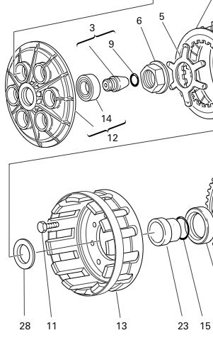

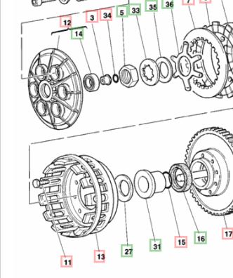

Interesting that you say that Comfysofa. Does yours have the combined central Spacer, Washer and Nut to locate the Spider? Or the separate individual parts?
Never replaced a spider on1 any of the four slippers I have/had. All were with integrated bush/washer. Dab of grease around central bore and on each of the six feet (not really an arachnid is it?) anual regrease ( of the whole assembly) and they are all fine.
Thanks RickyX Having read a whole load of threads on here and the DucatiMS Forum there would appear to be a bit of a link between broken spiders and the use of the 3 part system instead of the newer special one part nut. Assuming the 3 parts are assembled in the correct order, I'm wondering if any movement during assembly allows the spider to become trapped between the separate parts so it can't spin around the shaft as the outer drum section spins on the inner bit. The result being broken springs.
