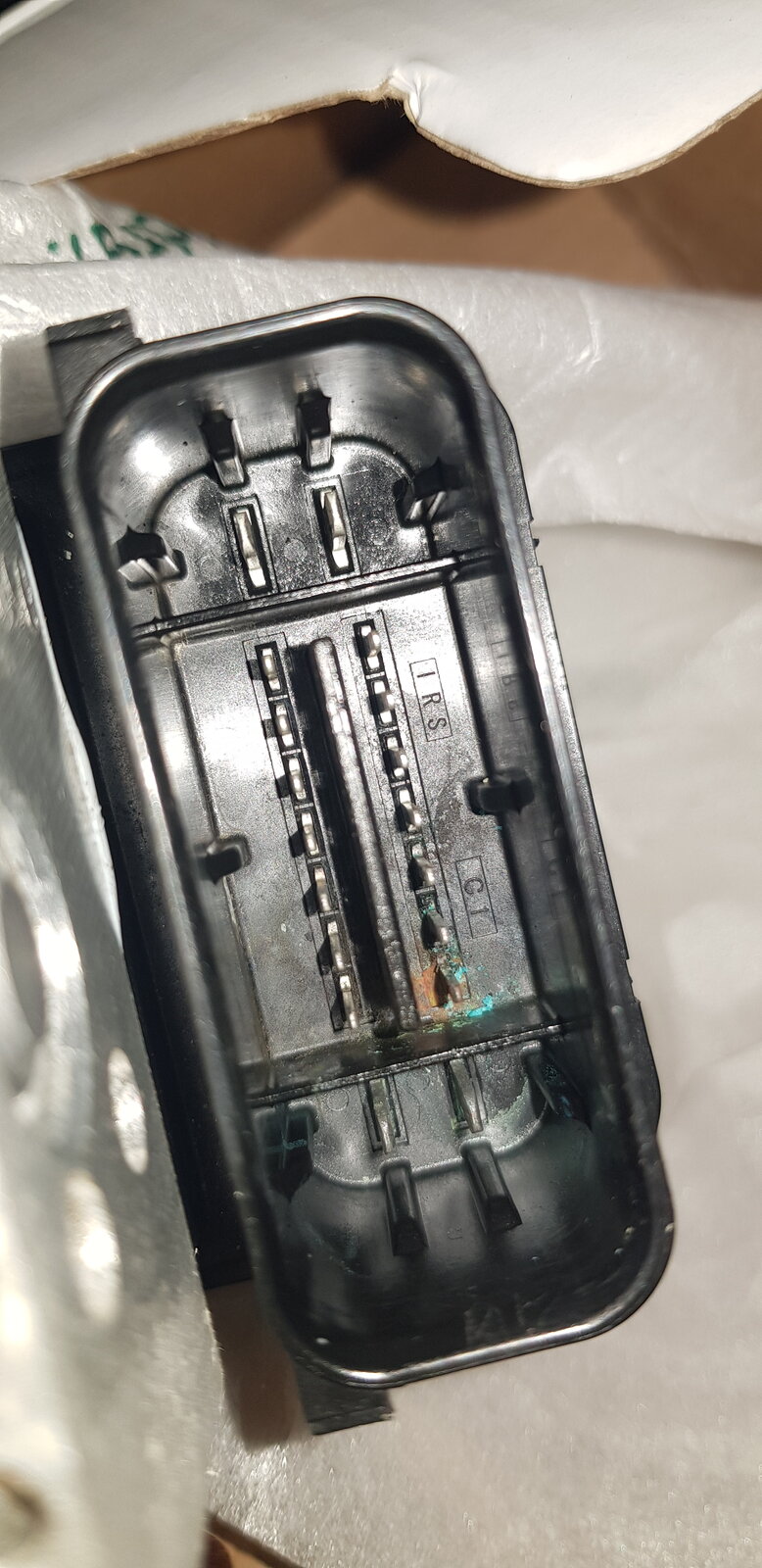

    Just wanted to share my experience with a complex fault i had on my Scrambler 800 -2015 with 1.5k miles and FSH.
    Few months ago, i suddenly developed an ABS error followed by an intermittent speedo, which developed into a fully faulty speedo, showing either 0 or ---.
    rear speed sensor changed, spacers adjusted, no avail.
    Checked battery,fuses, all connections and front abs sensor - no avail.
    Diagnostics didnt specify exact fault.
    Ducati dealer disconnected abs module and found water ingress on the pins!! They said they have never changed an ABS pump on a Ducati before.
    Called several UK shops same answer.
    New ABS pump was £1.8k !!
    Bought a second hand pump, fitted, bled and hey presto!
    Apparently i am the only one on record with a shot Scrambler ABS pump!

  3. i (my indie) changed the whole pump. it comes as the mechanical pump coupled with the ABS electronic module attached to it as one block. it is a straight forward swap.
    my concern, is that it is unknown to Scramblers to have shot ABS pumps, not sure how the water ingress happened. yes it does live under a cover but it is not used in bad weather (wife's bike). makes me wonder whether the Ducati Low Seat could be a culprit design wise ?
  4. Part 12 on the diagram then? ABS control unit? At least you managed to trace the fault and have now fixed it; useful info and thanks for feeding it back to the Forum:upyeah:.
    It looks like it sits in some sort of housing to prevent water ingress from below but perhaps once the new one in place it might be worth attempting to cover it from above as well. Perhaps water is running from above and collecting in the housing it sits in :thinkingface:
  5. It literally took me months to trace.
    First thing ill do tomorrow is seal the connector
