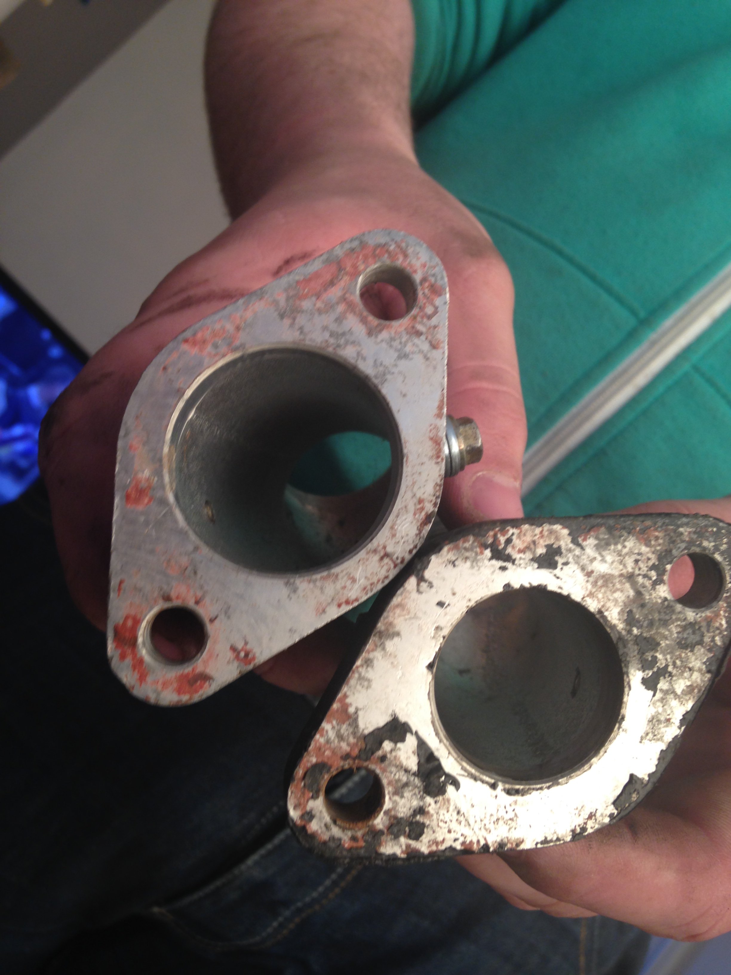

  12. well, manifolds fitted :) couldn't test as the bloody starter switch is playing up at the mo, but by bypassing it, the bike starts a lot easier and sounds a lot more healthy when revving :)
    For a comparison of manifold diameter ....
    left is 750, right 600
    Thanks all for helping me out :) now anyone got a starter switch? ;)
