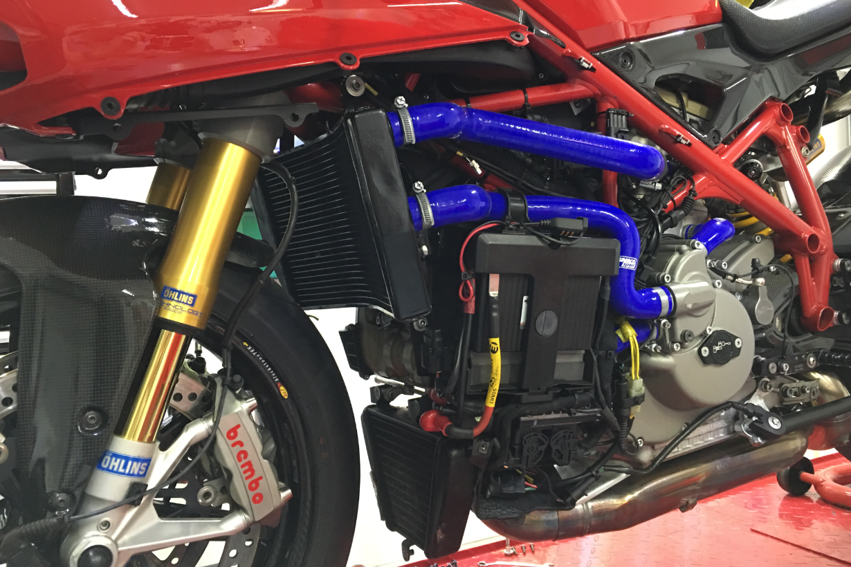

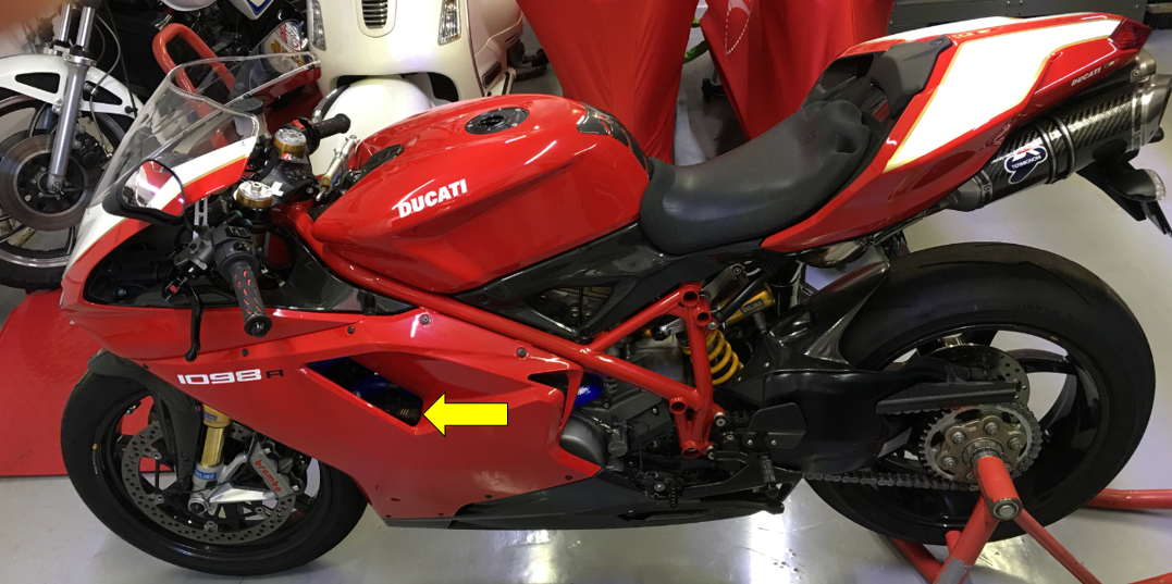

  7. Attach the fly lead that comes with your Optimate like the pic below (not an Optimate lead, but a C-Tek for my LiPo charger)
    When the bodywork is fitted, it's easily accessible to plug your lead in through the fairing vent.

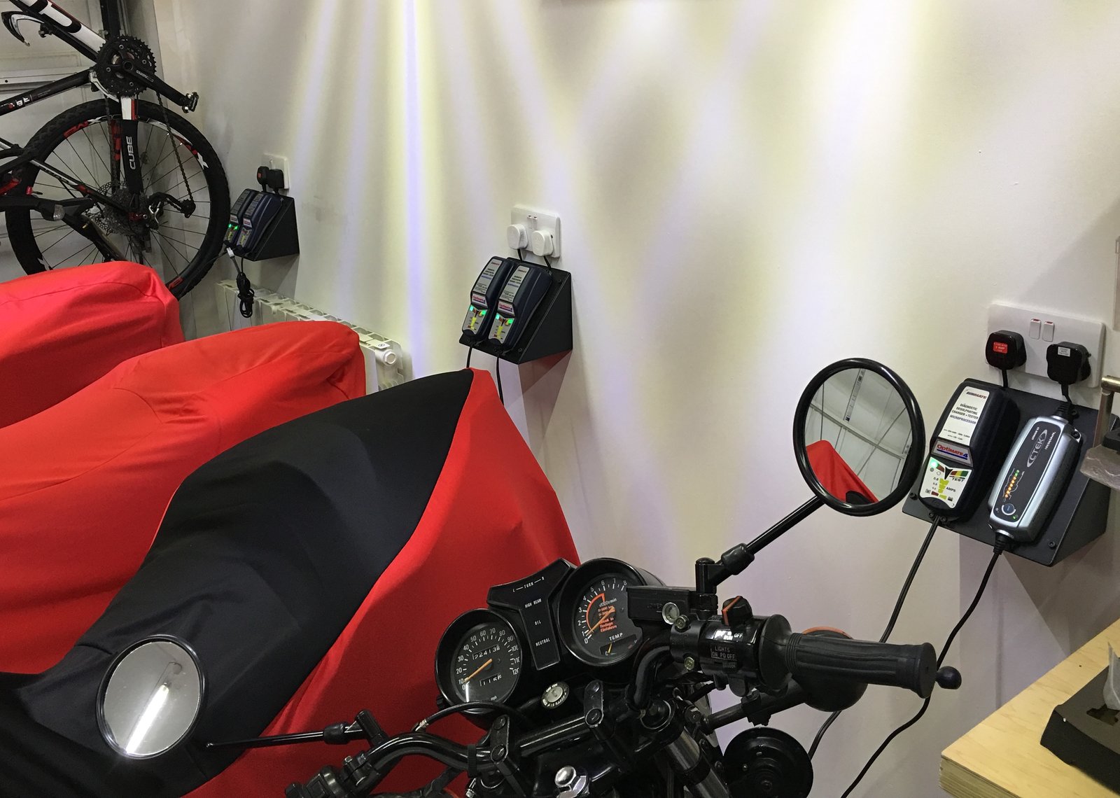

  14. The fly lead is from my C-Tek charger (on the right here) for the one Lithium battery I use on the 1098R.
    The rest of the bikes are on Optimates for regular lead acid batteries and I leave them connected when not using the bikes. In 10 years of using them, I've never had a battery fail. The only battery failure I had was when I left a bike unplugged for a couple of months with an alarm. It flattened the battery which couldn't be recovered.

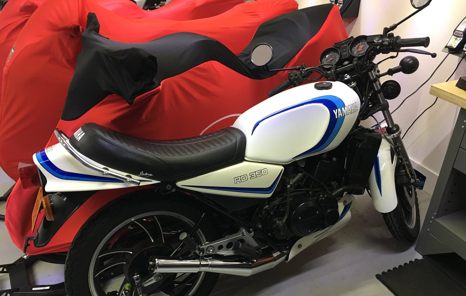

  17. Is that a 400/4 in the near shot :heart::motorcycleduc::broken_heart::broken_heart:
  18. My LC
