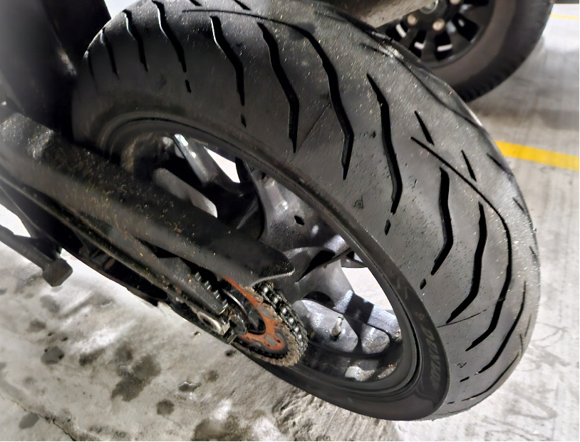

  1. Start of the season - 1st day of Spring on Friday - so time to start spending a few pennies on stuff again. First up - everyone's favourite - tyres.
    I have been very happy with various sets of Metzelers - and just taken off a part worn set of Mezeler Roadtec 01 SE- they have been and are great in all weathers. Change of tyres is really just to try something else, rather than not satisfied with the Roadtec 01 SE.
    Lots of Youtube-ing and reading stuff, and just fancied another go on Dunlops - they have a new tyre - so how bad can it be..
    They were fitted this morning and rode home in the bucketing rain - which was fine.
    First impressions - they are quite a bit more sensitive to inputs than the Roadtec 01 SE. That is for sure - no question about that. When the roads dry out I can see what that means to a big adventure bike, looking forward to it.

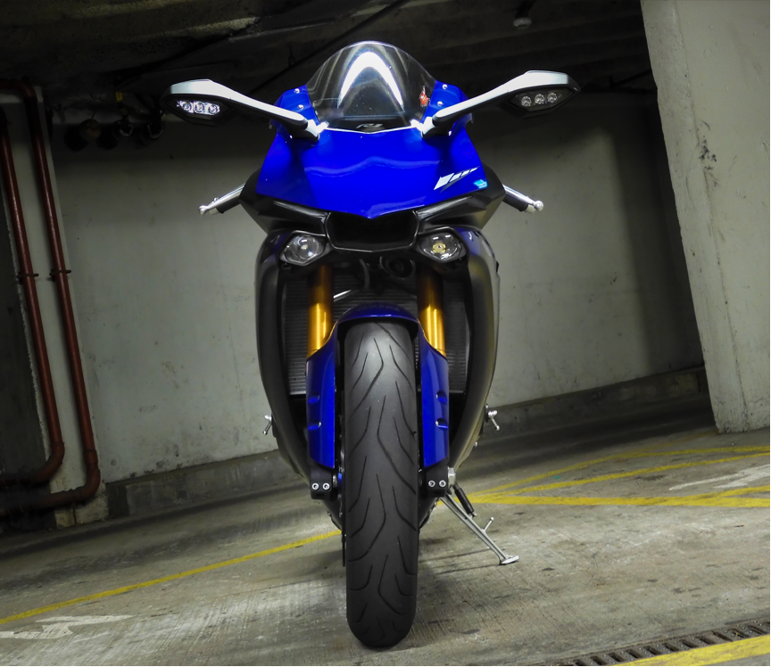

  7. My new R1 with Dunlop Sport - something or others. Sold the stock tyres brand new and rode from the showroom on those Dunlops. Took it to the Isle of Man - lots of rain !!
    What I am trying to say is that I have had good experiences with Dunlops (apart from the ones that sometimes come stock on a new bike).
