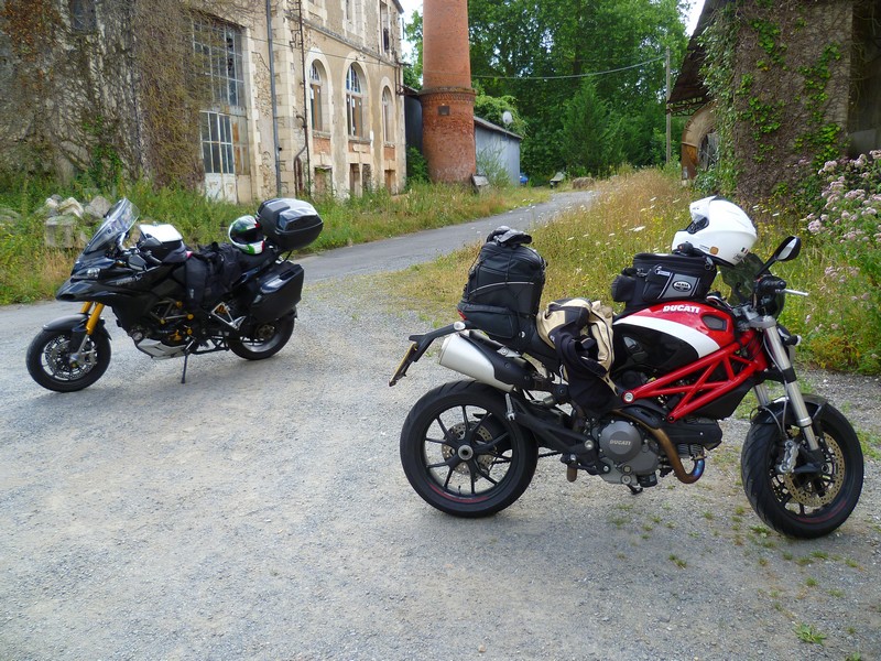

Hi Stu, interestingly same setting here ( me on Multi, missus on Monster 796). We are both running on Roadsmarts 2 now, mainly for long-distance touring. Different feel from Sportsmarts, less feedback but still a lot of grip if you "trust" them, they get to temperature much earlier, very good in the wet. Here are the bikes somewhere in France last year:
