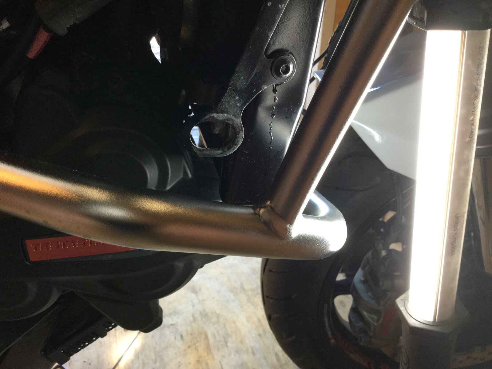

  1. I’ve noticed a small amount of coolant under my bike , 2015 DVT.
    I took the panels off and have found a small leak around the captive nut that holds the side panel bracket, any suggestions on the best type of sealant to use ? image.jpg

    Chat to your dealer and see if they can assist with warranty claim or do i spy some damage in that pic?
  3. Hi, it’s a 2015 DVT, it looks in the pic like a dent but I’ve checked and it must be the angle or a shadow, there is no dent

  5. A re-core will not fix this, this is a mounting lug on the side tank and will need to be re-soldered
  6. Is it leaking from the center, where screw/bolt goes in or around the edge of said fixing?
    If it’s from threaded hole you might be able to get it sealed. Around the edge would likely be easier for rad repair shop.
  7. Thanks for all the replies, it looks as if it’s leaking around the edge of the fixing ! as recommended I’ll have to get it into a repair shop, just a bit wary of removing the radiator as I can’t see much and I’m not sure how difficult it’s going to be

  9. Hi noobie, thanks for the suggestion, although I don’t think PTFE tape will do the job as the leak is around the outside of the captive nut as opposed to coming from the thread, it has made me think a bit, I have applied Fernox paste, which is basically a jointing compound that doesn’t go completely hard but seals leaks, if it doesn’t work I’ll scrape it out and try something else.

  11. A radiator repair shop, on the core, will use epoxy. Now that will be cheap and easily fixable if it starts leaking again. But you will need to make the call, when you remove the bracket, is it a stress fracture? If it is, it will require to be welded/soldered.
