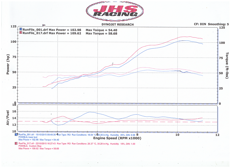

  12. Here is the graph as promised. I collect the bike on Sat morning. The operator says I may have another problem somewhere as every now and then there is a misfire. I'll check this out when the bike is home.
  13. That looks a bit wonky, with the blue oem curve at 16:1 there should be a huge hole in power, but isnt? Ive mapped a few ducatis and this dont look right. Where was afr measured, just at the pipe mixed from both cylinders or each?
    Was bike held at constant rpm while being woted and then released?
    I have ten years experience of this and in case of a true 16:1 afr youd have a huge hole in power, 2p. Lets just hope they didnt richen it to fit.
    Either the red or the blue is incorrect in afr, both cant be right.
    Furthermore run 001 isnt a proper comparison even if it was at water operating temp, it will give more power run 006, especially if you pause after 003 and make another three ;)
    If you really want to find out you have them do another run with the new map first and then do stock, will likely make them look a bit unhappy as they know, hopefully.

  14. this is rear cylinder I think, one line before and one after. Red line is the corrected. I'll talk to the chappie in person on Sat properly.
  15. The blue line is the afr after the exhaust fit but before the dyno, hope that makes sense.
    Before the dyno tune the rear was running 16:1 and the front was 10:1 if I remember correctly and it ran like donkey plop.
  16. If you like to do a proper test have the bike dynoed as is when you get there and then have them zero your map, that will tell you.
    Its always done the other way around, thats what Im saying and this is unfair if you like to know the actual gain as the engine will do more hp if you run it some more.
    To make it clear, all they did was change fuel right? if so where they cross (10200) why isnt power the same? see. Because with the added runs the engine makes more power even untouched.

  17. I agree with TomTom, the results don't make a lot of sense. For a 999 it looks a little low on the power stakes IMO

    Trick no1 is to present run 001 as the poster and then do a few more runs with something else and then you see the result. Trust me I did this too for two sessions until I realised I just fooled myself and decided not to do it again. I was far too interested in making things go in real life. You absolutely must heat sink the engine fully first to see gains, this is having it up to working water temp and then do three pulls, let it paus and then do three more pulls.
    So if the OP likes to know, have the current mapping run one time in the dyno and then just zero the pc out. This will tell a completely different story.
  19. It's a 749 ;)
    If I understood the email correctly, the afr graph shows the rear cylinder only, the power graph shows bhp for both cylinders so maybe that is why it looks strange here.
    The sniffer was placed in to both pipe and each cylinder adjusted separately. James at JHS tunes loads of V Twins inc Dukes so I am sure once I talk to him properly on Sat morning all will be explained.
    For a 749 I thought 109 hp looked pretty good.
