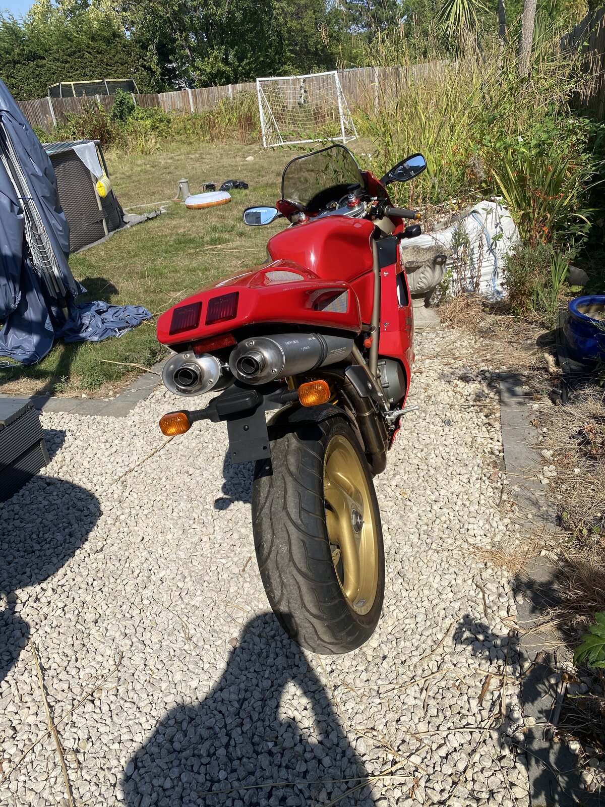

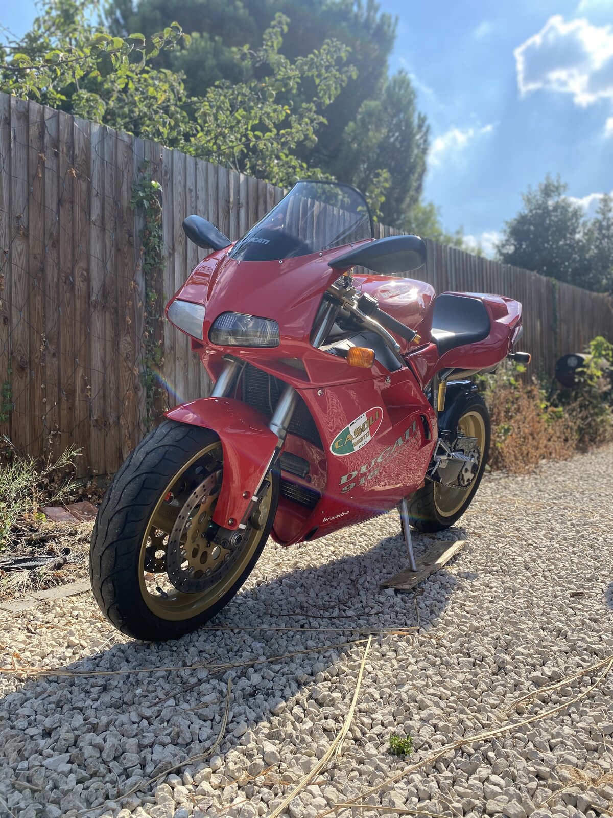

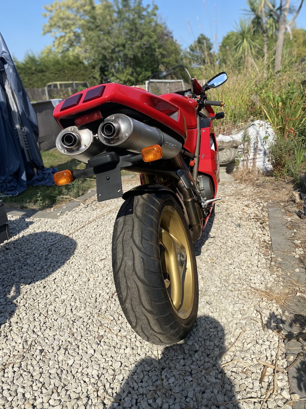

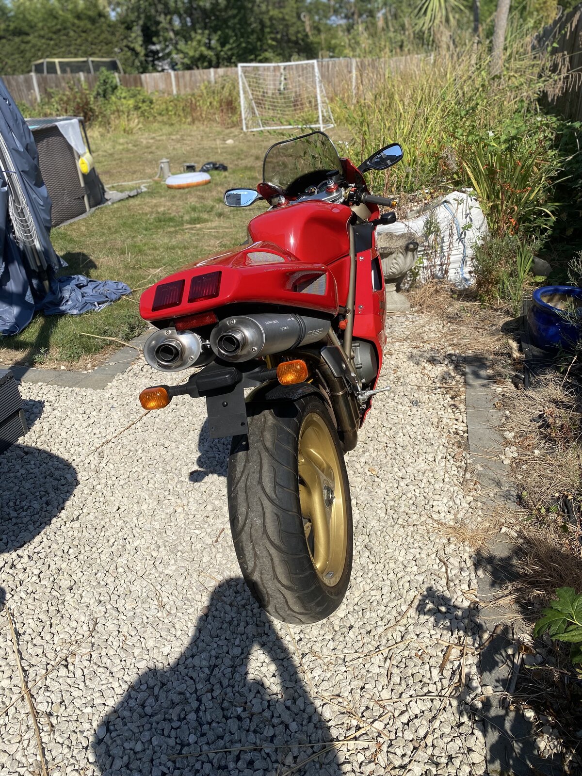

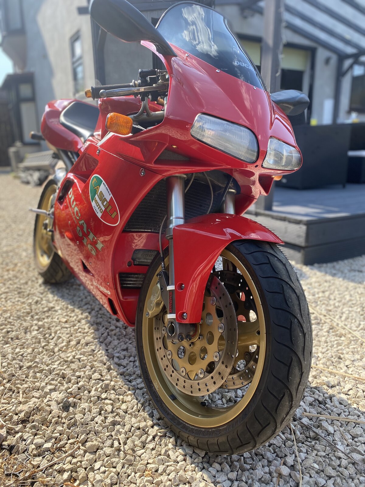

  1. 9F219DB8-6BB1-43B0-A98D-71B90965E207.jpeg 543C8229-9E47-4219-B0C6-09E4C0E81281.jpeg D156A555-4630-4316-B215-40F6EE9EF5D4.jpeg 05195BB1-04EB-4B00-A537-05AEFAA8B2A6.jpeg DB682D2D-FFA5-4F83-BAC1-532897322A24.jpeg 6A57349D-18A8-4EA0-A158-4667BBFDBEE2.jpeg A98B3C2A-8209-43C6-A747-F42795A0C576.jpeg 65F3636C-6DA2-460D-B40A-2BC2FCE7E77B.jpeg CFCBB4C9-28AE-4173-A092-25BEE97D3C11.jpeg I am now the proud owner of a 1994 S 916. An unmolested original early as possible bike has long been on my radar, most I considered were either later bikes or heavily modified.
    This bike, I believe, it s one of the earliest bikes that came to the UK before the fire at the Varese factory. One of the 199 distributed through Europe.
    Have mailed Livio for more info but Italy is shut until the end of August.
    Had a long chat with Richard at Louigi Moto about what to look out for. All of the distinguishing features of early bikes were there.

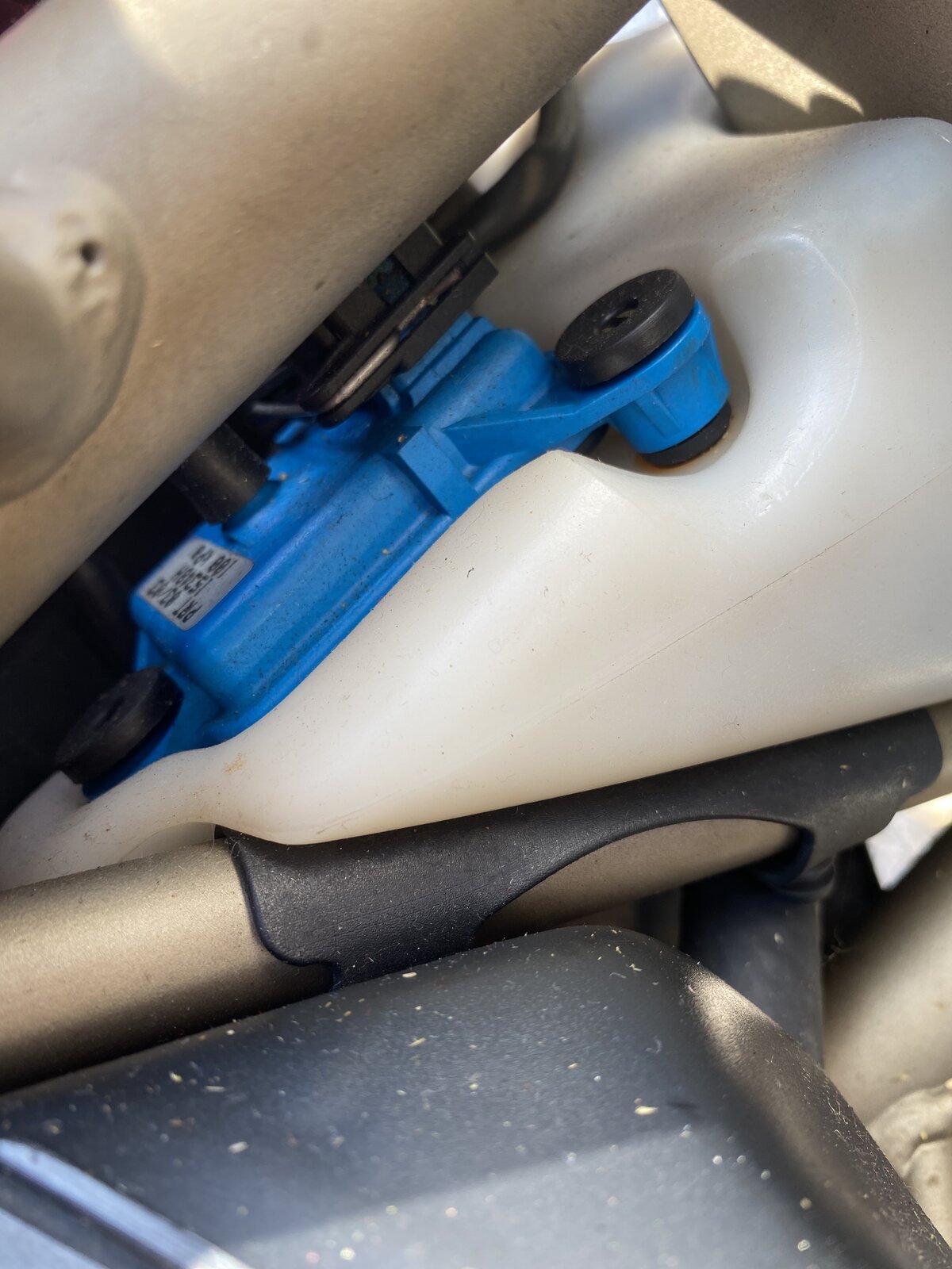

    Blue sensor just below headstock
    Aluminium non adjustable brake leavers

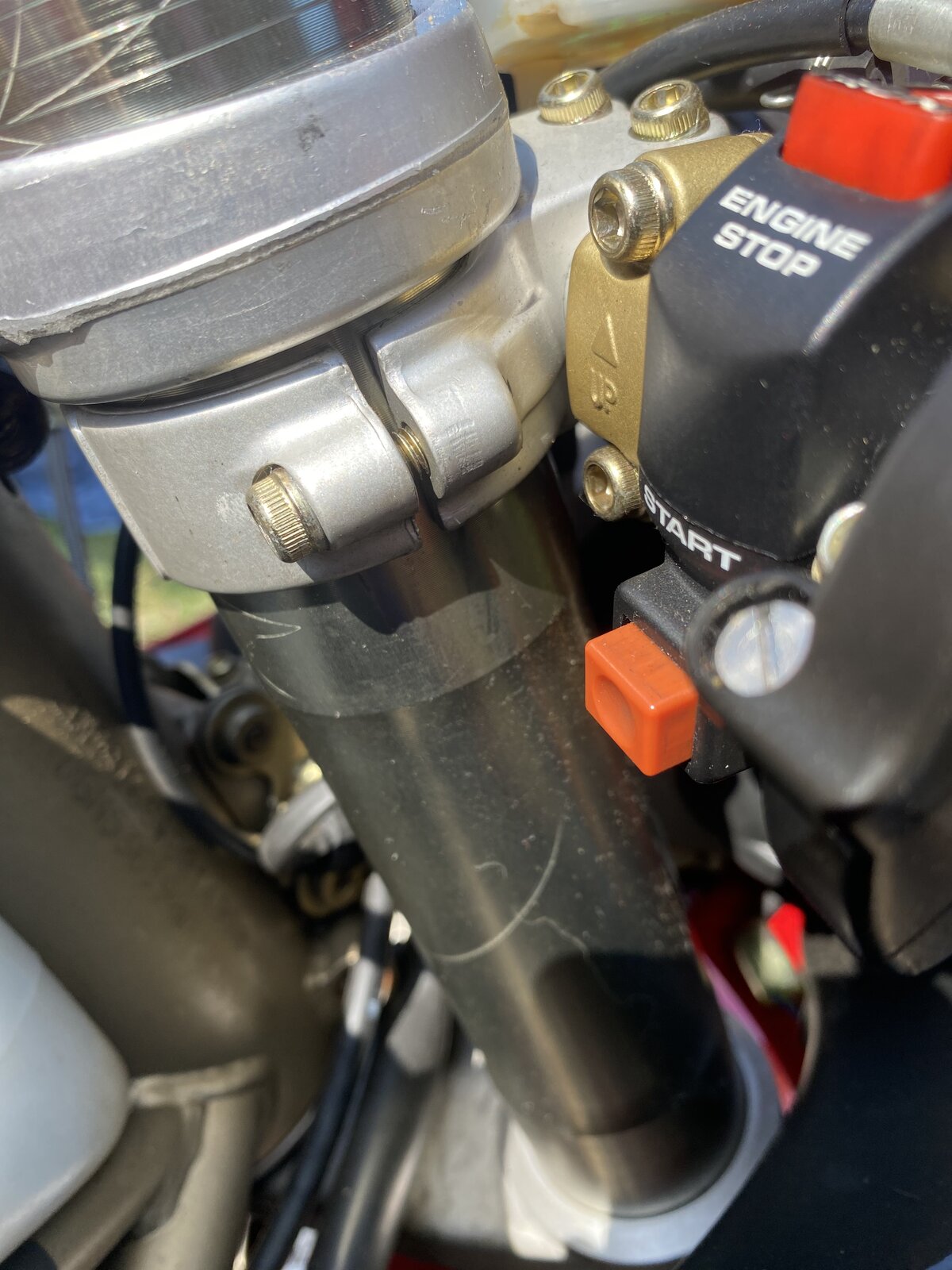

    Clip on clamps with single bolt
    Gold steering damper with chrome rod (later ones were black)
    Front of tank rounded as opposed to the square bit around ignition barrel
    Rear disc held by four M6 hex screws.
    Lower faring fixings.
    P8 computer
    registered August 1994 so on a M plate.
    Anyway all of the above and other features tallied up with Richards advice. Deal was done and collected today.
    It’s a beauty in my eyes, the original vision of Tamburini’s design, pure and elegant.
    Before you all jump at me, yes yes I know, no original screen, bar ends, heel plates, rear hugger, chain guard. All of this will be rectified, have a box of original parts.
    Will be asking lots of questions/advice in coming months. I can’t stop looking at it.

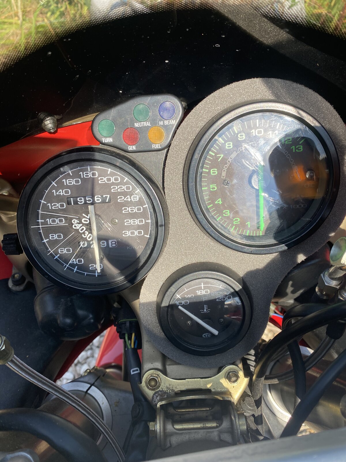

  17. Speedo is not genuine. Doesnt have a crack on the screen. Meh!
