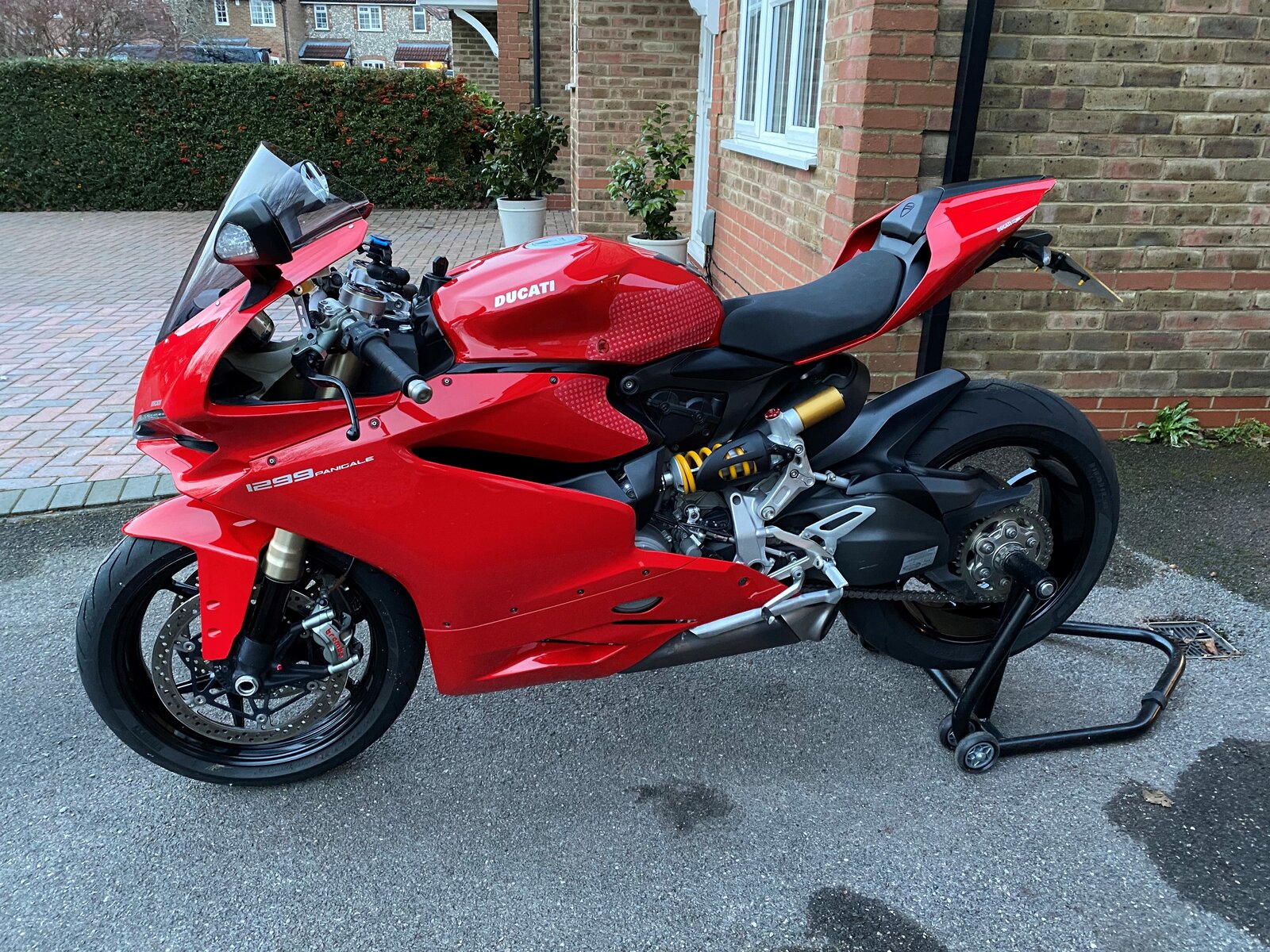

    I love my tank grips though for all riding. Find it helps me so much in terms of stability and keeping weight off the bars. I get what you mean about knee position, but mine came with two pads for each side, one direct onto the tank and the other for the little curved section at the rear top of the fairing. Yes the bike looked better without them, but the clear ones I have blend in well enough for me to make the benefits worth it

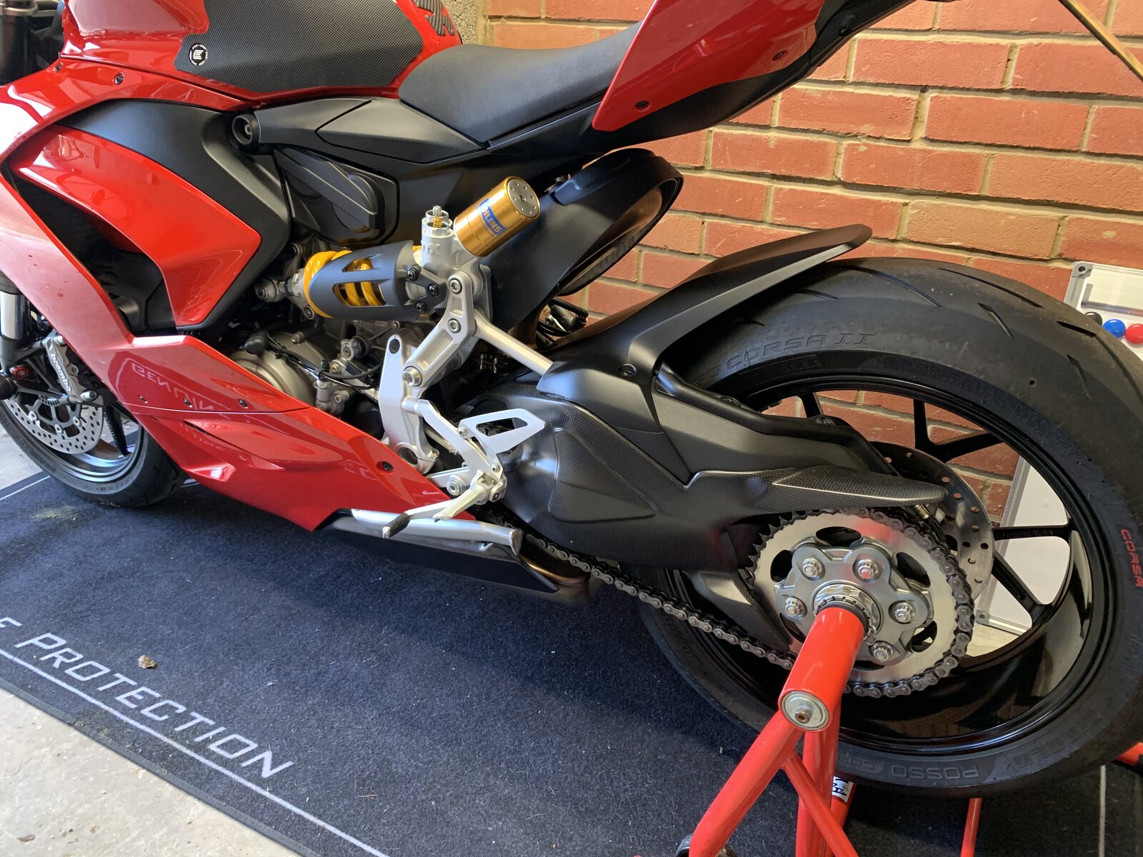

  10. Ohlins TTX? Splashing the cash.
  11. exactly the same issues as mine! especially around the bottom of the tank! I’m sure it’s the heat. Never had any such issues with the Stompgrips. I’d personally go clear anyway. Think it will define the shape of the tank.... just saying :bucktooth:
  12. a mate had it on his 899 that he was trading in and let me have it for £600, I couldn’t not mate....

  15. Ah interesting, hadn't twigged that you are on a V2. I know exactly what you mean about your knees being under the tank a lot of the time and that's where I love having the extra section on the top of the fairing, like a little knee pocket (you can see in the pic). I also went for the dome type as had tried the flatter style R&G ones on my last bike but they didn't offer enough grip to me. Shame the kit doesn't come with a section for that spot under the tank, I wonder if any other brands do
