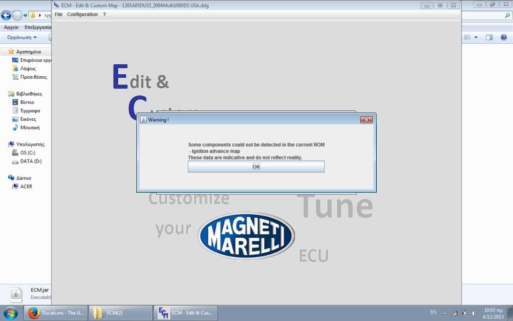

  1. i have problem with ecm
    i can't read fuel offset,ignition map ,fuel trim,idle trim ...etc
    i see only main fuel map.
    can anybody tell me if i am doing anything wrong?
    do i need codes to put in configuration?
    this message pops up in my laptop

  3. That ecu dump should be a HW103 version of the ECU which is quite rare and only seems to be used on the Multistradas.
    It's just missing the pointer (offset) to the Ignition Advance map in the online library.
    You should still be able to see the fuel map, edit it, save it and burn it back to your ECU without any problems.
  4. See if there is a configuration file on line,. Click the OK in your screen capture then look for the button on the left hand side that is a blue sphere with two arrows around it. This will check the server for a definition file. You may have to minimise ECM to see the results box. If that fails PM me the .ddg file using pastelink.me | the easiest way to share files online
  5. I would like to say a huge "Thank you" to Chrisw for his valuable help! He provided answers to all my problems and questions and he created a whole file for me, one that I had been struggling for ages to sort out!
