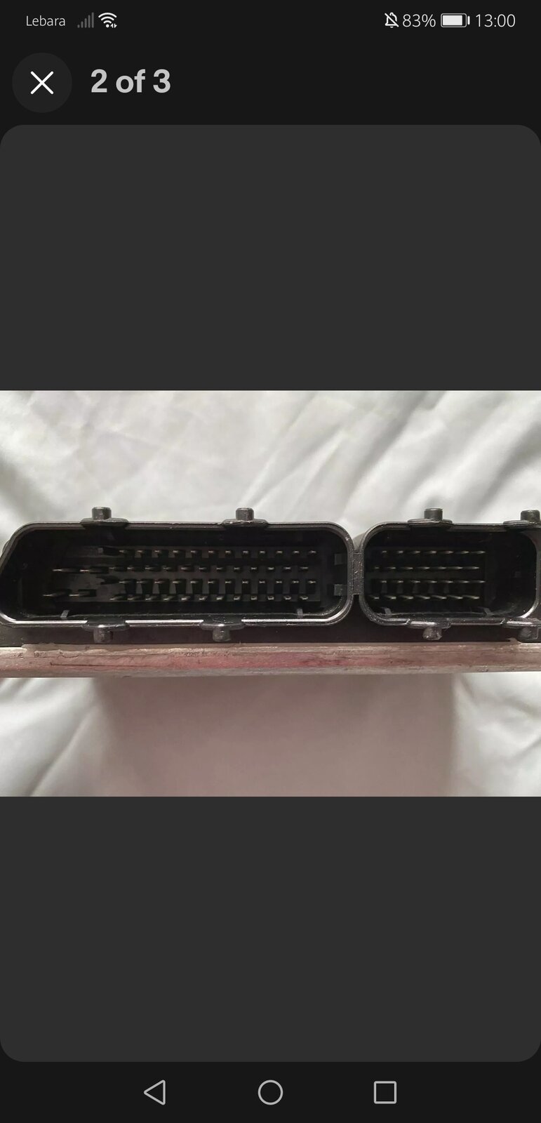

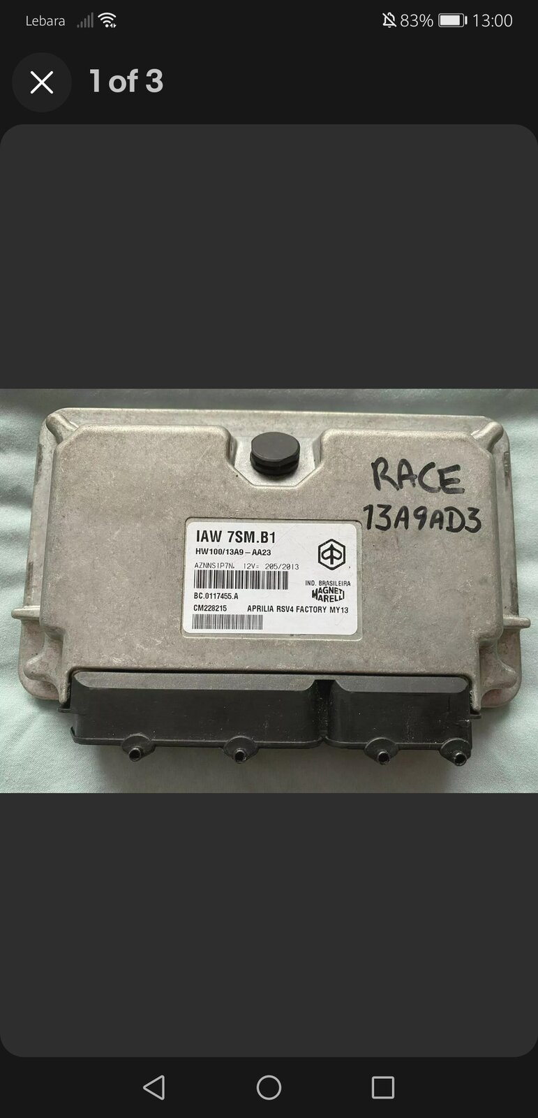

    Here's a photo of it.
    Anyone has experience with it?
    Can someone confirm this information is either wrong or accurate?

  2. If you confirm that it is an IAW7SM there may be a solution. It is not an ECU I have experience of and do not know if it has immo. If it does not then providing you can diagnostically connect to the ECU you can use Guzzidiag IAW7SM reader to dump your original map. Then you can use Guzzidiag IAW7SM writer to flash a second hand ECU. You will need the cables compatible with Guzzidiag.

  3. Hi there.
    How do i know id this is an IAW5SM.?
    What exactly is this code?
    Is there something on the photos that can tell me that?
    Thank you
  4. That’s a typo
    Should be IAW7SM

  6. As I said this is not a Ducati ECU I have worked with.
    Some Googling suggests that the Aprilia ECU may not be suitable due to hardware differences. Ducati use a HW210 and Aprilia a HW100.
    If you can source a second hand Ducati ECU and they do not have immo then it may be possible to use the Guzzidiag software.
    Somewhere like the Digital Kaos forum may give you the answer.

  7. Personally, I’d wait til you have the coils and give them a try. I’ve not come across a faulty 7SM to date, but have replaced dozens of the coil sticks.
  8. As Nelly says, put in the new coils and see if it's OK, you don't know for a fact yet that any damage has occurred to the ECU.

  10. Fingers crossed that you just need coils.
    From what I have found the 7SM ECU should be virgin with the dash controlling immo.
