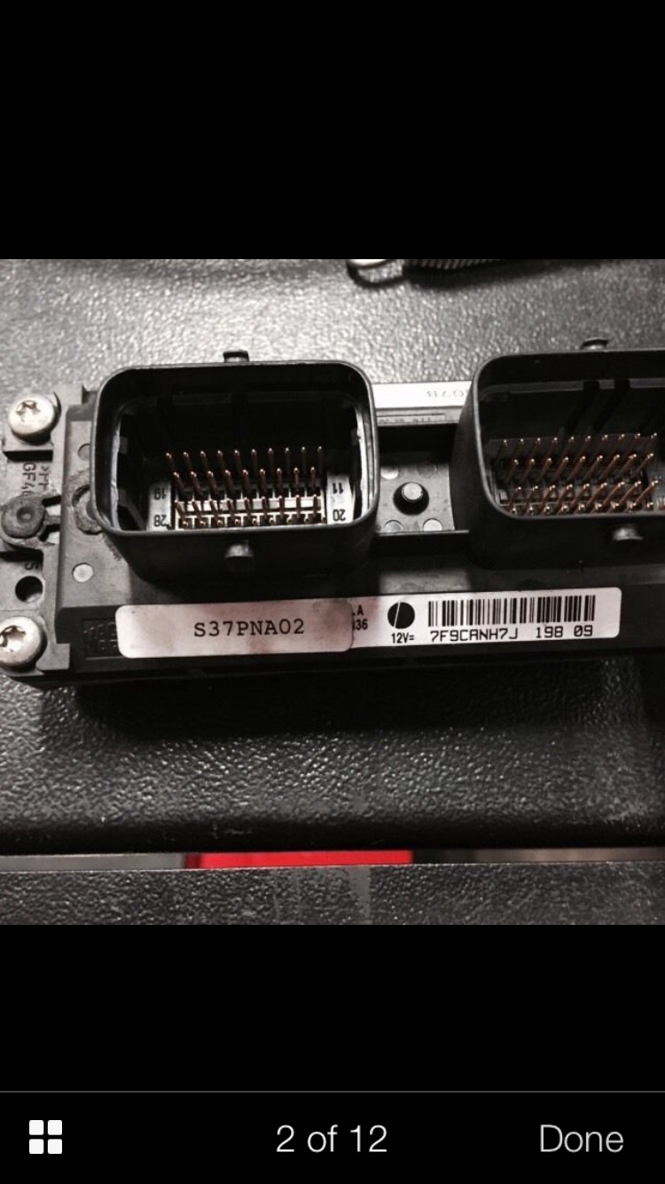

  5. Thanks, here ya go...

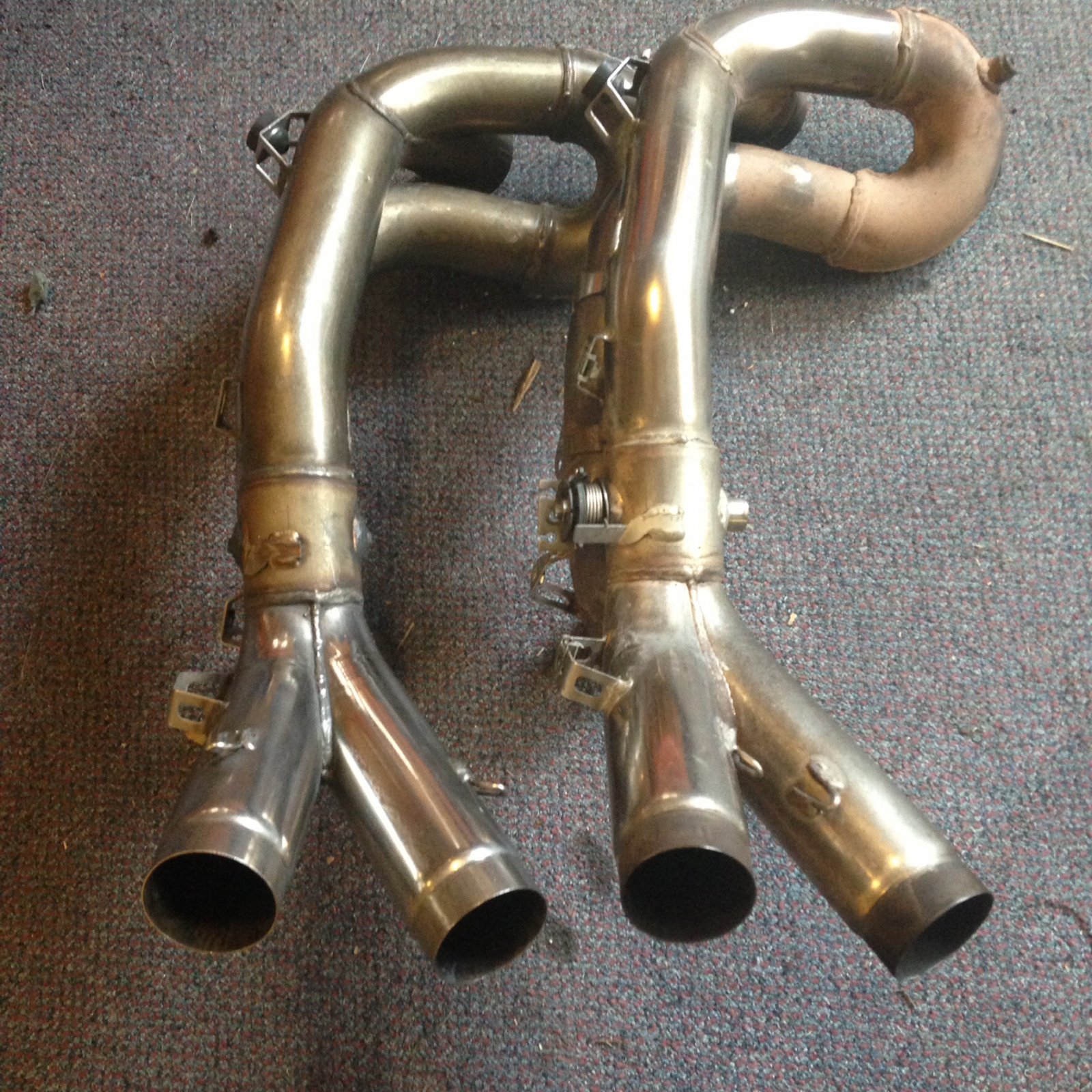

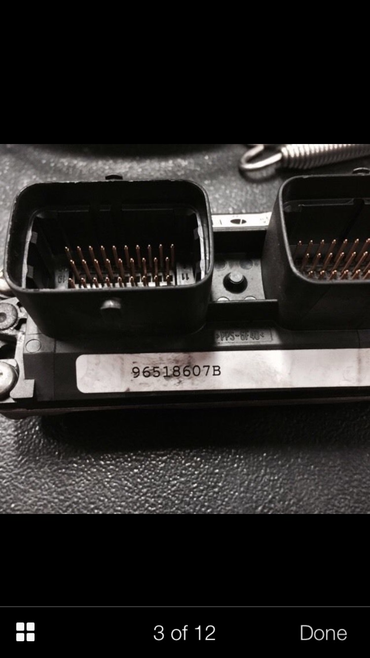

  6. Need the number on the other side... the one that ends in "B" that can be just spied in your picture
  7. This one ?
  8. Hi mate. Make sure the link pipes are non evo as well or you'll have to cut off and re weld the spring lugs on either the link pipes or mid pipes.
  9. Thanks I will check..
  10. That part number is for the 1098 Termi silencer kit.
  11. Is that end of the line then nelly not compatible?
  12. No. The ECU can be reflashed with the correct map. The hardware is the same, it's just software that differs.
  13. Can that be done by sending it to a programmer? Any idea of costs, cans are mint and good price but no returns with any of the gear, is the 1098 ecu saleable?
    Sorry for being a mithering gitt!
  14. I might be mistaken but I think the only difference in the link pipe is the spring lugs to the cans between slash cut and older style not the lugs to the mid section irrespective whether it's an Evo, non-evo or even 1*98 ?!
  15. that's right. i altered the lugs on my midpipes as i had a spare set from a de valved evo. in other words, i could put my original midpipes back on or sell the termis with link pipes, if i ever needed to return it back to standard.
  16. Midpipe lugs are different therefore link pipes as well between the evo and non evo.
