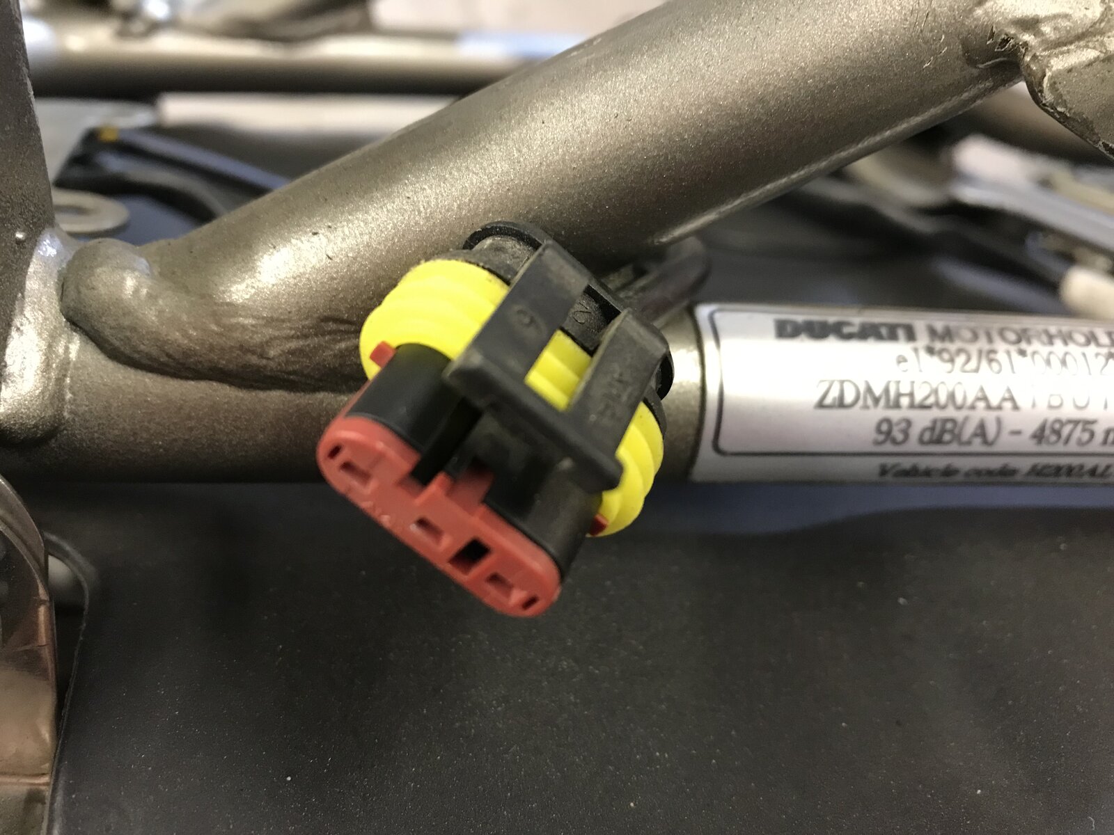

  3. Have you tried earthing the middle wire of the diagnostic plug. It is a 3 way Superseal connector and should have a cap. The earth wire is the middle connector.

  7. Should have two wires into it. The middle is the earth and the outer is the K-Line
  8. Yup that’s it then. I’ll have a poke about with it if it ever stops raining
  9. A Google for the wiring diagram suggests
    Middle wire - black (earth)
    Outer wire - White (K-Line)
