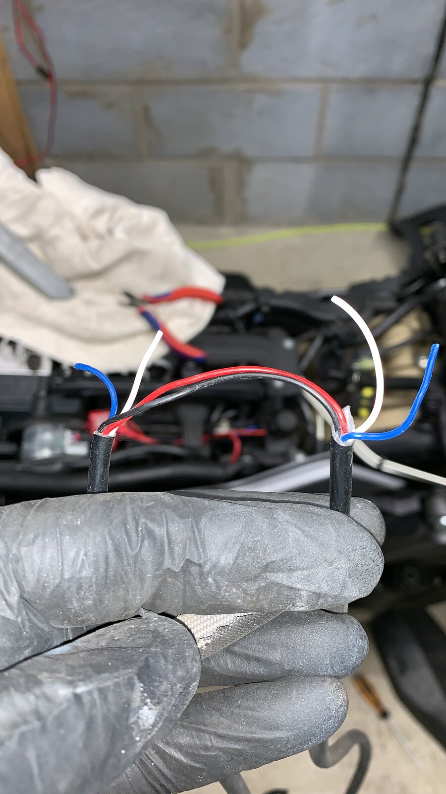

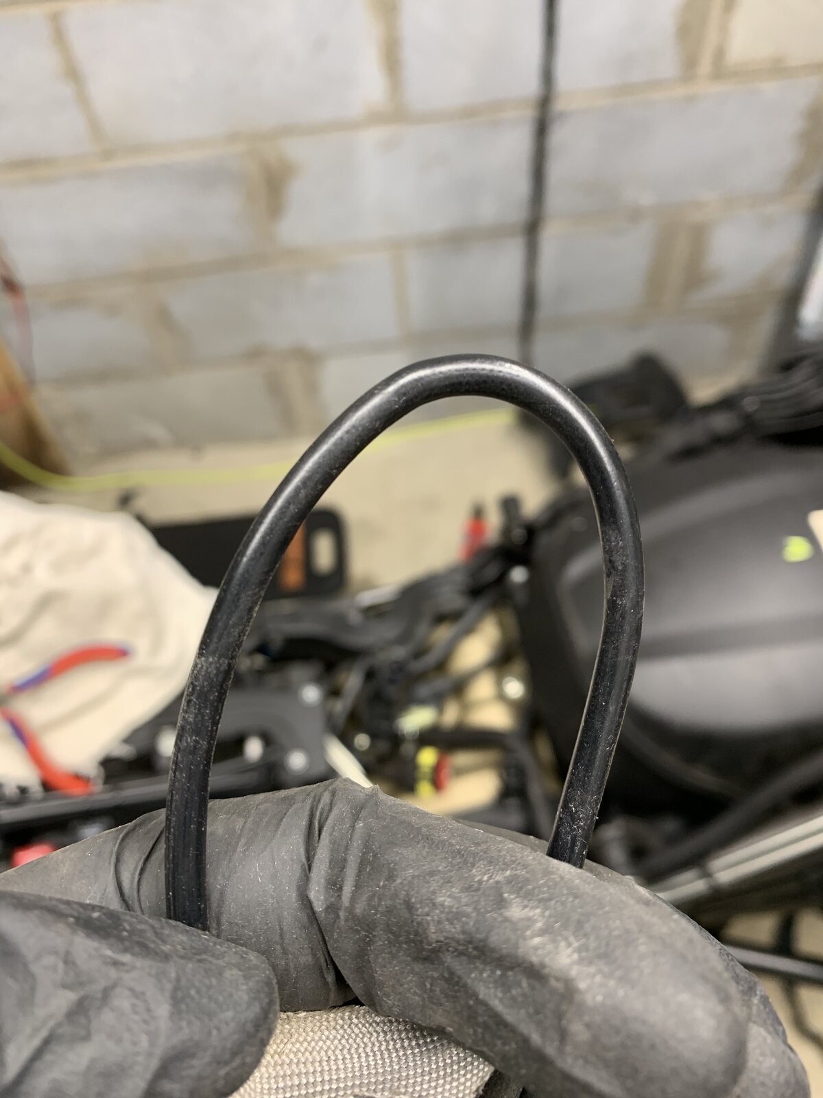

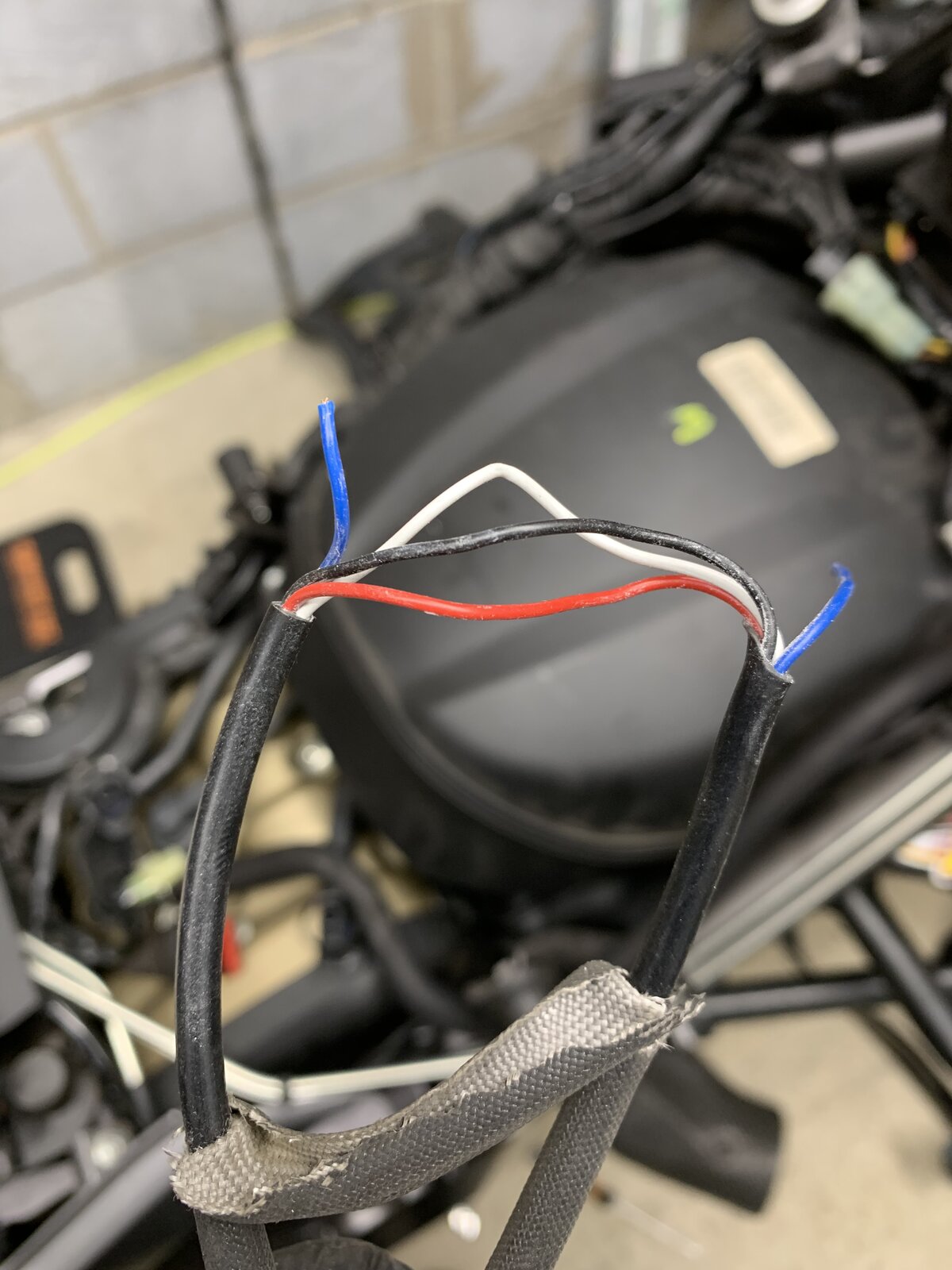

  6. Hey all.
    Finally got round to fixing it all up.
    So for future if it helps anyone using search.
    Rear Accelorometer 502b &/or 502c
    Front Accelorometer 5028 &/or 5029
    Body Accelorometer 502e &/or 502f
    (Thanks to Chris & Ducati MS for confirming these, I also done these tests with melcodiag.)
    Not sure why there is a price difference between the sensors.
    The rear is around £40 & front is around £120. Both near identical except for cable length and rear has a out protection sleeve that does nothing.
    Pics of the damaged sensor attached. Could feel where the issue was with your fingers as there was a very slight bump.

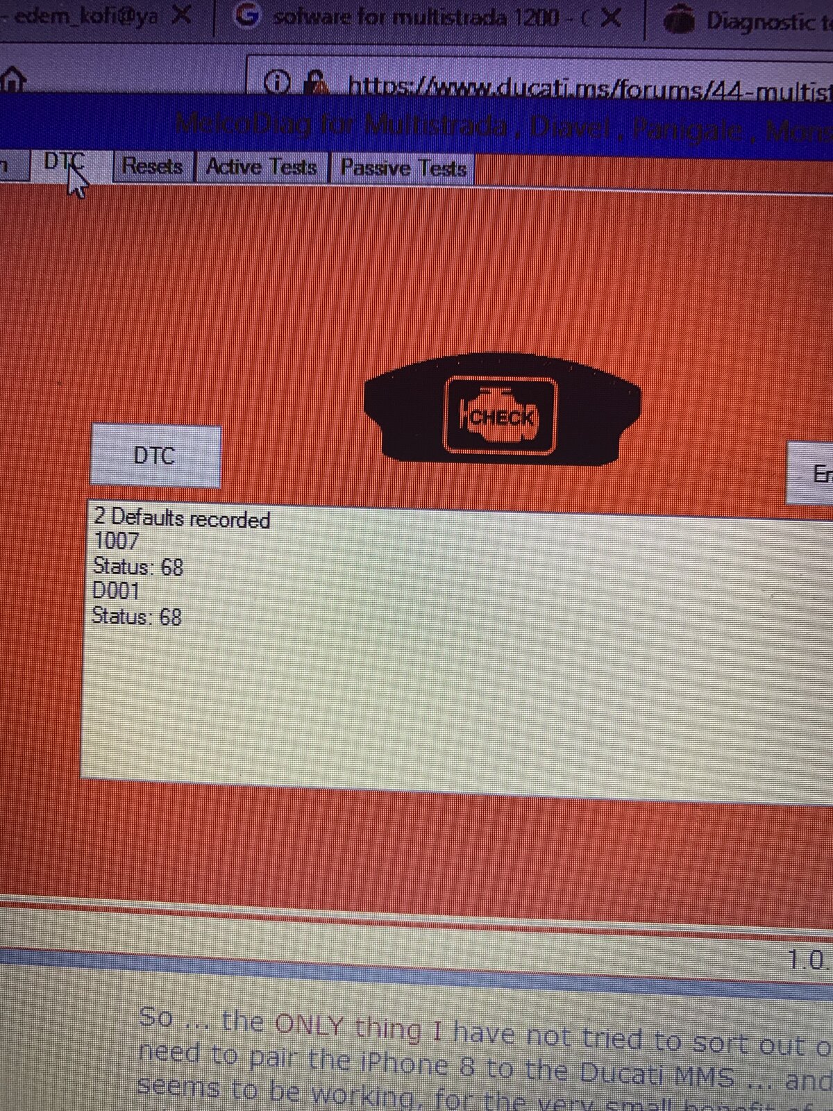

  8. Hi guys, I am new here hope I can get some help. My engine light is constantly on and I get the attached error from Melcodiag, it clears the error but engine light still stays on. Can anyone tell me what those error codes mean ??
  9. Had a look around for you and I cannot find anything either. Would be good to know what these are though once you do figure it out.
    Only other way would be trying all sensors 1by1 to see and then reset codes
  10. I sure would and keep you updated. Cheers
  11. 1007 relates to the EXBV
  12. P1007 Exhaust valve [Calibration - Mechanical stop with valve closed exceed: cable overtravel]
  13. P1007- probably exhaust flap not OK,
    Follow-up error D001 Fuel, injection
