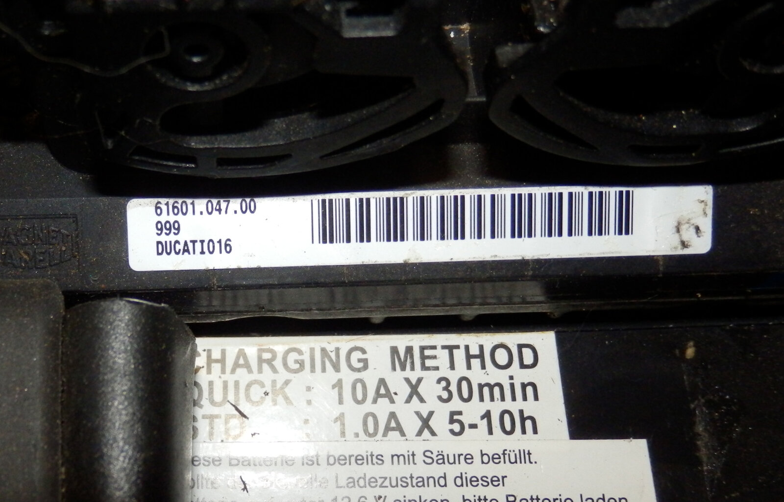

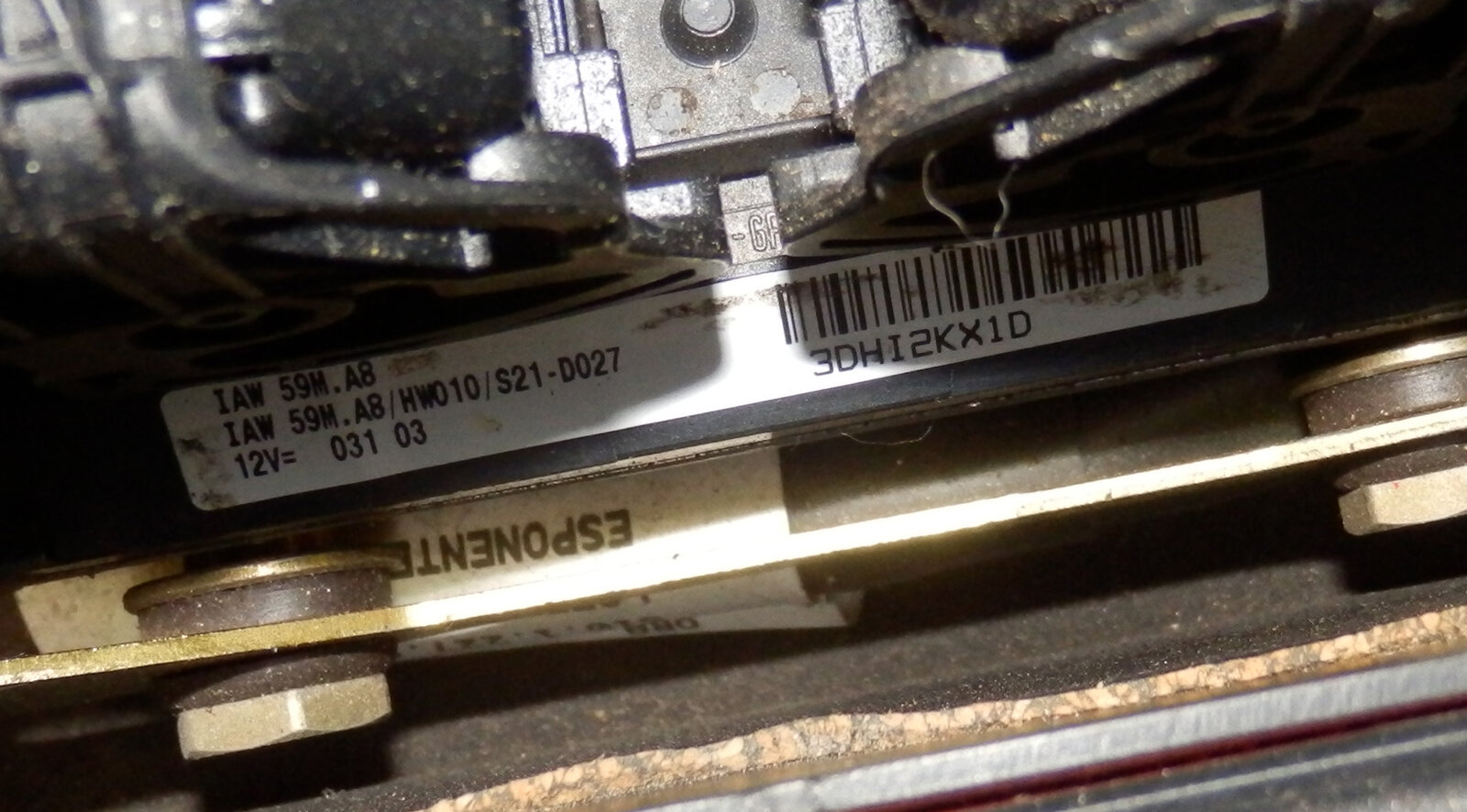

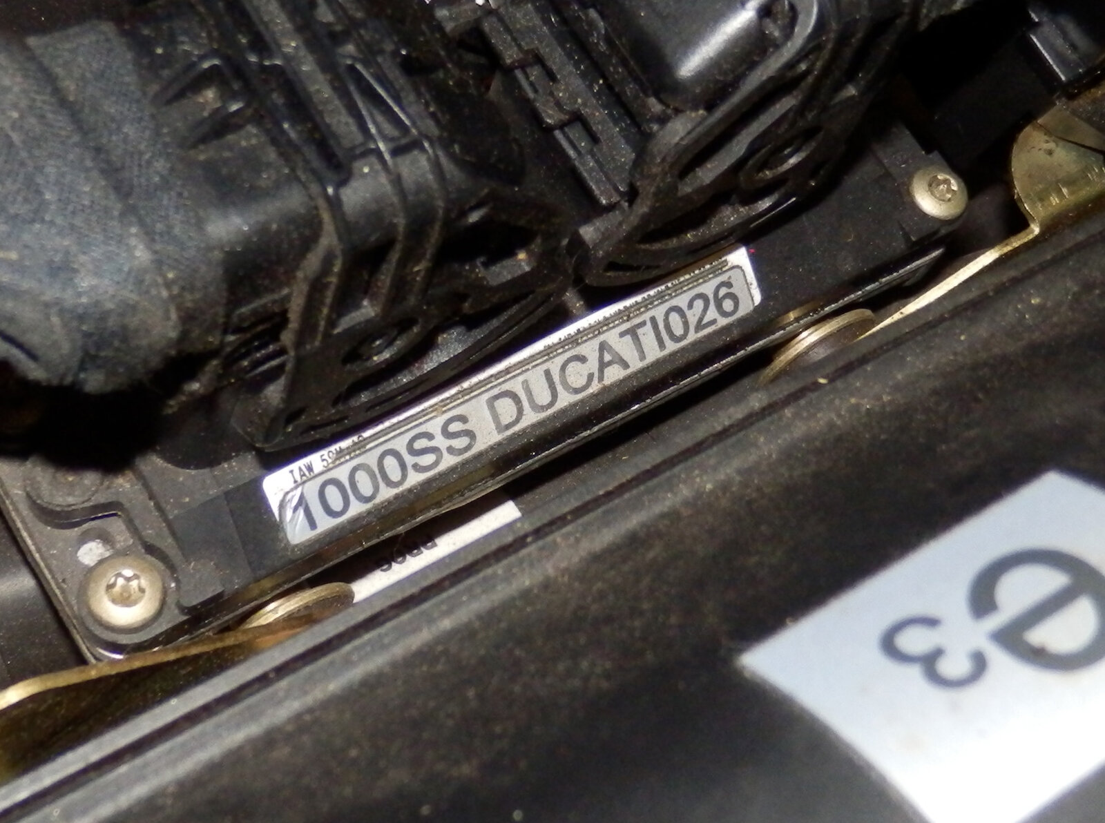

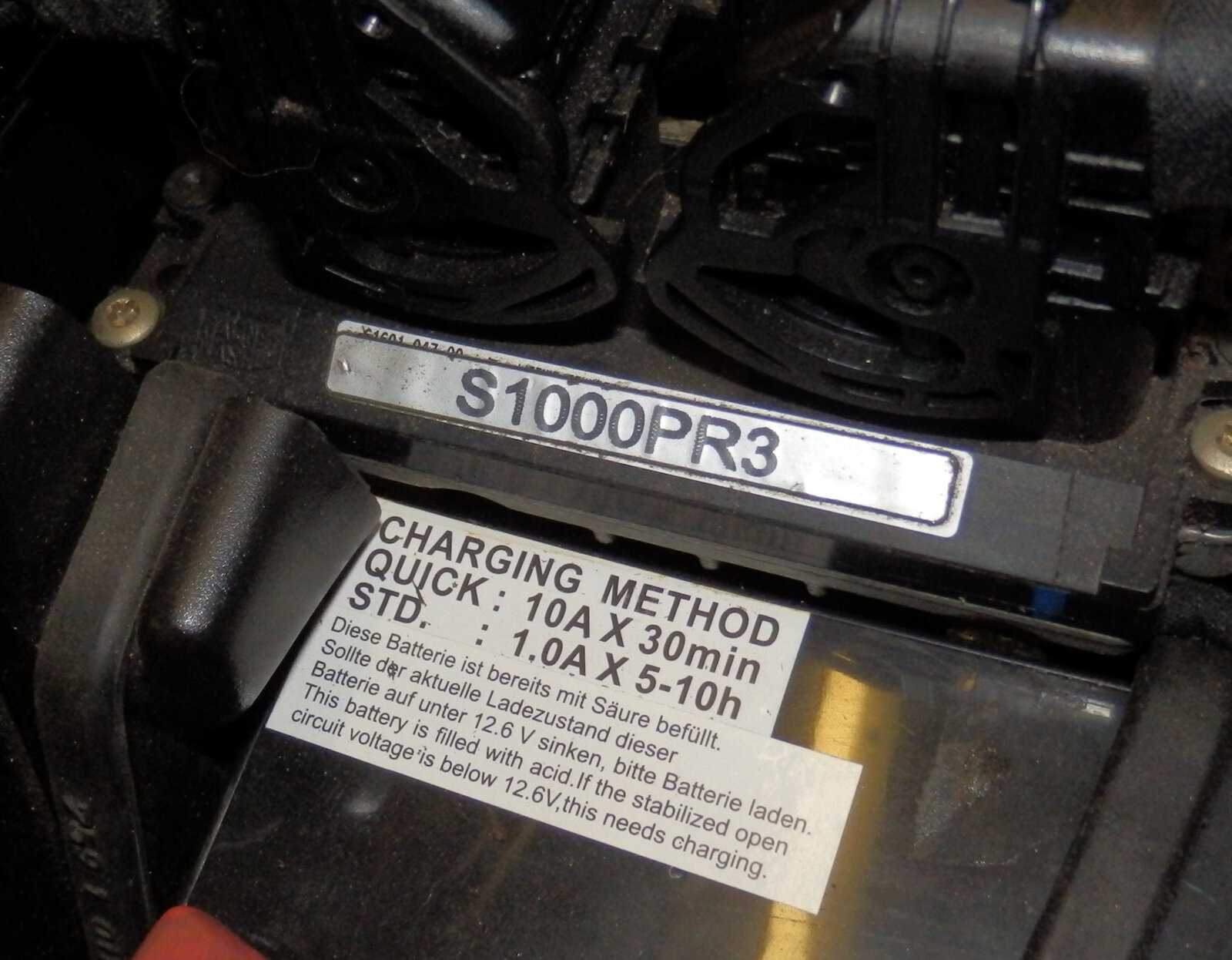

  1. I had a look at the ECU on my newly acquired 2003 1000SS last night as I’m considering some mods and want to investigate the possibility of time on a Dyno or looking for a used DP Flashed one.
    I was surprised to find some quite unprofessional looking labels stuck over the top of the original ones, so peeled them off to see what was underneath.
    On Google I found a couple of other Ducati ECUs with the additional Labels, but nothing that really told me much.
    Has anyone seen this style of over-labels before?

    The additional labels read:
    1000SS DUCATI026
    S1000PR3
    The originals read:
    IAW 59.A8
    IAW 59M.A8/HW010/S21-D027
    12V= 031 03
    3DHI2KX1D
    61601.047.00
    999
    DUCATI016

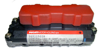

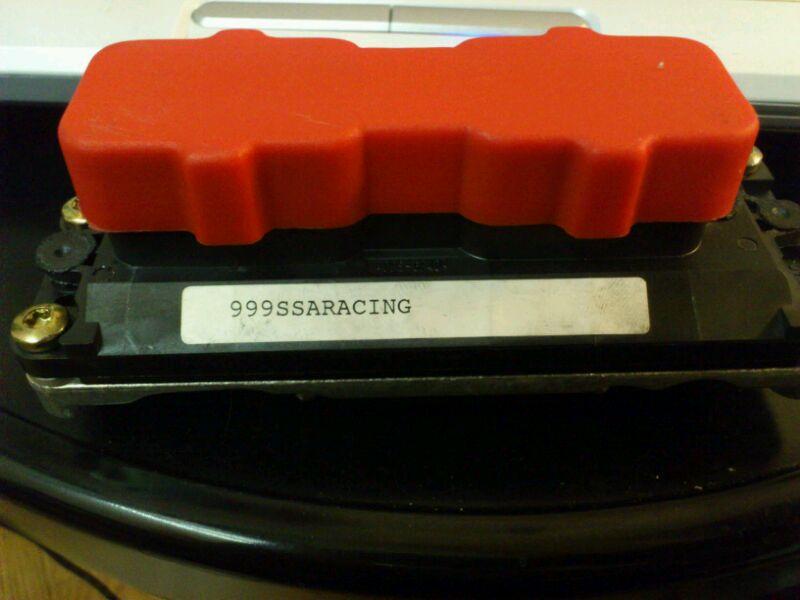

  2. Perfectly normal labelling on the early bikes using the IAW59M ECU. They switched to white paper labels when the IAW5AM was introduced. DP ECUs came with a large red and white label stuck onto them until the IAW5AM was introduced.
