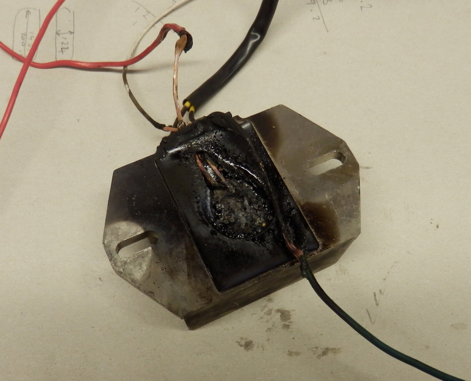

  5. When I brought my M900 it was fitted with an Electrex world reg/rec, which failed quite quickly after I got it back on the road.
    I replaced it with another which caught fire, yes caught fire, whilst out on the road, and if I'd not been able to cut the wire to the battery I'm sure I'd have lost the bike.
    I sent them images, had to chase by phone several times to get a reaction, and their response was that I can't have fitted it properly. I know I did fit it properly and would now never use another of their products.
    I converted to a Mosfet and it was still going strong when I sold the bike.

  6. CATCHING ON FIRE that is so dangerous
