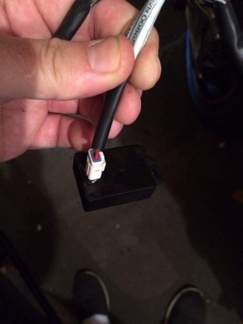

  1. I have taken of the front fairing and have found this component stuck with velcro to the fairing !!!
    Anybody know what it is and where is should be screwed/located ??
    The wires R/Y/Bk come from the loom on the left side (siting on bike) with the GPS wires electrical component.JPG
  2. Yep - that is the fix for the left hand switchgear indicator issue which was a recall on the bikes. Mine was also fixed with Velcro on the left side of the nose cone fairing, beneath the black plastic side cover that spans from behind the headlight and fixing to the plastic shroud covering the key ignition barrel
